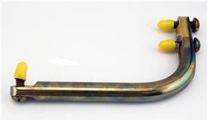

My car came with these mirror brackets that screw on the windshield frame with the one screw in the middle of the windshield sanction . They work very well with no vibration. They are made of solid round stock, and milled out to fit the windshield. Mine are the 6" ones and they don't stick out quite far enough for a touring with the top up.
https://www.snydersantiqueauto.com/Prod ... hByKeyword

I bought my rear view mirrow and bracket from Snyder’s. Works pretty good with minimal vibration. I’ve had lighter mounted mirrows and in my case and probably most others the heavier mounting brackets helps to decrease the vibration.
Of course a T with a balanced engine would have the least vibration but you probably won’t get all the vibration out since it is a T to begin with!

I bought a pair of these mirrors for my 1917 touring. They have the least vibration of others I have tried. A quality unit.

Based on your concern - a shorter mirror arm will result in less apparent movement of the image in the mirror.
