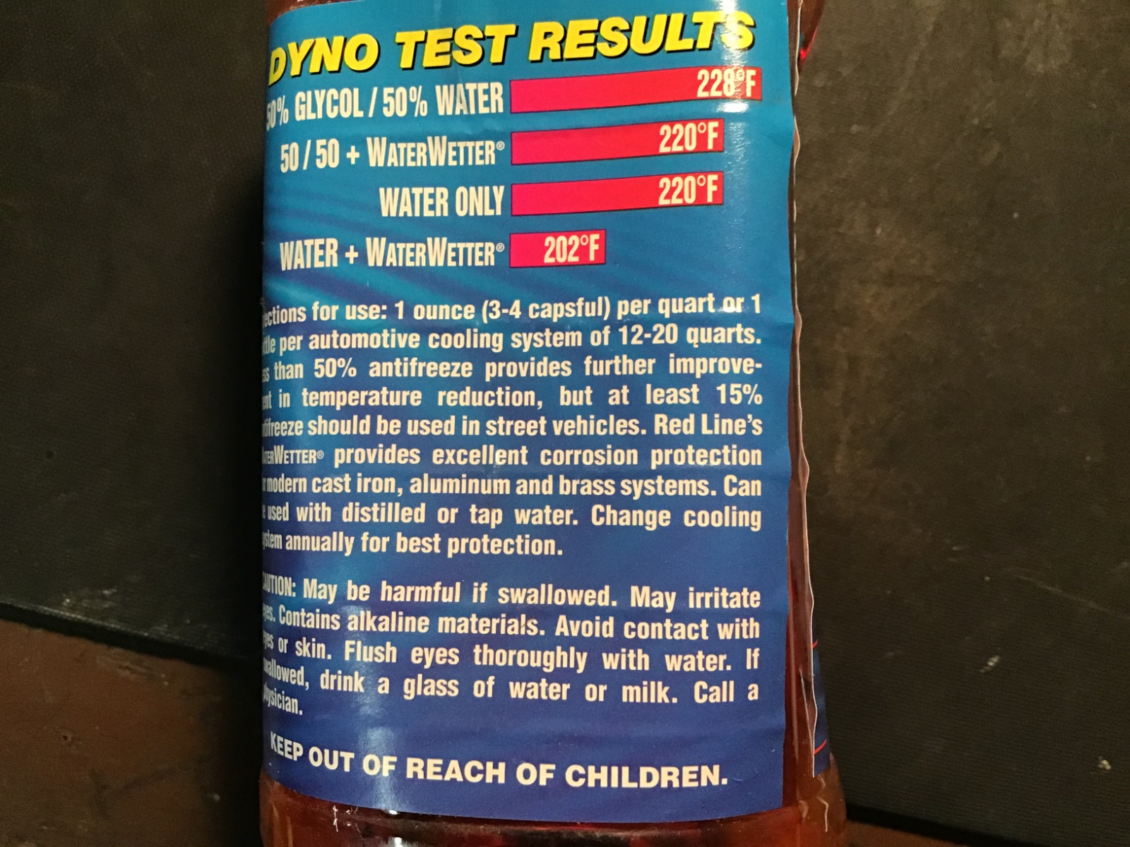

Thanks to all. I picked up some w wetter and will use it till I put antifreze back in.

I used water wetter and water in my Model A for a summer. It did not protect against rust.
The directions say use 15% anti freeze for street use. If I did it again I would add some anti freeze.
