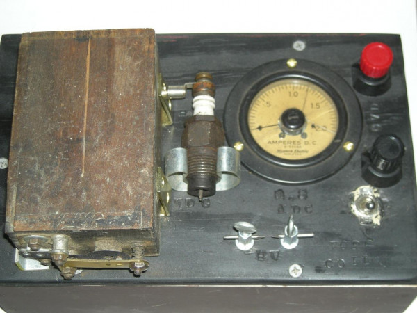

I have watched a number of videos of coil restoration, and they show how the coils are adjusted using several different testing devices. " Back in the day", how did the typical Model T owner keep the coils adjusted without having these devices?

Coils, when dialed in well, typically stay dialed in for quite a while.  One might presume
original owners had easy access to garages with the tools and used them as needed. I set
up my coils 5 years ago and have not messed with them since. I bought a HCCT tester a
couple years ago and have yet to use it.

Took them to a dealer.  They had the HCCT.

Also, it probably only cost them 25 cents to get it done. Ford Universal Service.

Also because of the number of Ford on the road, there were many general repair shops that had the HCCT after they were introduced to the market. The HCCT was not just a Ford shop tool.

Nearly every auto repair shop (Ford and otherwise) had a HCCT.
It was a money maker.
A HCCT cost s little as $40.
It didn't take long to pay for it self.

My father would pop the lid off the coil box with the engine running and adjust them by sound. Ive watched him do this countless times while we were driving his Roadster around town. Now that I have inherited this T I've tried the same thing only to electrocute myself over and over. LOL

Jim_PTC_GA wrote: ↑Sun Aug 30, 2020 6:19 am. . . pop the lid off the coil box with the engine running and adjust them by sound . . .
  I expect this was probably more commonly practiced than paying a mechanic to use testing equipment. "Tuning by ear" was the method handed down to me by my granddad when I got my first T as a kid.
Not saying that it's better, mind. Grandma was fond of saying, "Poor people have poor ways !"

Back in the day, If you bought new FORD coil points and installed them per the book directions with the correct gap, odds would be very good that the coils would work properly.  This would have been the result of FORDS very good quality control on the gap and spring tension of the follower spring on the upper point.

Of course  if you lived a few miles from a dealer what would you do. No HCCT, no electronic device, no telephone or even internet. Just your owners manual.  Maybe a copy of the Ford Owner. Well you buy or make a coil tester and set your coils to draw 2.5 amps.

Adjusting by ear was how it was done before the 1914 style coils came out and seems the practice was carried on later. Unless the 2 nuts were replace by a knurled nut, not an easy task to do.   A friend of mine who is in his 80's keeps wanting to do that, adjust by ear, I keep telling him not too. After he messes with them, he brings them to me to reset on the HCCT (which is his anyway).

Actually, if you really know what you’re doing and know what a correctly set coil sounds like, then you could have very good success getting them real close If you set them by ear while running on magneto at a very low idle.  There is a distinctive “clack” right around the sweet spot on most coils.
