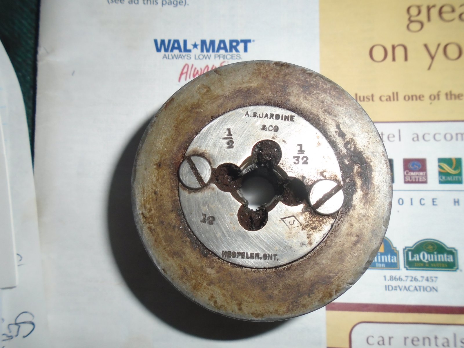

I ran across something I have never encountered. A standard 1/2" course thread bolt is 13 TPI, however today there are special 1/2" taps and dies that are 12 and 14 TPI. I have an old tap and die set that have the special threads 12 and 14 TPI. The set in the day appears to may have been a standard thread they are also 1/32" over size. When chasing threads it would be very easy to damage a 13 TPI bolt with an old 12 TPI die, they go on fairly easily for a short distance. The mismatched threads could be very easily mistaken for just damaged threads that need chasing.

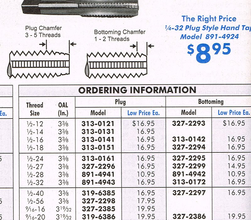

Just for fun, here is a portion of the special taps available from one company. (2009 prices)

I have a set of early dies made by the A.B. Jardine Co. in Hespeler Ontario now Cambridge. The Company was founded in 1870. There is a story in the VINTAGE MACHINERY site about the company and the family Jardine was from Perthshire Scotland. Perhaps he was influenced by Whitworth and therefore designed the 1/2" 12 TPI die. A secondary note all the Jardine Dies are 1/32 over size ie 1/2 +1/32, 9/16 + 1/32 etc. The company failed just after WW2.

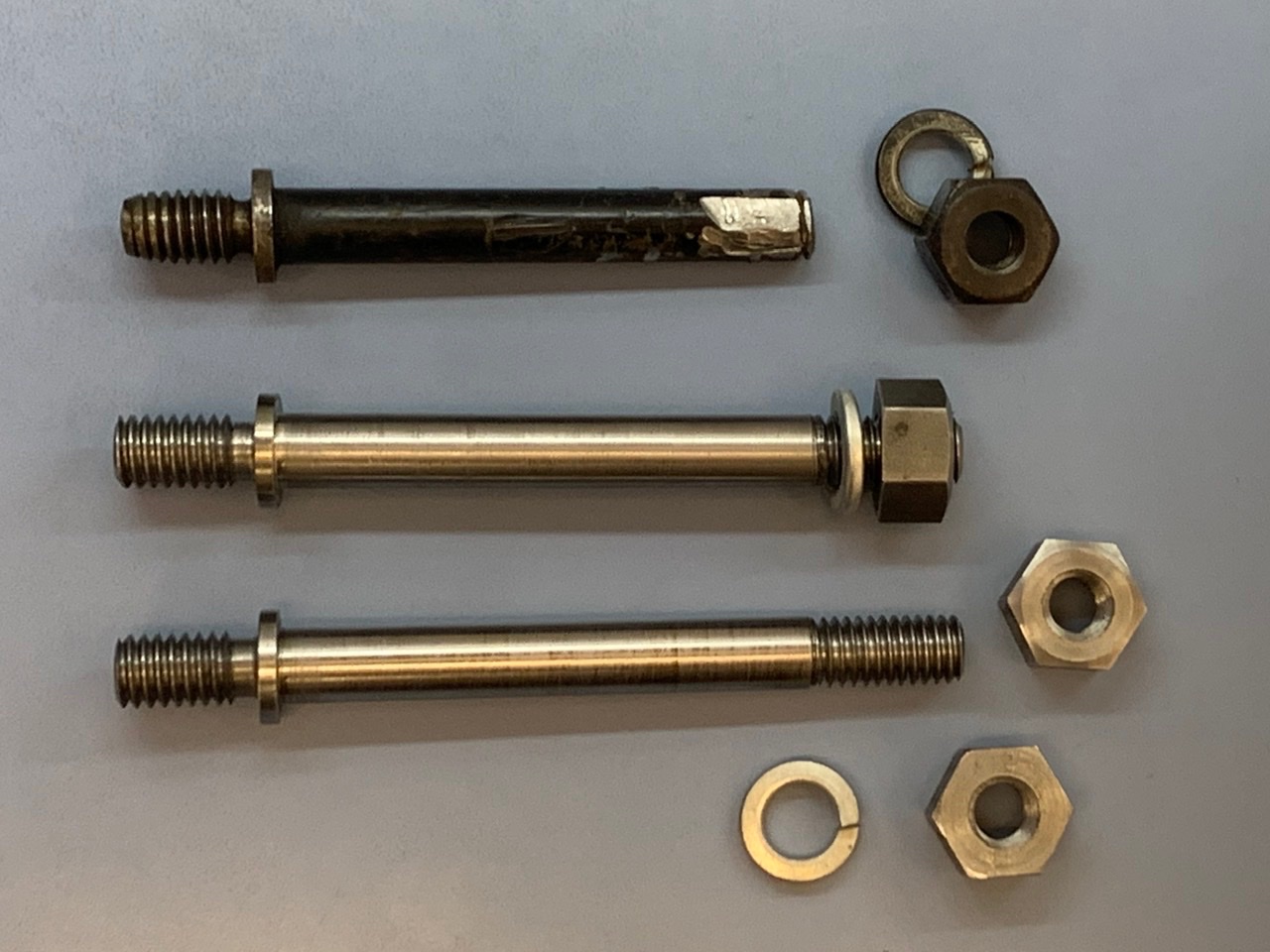

My 1912 KisselKar manifold studs are 1/2-12 thread (both ends).
Broke one earlier this summer and a good friend carved me two new ones and a couple nuts from 4140 steel.
