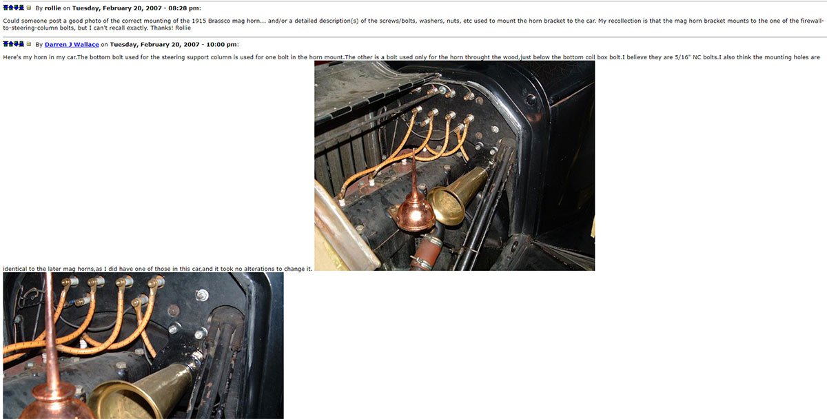

The bracket for the horn is Lang's p/n 6437E.
If you search the "Vehicles For Sale" section of the forum, look for: "Nice Original 1916 Touring", listed by Kim Dobbins, listing date September 15, 2019. One of the photos shows the horn location:

Re: Correct 1915 magneto horn mounting?
If '16 were the same this is it.
http://www.mtfca.com/discus/messages/11 ... 1265019474
That's about the only place you can put it if you don't want it to stick out.
If we assumed
that it was in the same location in 1917 the holes are more clearly noted in this discussion.
http://www.mtfca.com/discus/messages/29/31511.html
