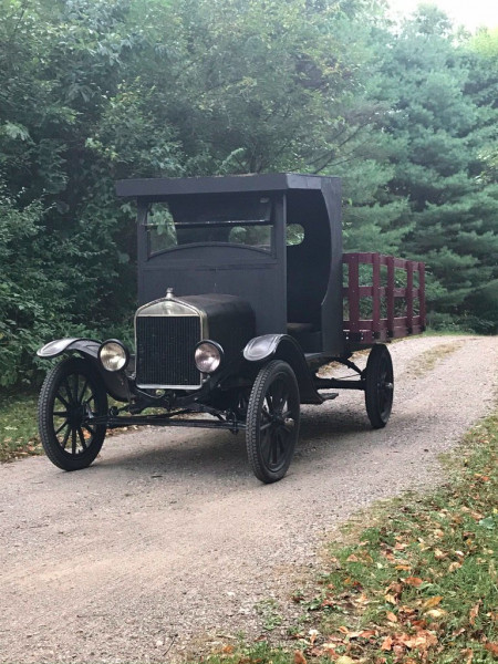

My TT has a True Fire ignition and after running for 15 minutes it starts surging and bucking. I tried adjusting the carb and timing and that didn't help anything. I think it might be running hot as it gurgled for a few minutes after I shut it down.
Not knowing if the radiator was the problem, I fired it back up and checked temps with a non contact thermometer. At idle the top of the radiator was 178 and the bottom was 110, which I think is pretty decent. At a higher engine speed the top was 182 and 174 at the bottom, which I don't think is good. Then again it could be due to a lack of airflow as I was parked.
Thoughts?
Thoughts?

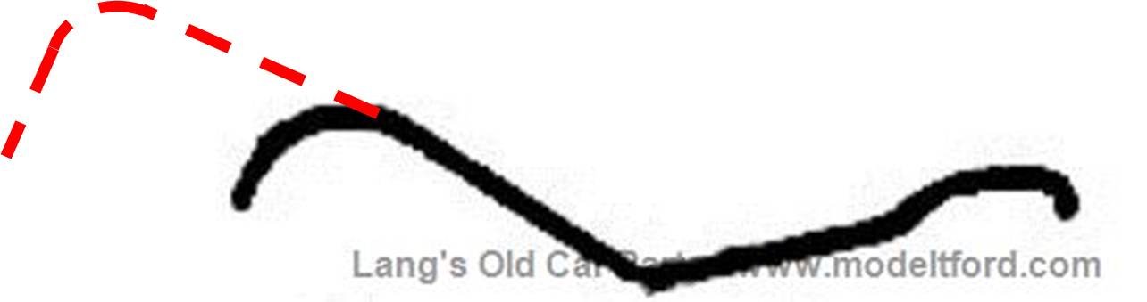

If you determine that the fuel system is OK and you focus attention again on the Truefire, double check the timing using Truefire's recommended procedure, shown in this thread:
http://www.mtfca.com/discus/messages/59 ... 1473784166
I found that I had to substantially lengthen the stock timing rod to get correct timing with the Truefire, to the point where it can touch the timer terminals as you move the timing.
I ended up fabricating a longer-than-stock timing rod out of music wire to get the required length and clearance.
