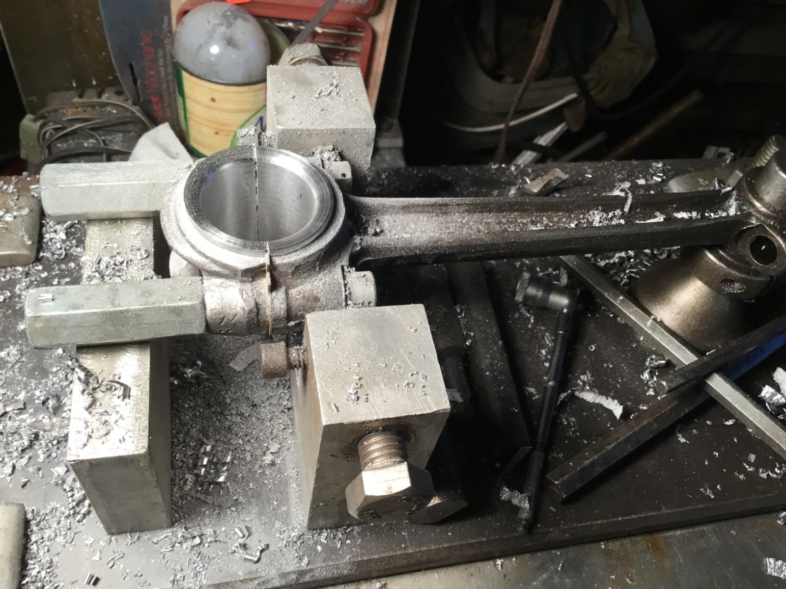

Bought a car with a engine knock. Pulled the inspection pan and sure enough number one was loose. Pulled the head, got the rod out, miked the crank and was very lucky. Pulled the transmission cover and to my surprise, it was not lint in the oil tube it was a piece of RTV. Looking at the inside of the motor someone had used way too black silicon, it squished out on the inside of all the mating surfaces, and some broke lose. Just a heads up, a little go a long way. That stuff will clog things up!
