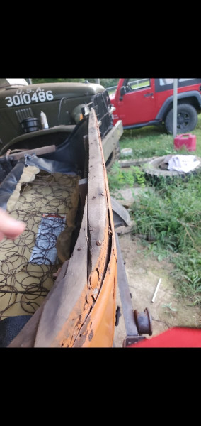

Any place that sells individual pieces of wood? I'm just needing the curved piece of wood that goes around the top back of a 1923 touring. The rest of my wood is fine. Thanks

Check in with Jon Anderson - R.V.'s brother - R.V. follows this Forum.

Go to classicwoodproducts.
They are located in North Carolina and make wood frame kits and pieces for Model T’s. They sell the individual back wood pieces for Tourings also.

Jonathan Anderson will make that for you. Best if you call him, 716-499-7255

Even the catalogs sell just the tack rail. I think you will need the whole unit, not just the curved parts. Just buying the curved parts does not mean they will match up to the rest of it.

That bent rail is best made from steam bent timber to avoid the short grain across a cut curve. You can do it yourself by laminating strips of plywood using the body as your former.
