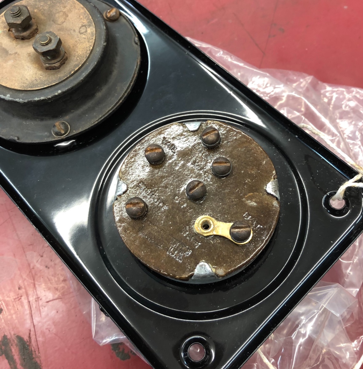

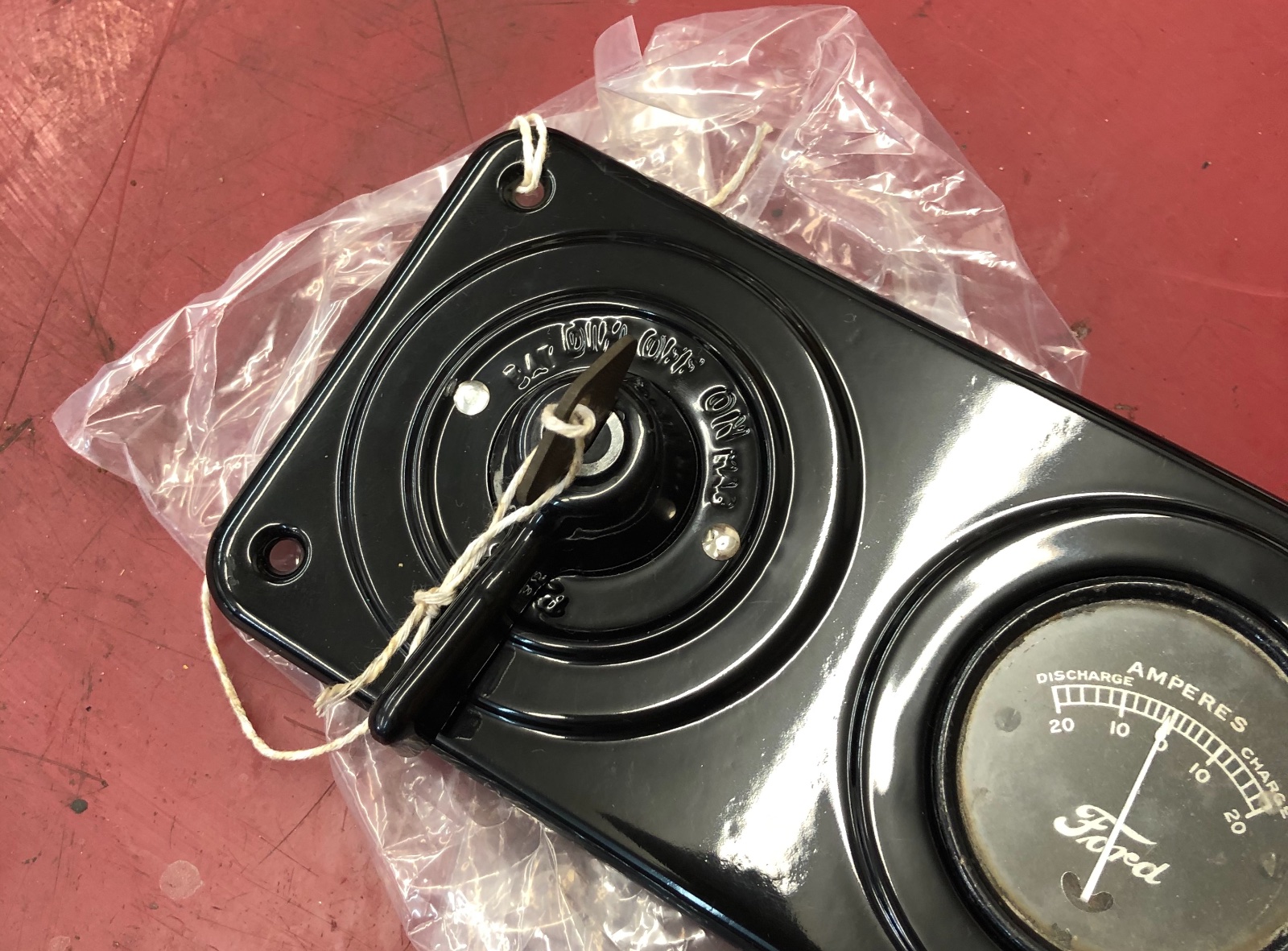

You'll receive a nice rebuild if you provide a decent core, with key helps too, write a note on what you want too in the box with it, also if you want ammeter too, provide that for also.
Just got this one returned, powder coated plate, rebuilt switch with new center tumbler, added my own ammeter. The letting is left unpainted, but easy to add over the powder coat would think. White enamel paint with a superfine bush, then wipe off excess around letter with simple paint thinner, (not lacquer thinner), as paint thinner won't typically harm the powdercoat.
Ben's phone # is 77 ZERO-938-33 SEVEN 6

That is a very good professional job. I'll be calling Ben, Thanks

A fine tip white paint marker from the craft store works great for the letters. Since they are stamped into the metal, you don't even have to be an artist to do a great job.

Thank you for that suggetion on painting the letters white Jahn will give it a try.
