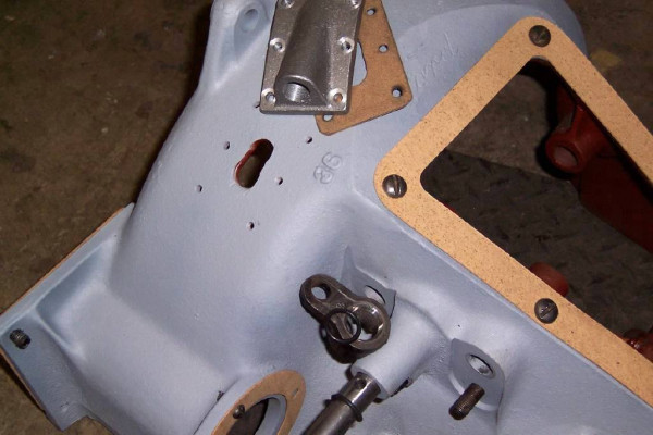

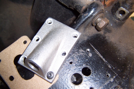

Posts: 4090
Re: cutting cast hogs head for aux oil line
Post by DanTreace » Wed Sep 16, 2020 9:13 pm
Installed mine with just drill bit. Made two holes spaced and then filed away the center portion.
Think now some new kits come with a template, and fancy defector plate too. My install was the simple one, and to get the correct spot over the magnets to get the best toss of oil thrown up, did it with the hogshead on the motor.
Knowing that only a couple of holes and stuffed rags to catch the most of the shavings. (The entire engine and trans was going to be disassembled and rebuilt so no worries)
That helped place the fitting in the best spot. Drilled and tapped holes for the mounting screws and made a gasket too. Socket head machine screws hold the fitting in place, didn't want any nuts or bolts or stuff inside the hogshead that could get loose!
Locating position and drilling main center holes and the mounting screw holes.
100_0441 (550x367).jpg (113.6 KiB) Viewed 1835 times
Finished up with hogshead off during restoration.
