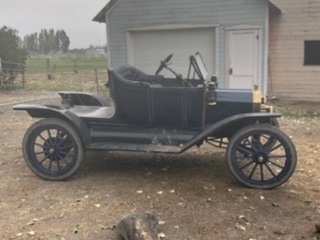

I love my Lizzie !! But ever since she adopted me (four years come Halloween) I've been nonplussed by the essential uselessness of that cute little turtle deck. Got her ready for a pickup box. One thing has me puzzling. How to mount the tail-light so it won't interfere with the tailgate, and not be mounted so low as to be vulnerable to "stuff" churned up by the wheels ?!? Suggestions most welcome ! :D

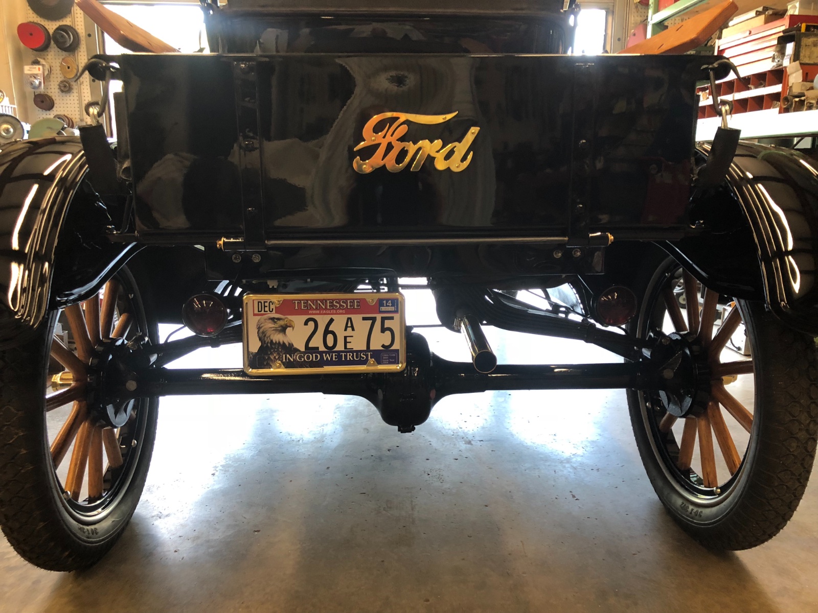

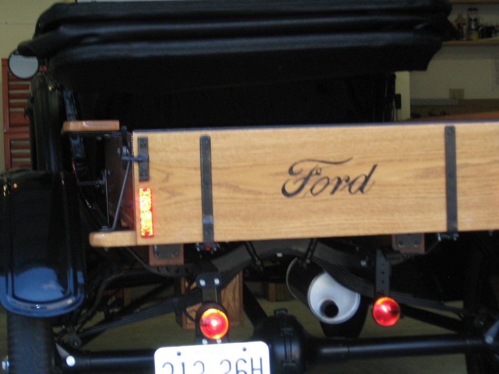

Mine are mounted on brackets extending down from the rear of the frame. I also attached a couple of small reflectors on the tailgate.

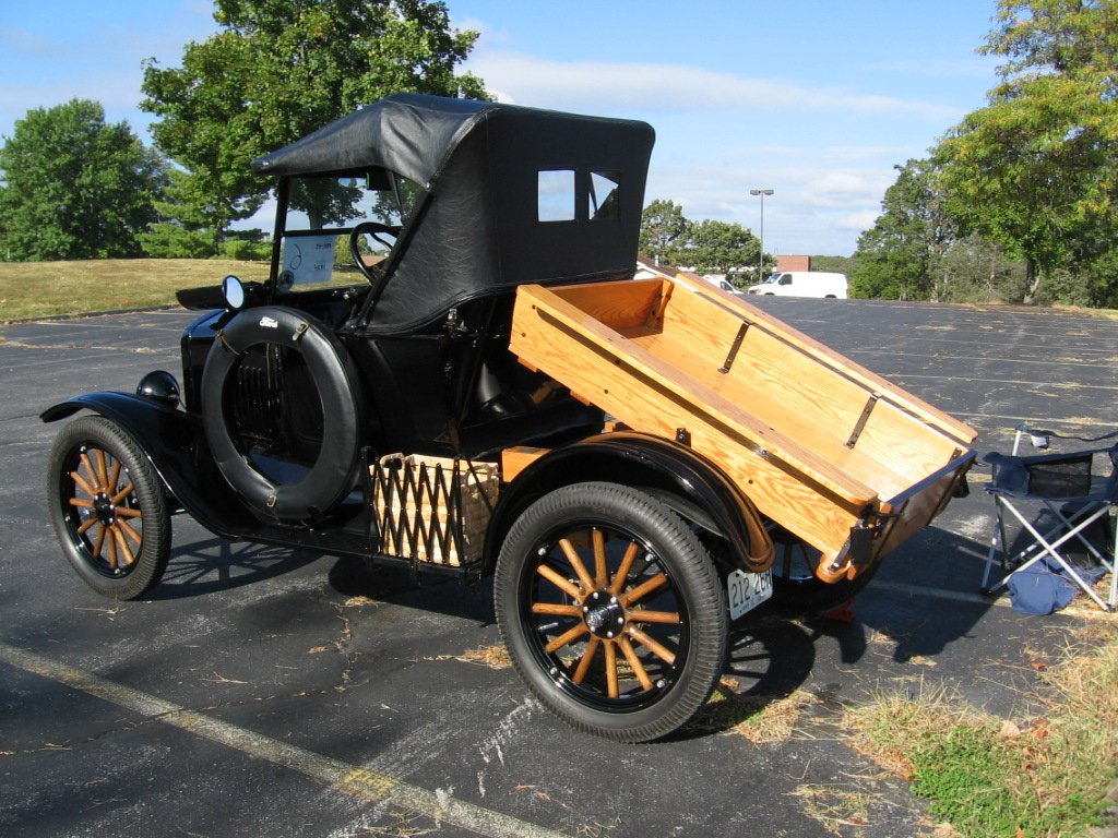

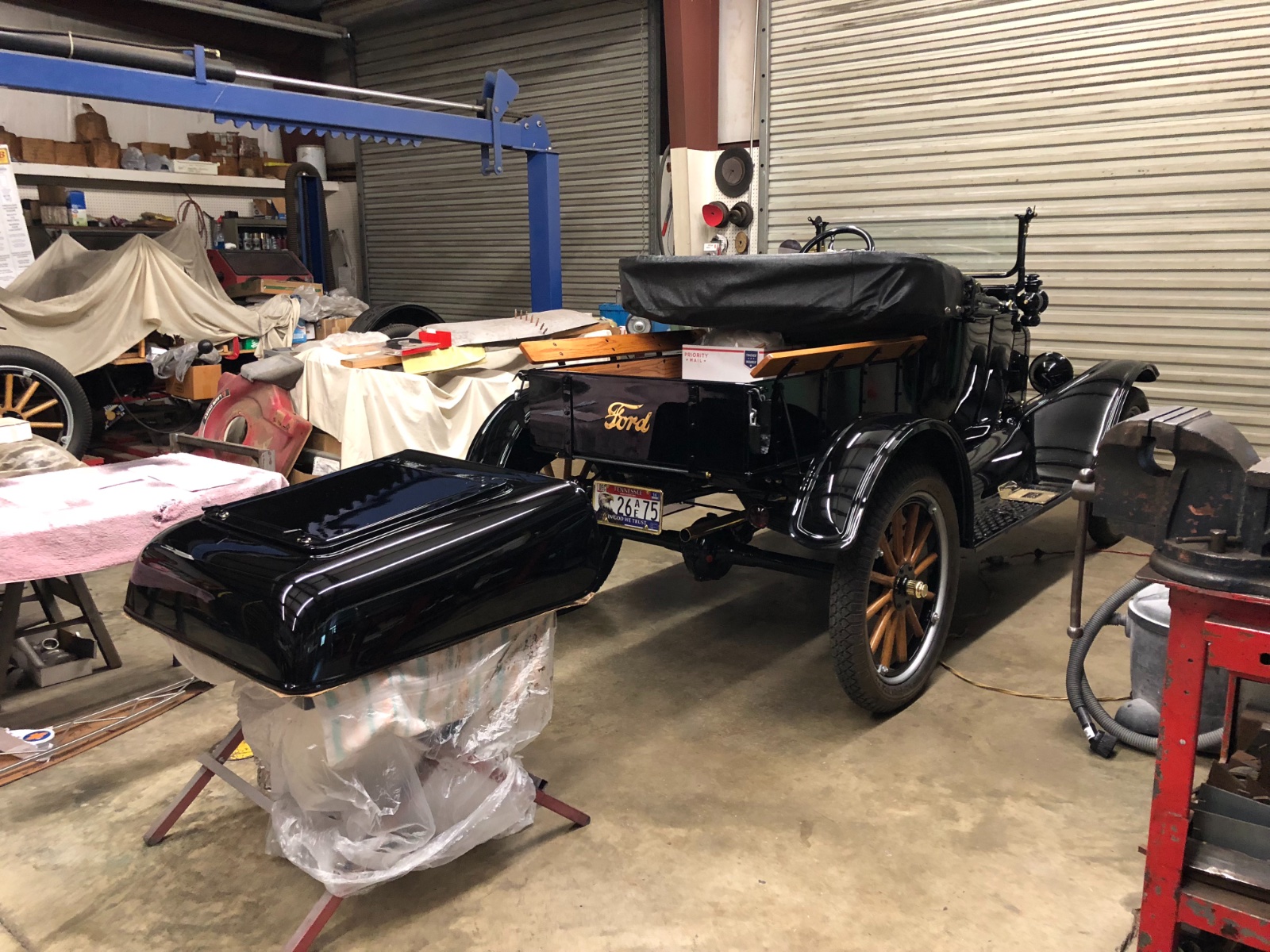

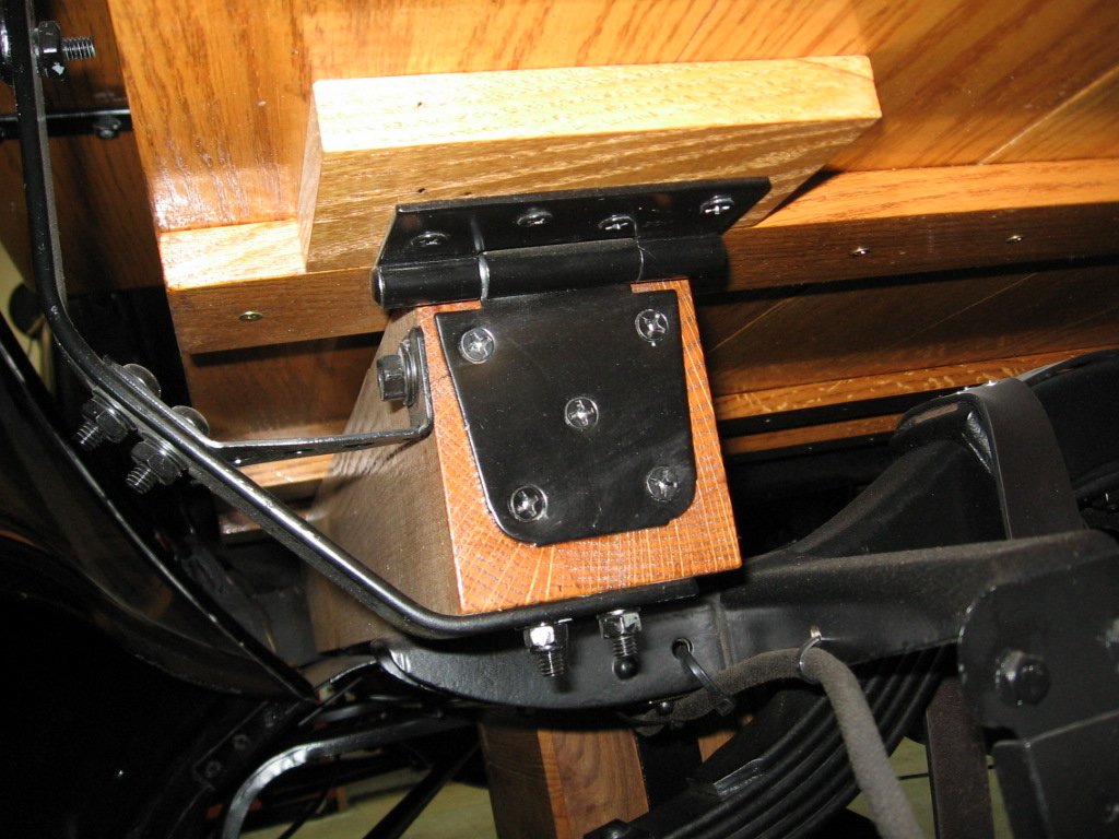

As long as you're putting on a pickup box, why not make it a tilt box? Sure makes battery access easy. My cut-off touring / pickup has custom rear fender brackets, but I'll bet that regular roadster brackets would work. :)

Beautiful pickup bed, Mark ! Thanks for sharing. Good ideas. I don't really need a tilt-bed, but that sure is nifty !

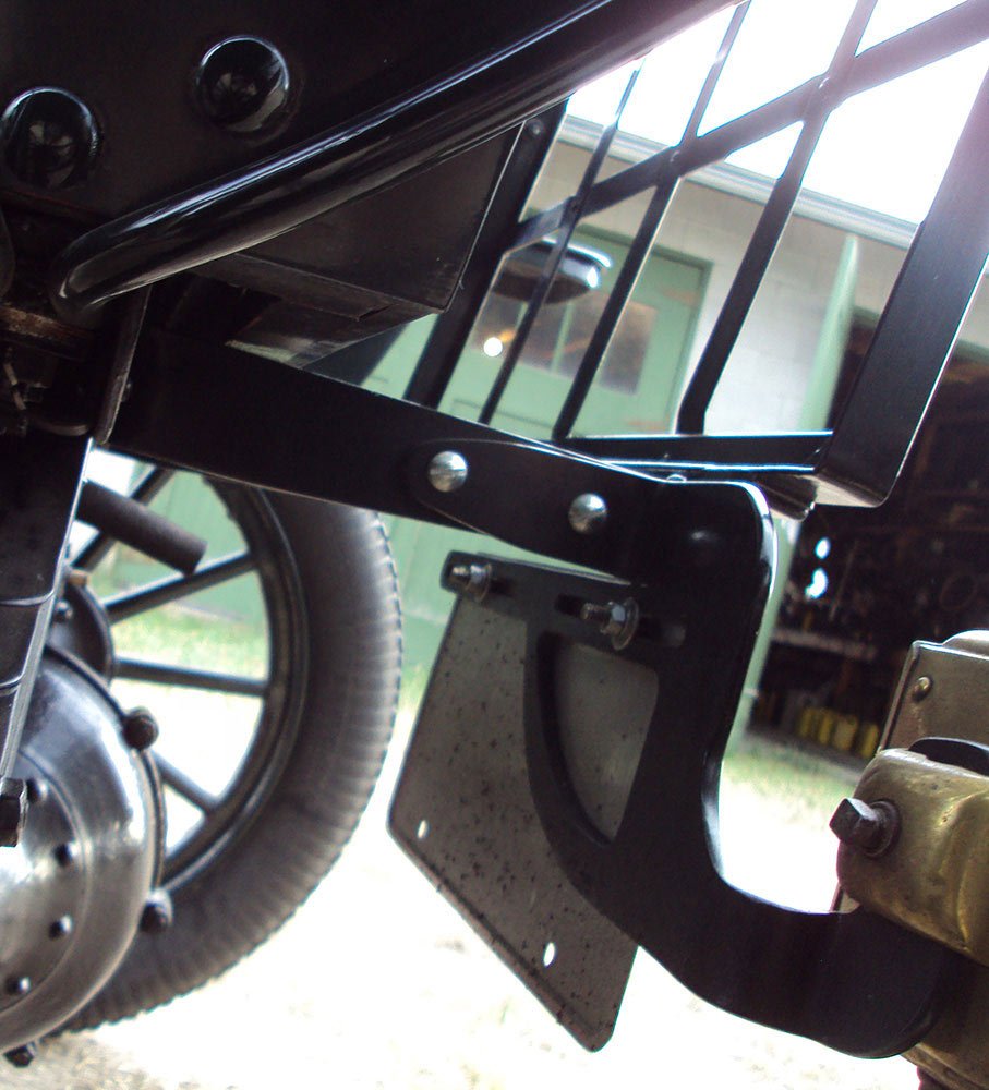

I can wait to see the pickup box. I'm sure it will be a Dandy. I had a similar problem when I built the luggage rack for my Touring. I made a bracket out of plate that moved the light and held the license plate. Maybe this will give you an idea or two that would work with a box.

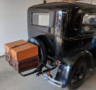

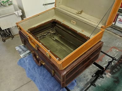

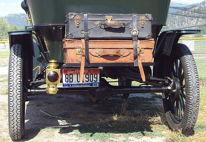

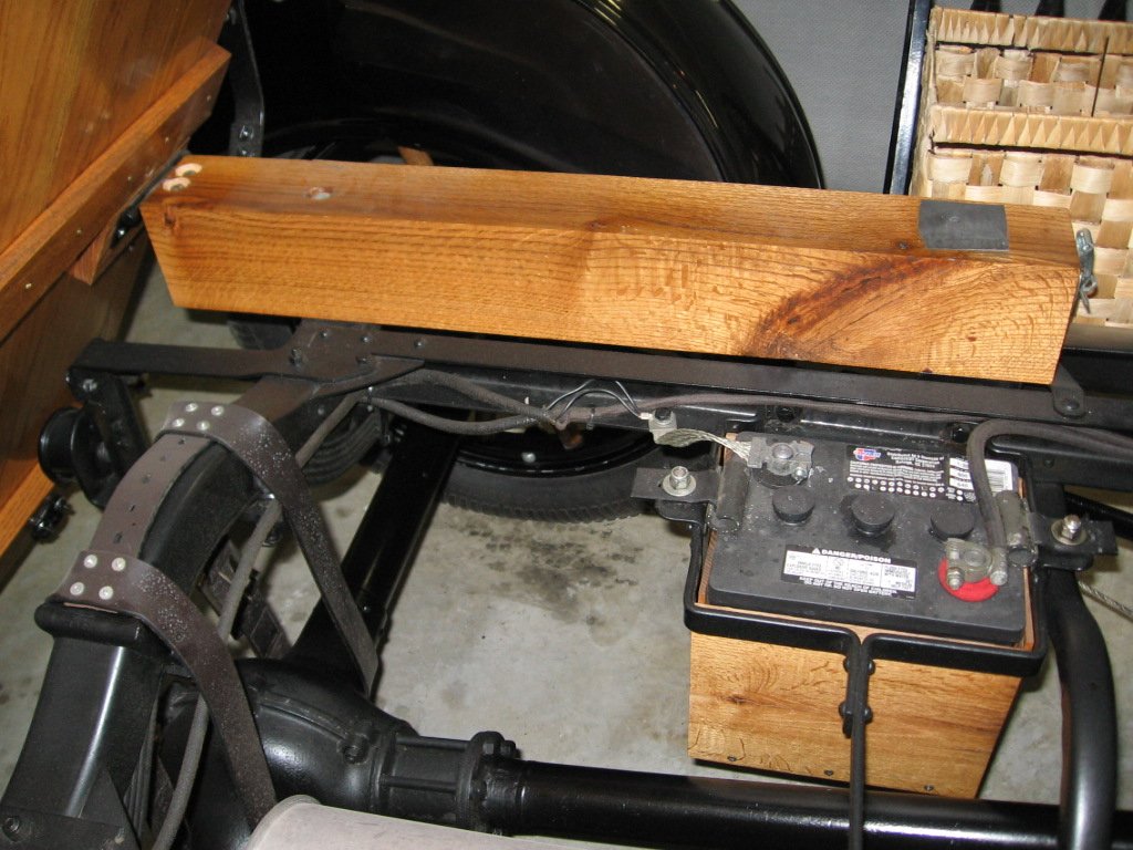

Seeing the suit cases on the back of Rich's car reminded me of something I saw a while back that I thought was a great idea.
trunk 1.jpg (28.63 KiB) Viewed 3297 times

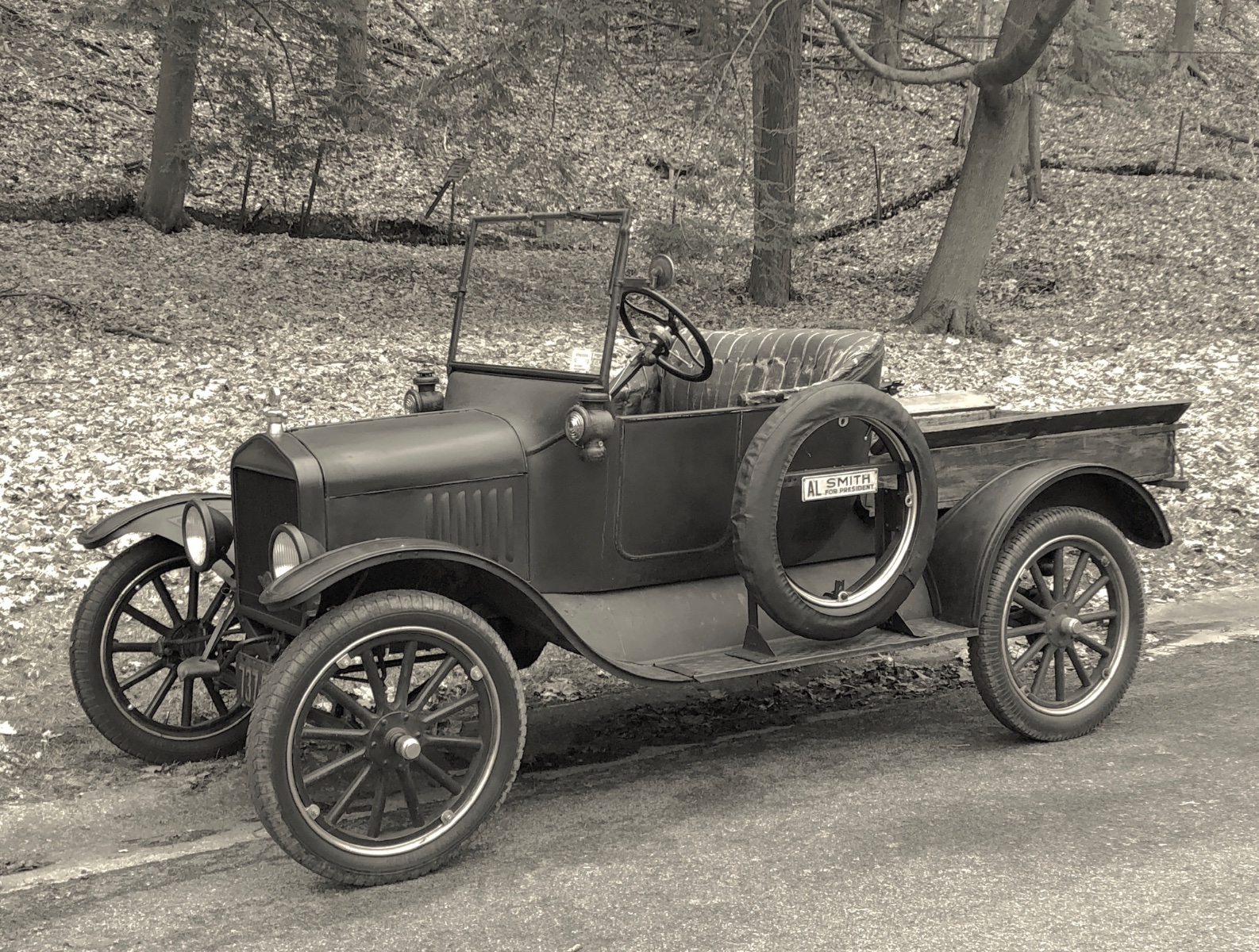

Here is my 23 with an original box. I still have the tail light on the back end of the deck.

Nice pickup Mark.
