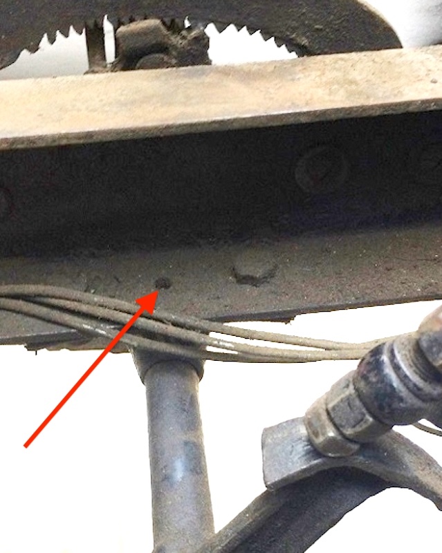

After you free the bracket up, be sure to pick out the old felt in the recess of the bracket which rests against the frame.
Put in a fresh small piece of felt and oil it, then from time to time, put a couple of drops of oil in the hole in the frame rail to keep those bracket bearings from rusting. Lots of water splash can cause it to stick again.

- Posts: 6899
Re: Handbrake cross shaft
The earlier brackets had a squarish body between the shaft and the frame, and these had a felt in them to retain the oil. The later ones just had a round drilled hole. I believe that hole had no felt.You just filled it with oil and let it run free. I could be wrong again.

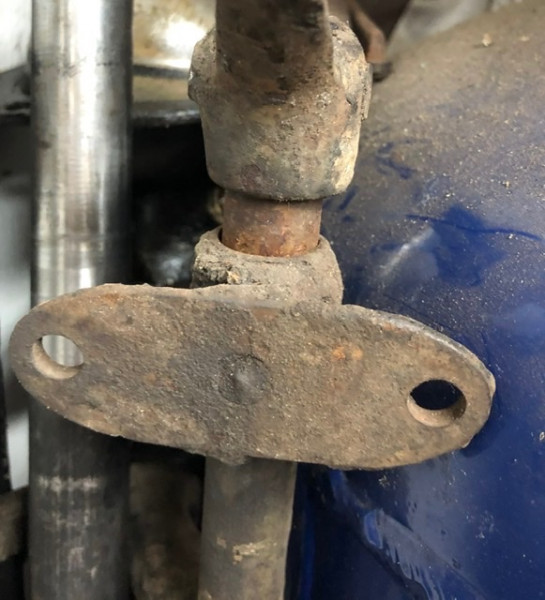

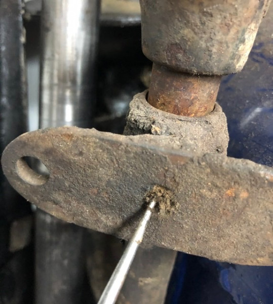

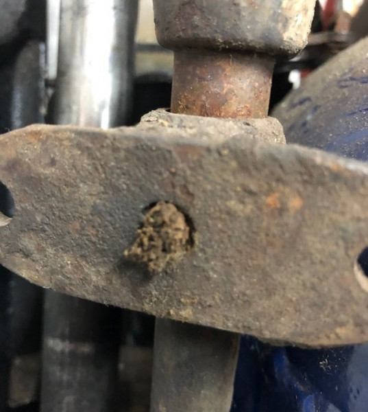

- Posts: 3949
Correct in earlier cross shaft brackets with square like recess for felt plug.
The later ones with round hole. But that hole also used a cylinder of felt too for oil wick.
Here is original, used a pick to pull away the old dry felt!
- Posts: 6899
Dan, I had presumed that to be rusty accumulated crud in any I have pulled. I'll have to be more observant next time.
