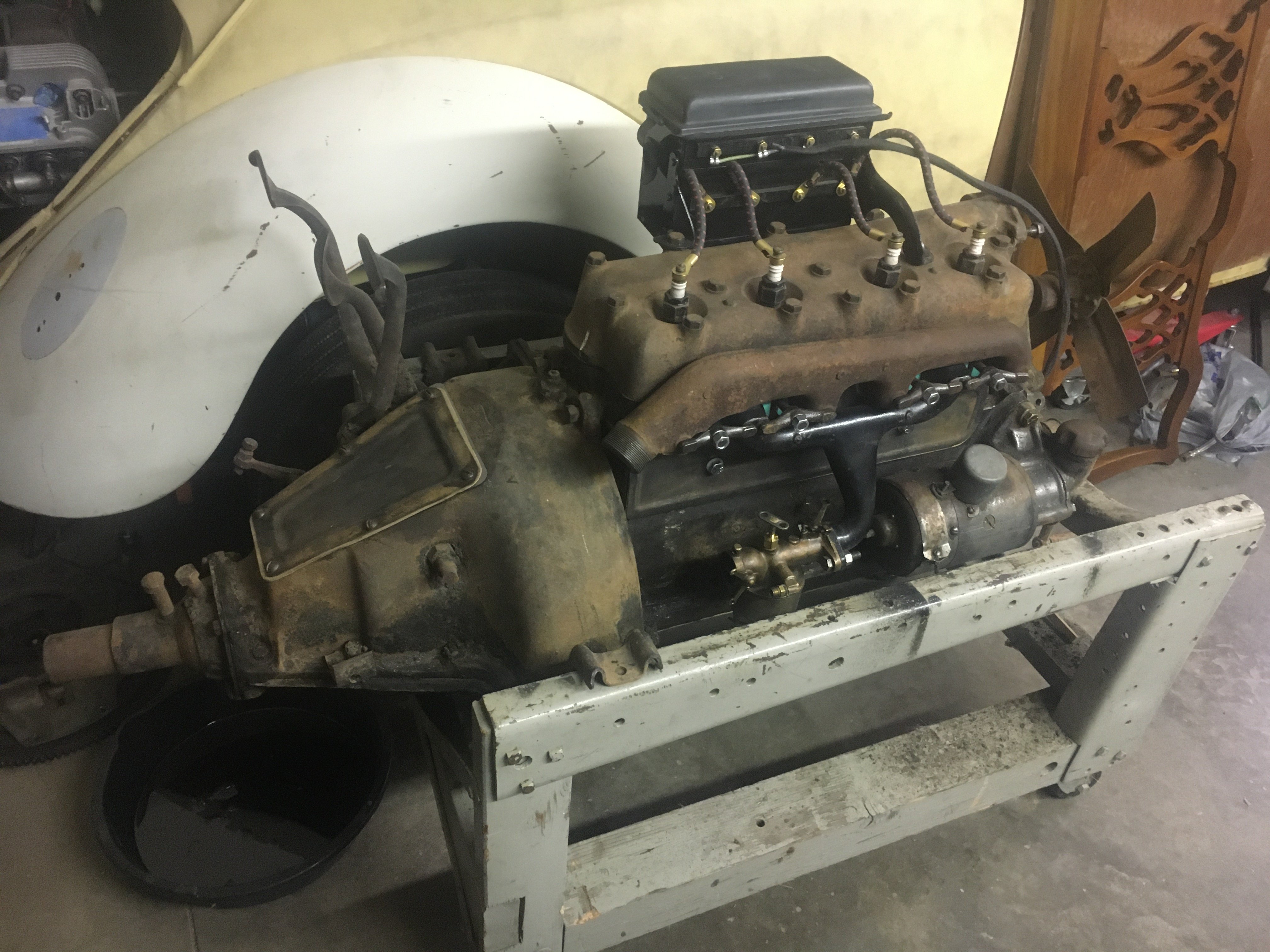

I use a cart so I can push it in and out of my shop. I also us a garden hose for the water supply.

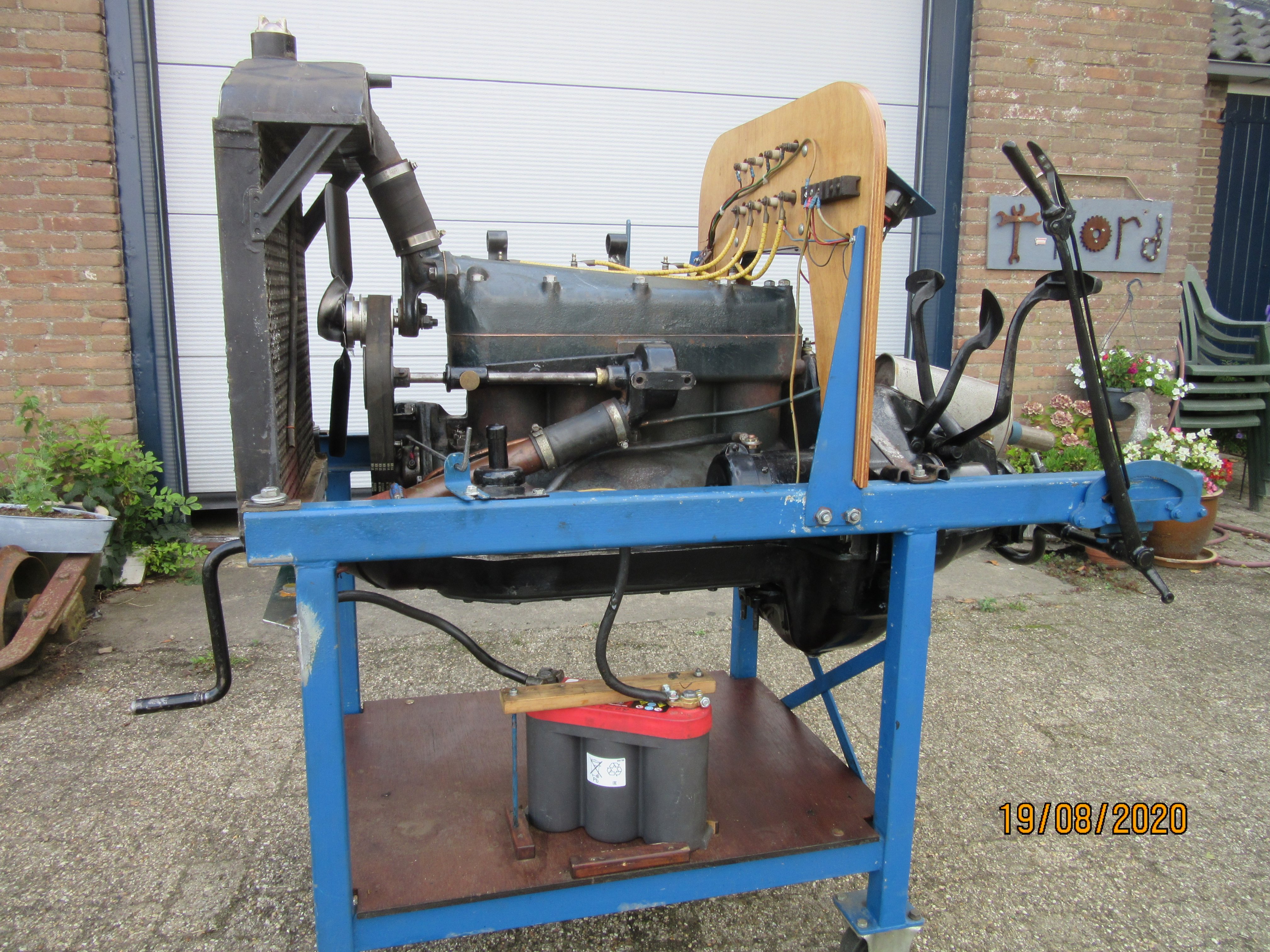

Cory ;
I hope this give you an idea how you can do it .
Toon

Is that the car the engine goes in? :lol: I have a stand that someone had built out of a model t frame. I use a radiator no fan, for safety, so I can adjust the timer as needed and a fuel tank from a honda motor. Bolt the forth main in. After it is running you can test the transmission and brake. It would eventually over heat with out a fan. Sounds feasible to use a hose on a low flow in the block and out the head.

Nice Stand Toon!
