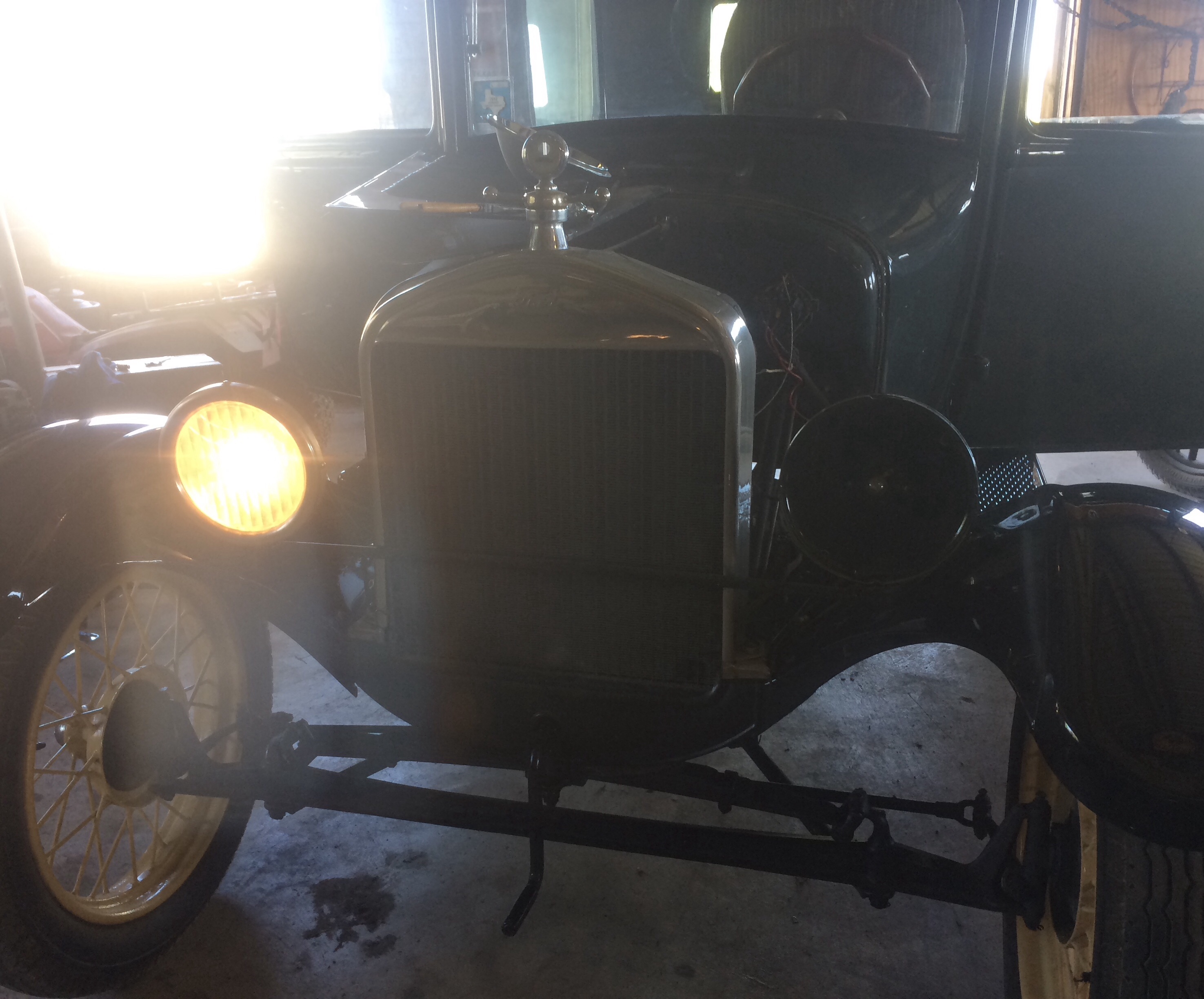

...and I have an 11 pm Saturday night wedding getaway car event ! At first they both didn’t work but by meticulous electrical tracing with a trouble light and parts replacement (headlamp socket and thimble) the RF lit up. I cleaned the contact surface in the headlamp shell with a dremel tool and brush. And I have good electrical ‘fire’ behind the switch at both dim and bright. Also at the terminal block, headlamp socket and thimble. Also have many bulbs that all test good on an original bulb, coil and spark plug tester. Taillamp works great. What’s my problem ??

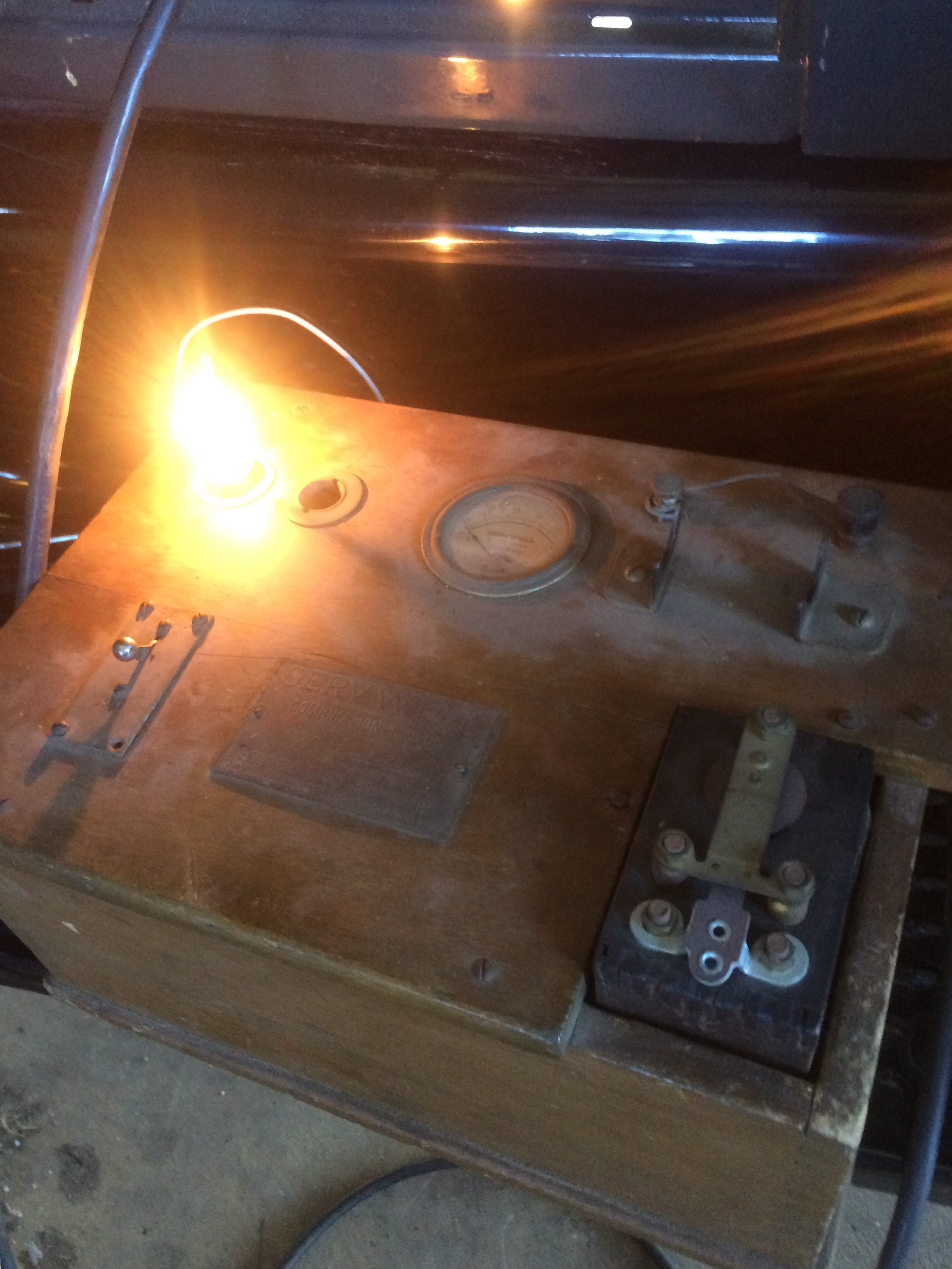

Hook up the wires and thimble to that socket you show, insert a bulb in the other end, turn the lights on, press that shiney part against bare metal on the horn bracket or such.
Sounds like it is probably going to light...
if so...grounding as others have mentioned. Headlights are notorious for weak grounds! The path... You have the socket housing which must be clean, you have the focusing screw as the socket needs to slip fit, you have the reflector to the lamp housing that may or may not help, you have the focus screw to 'bucket', you have the bucket to the front axle (unless it has the light bar) and then it should be good from their back providing your ground strap is tight?

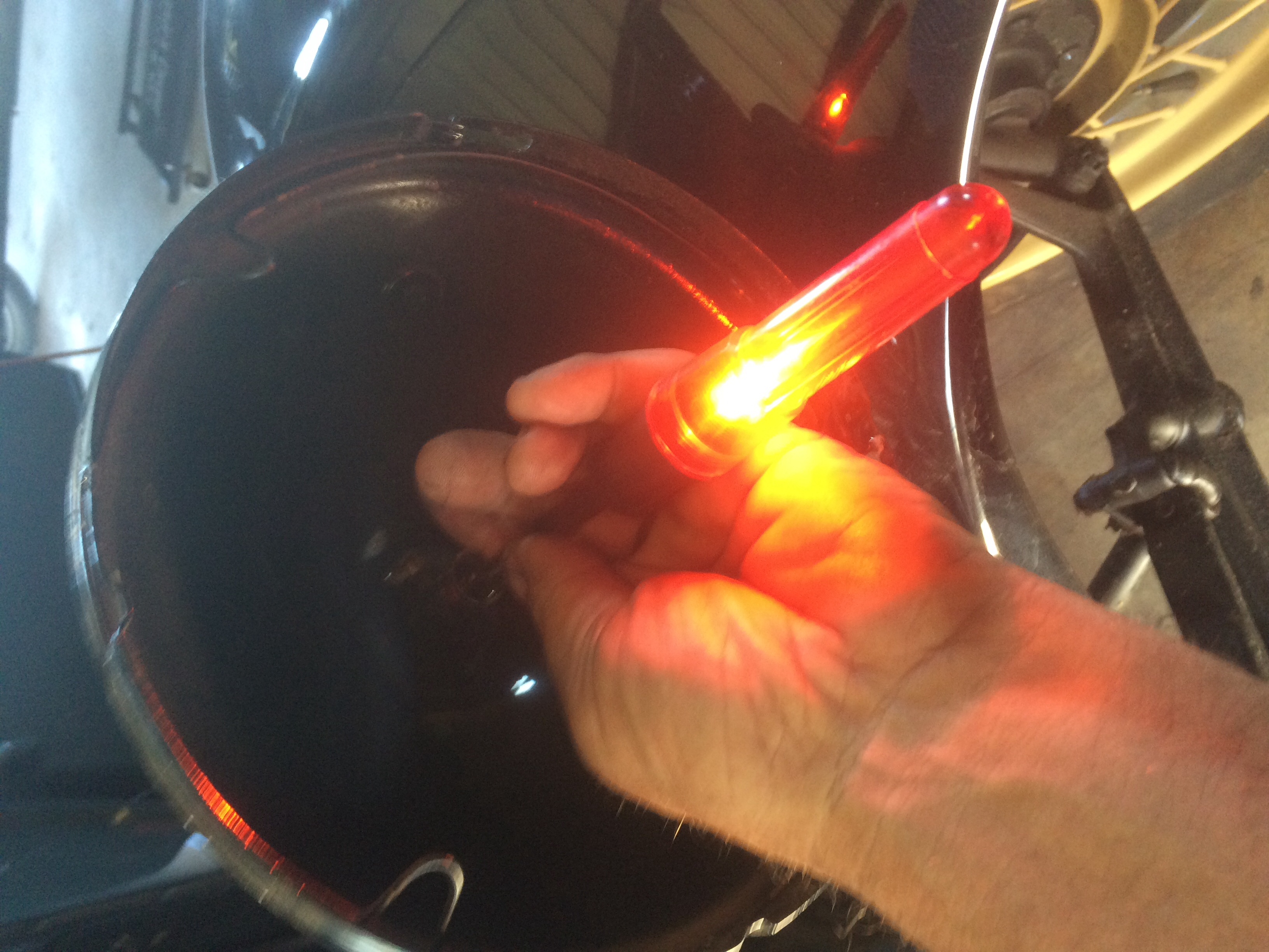

Great suggestions All ! Thanks ! But this is what I’m dealing with. I have ‘fire’ all the way through the mounted thimble and socket. So it’s not a bad ground situation,..right? And the bulb is shining (see pic of original bulb, spark plug and coil tester) I’m still at a loss ... Magic ?

Does that test lamp have its own separate ground? If so, you just proved that you have strong voltage on the positive side of the bulb, but a poor or no ground. If time is short and you just need to "get her done" temporarily, run a separate ground wire from the shell of the socket to a clean, bare spot on the frame (like where you grounded your test lamp).

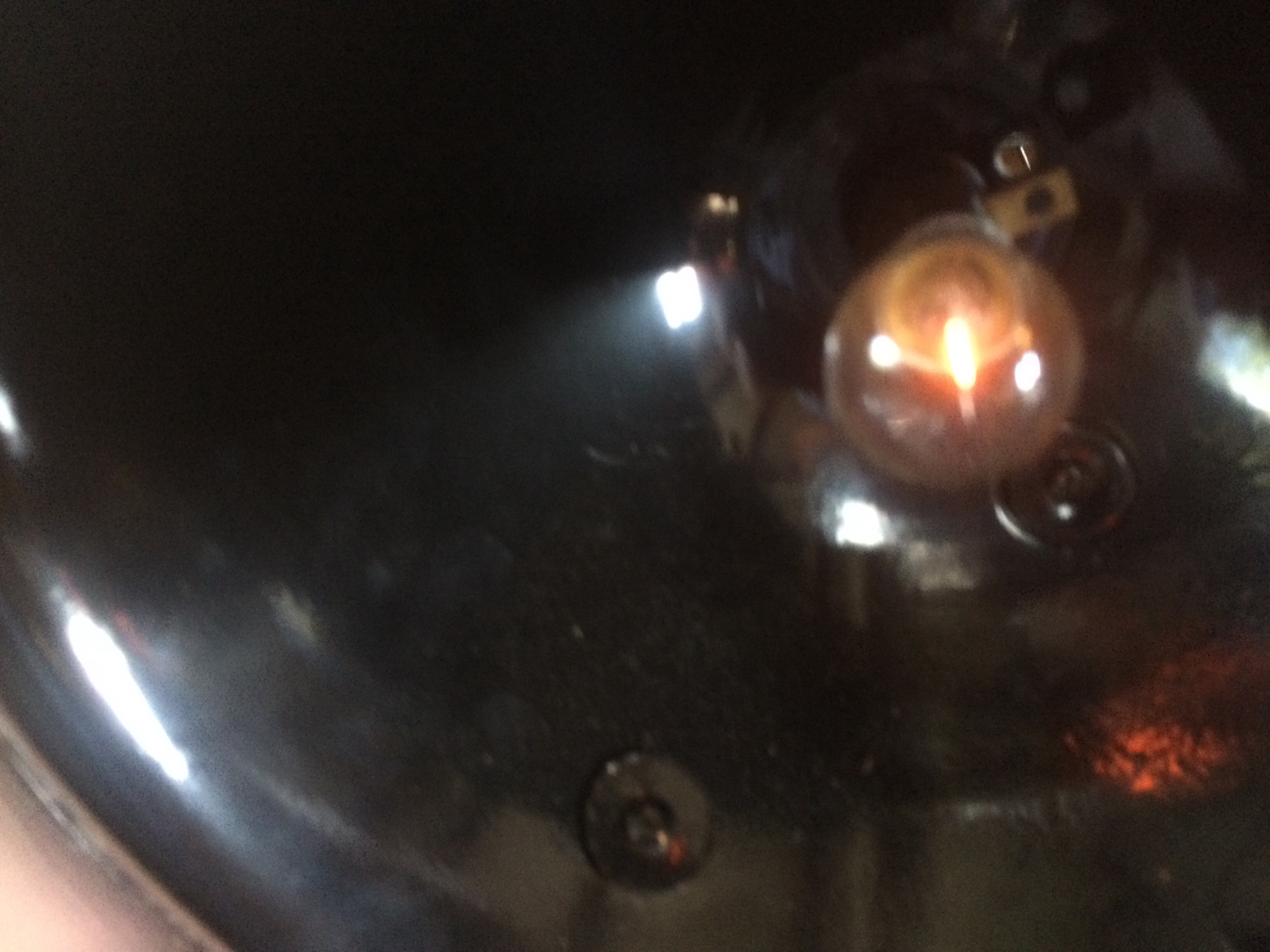

Great frustration ! Wire from battery negative to headlamp thimble doesn’t light bulb. Ground wire from headlamp adjusting screw to frame also doesn’t light bulb. However, without those 2 attempts, I did get a barely discernible glimmer this morning - see pics.

Known 6 V to thimble contacts -checked with volt meter Yes? Check...
Socket housing to ground jumpered for good contact Yes? Check
Bulb is a 6V lamp as it does light on test box Yes? Check
Hate to say it buddy, short of the bottom contacts on the lamp barely kissing the contacts in the socket, the lamp HAS to light!
Other than that, the dim you see is either the real dim and that’s just the way it is...or...something is going to get mighty warm mighty quick. Just for kicks, exchange the two wires at the thimble and try again? (If that doesn’t get you a eureka moment, change them right back before you forget

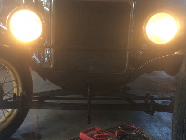

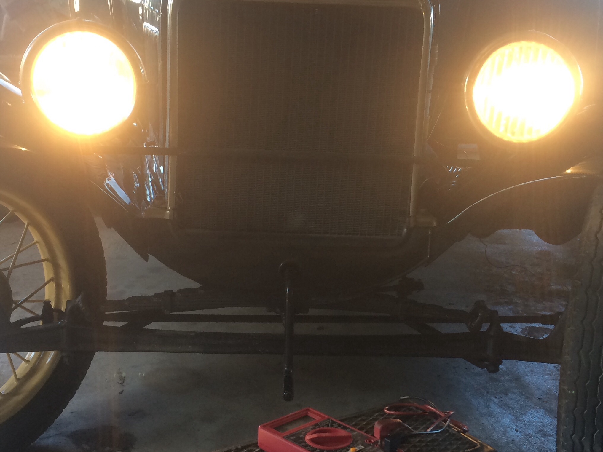

Thanks to all !! Every contribution pushed me a little farther toward success. See the multimeter in the foreground

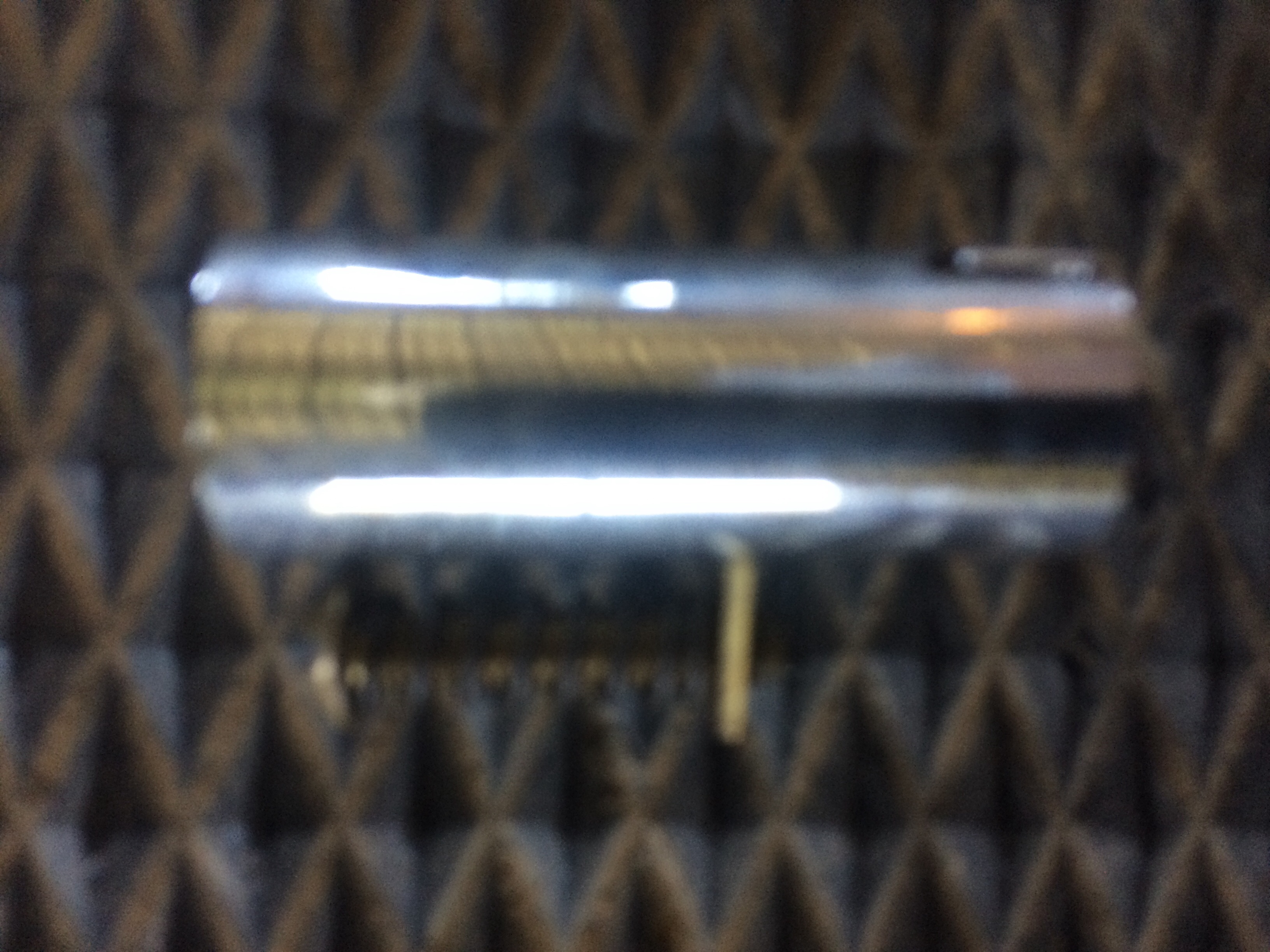

- Attachments
- ba15d-60-smdt.jpg (2.95 KiB) Viewed 5199 times
