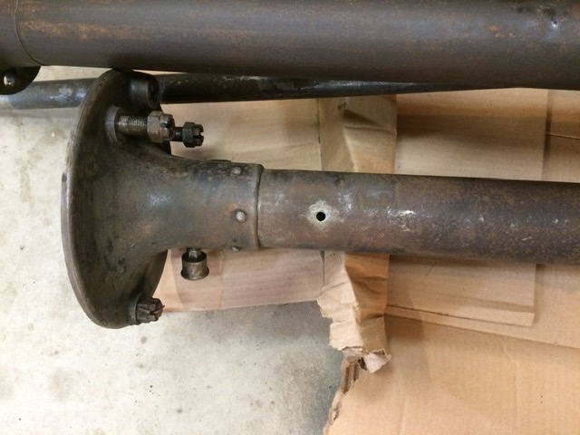

Clean 105 years of dirt and grease off the rear axle housings today. No wonder my t has been marking her spot. Found this in the right side housing. Should I try to braze or weld it? Was it drill to let out oil so it would get into the emergency brake drum? Going to order all my replacement parts on Monday. The outer bearings and s leaves were replaced about 10 years ago but have very few miles on them. They are the type with no grooves on them. They fit nice with no play. Should I replace them? Where are they available with the grooves or do I order the sealed outer bearings $$$.

To me it appears to be a Breather Hole. Probably not required with the original type sealing arrangement.
However, as discussed here previously, once you upgrade Pinion Bearings and use effective Oil Seals there and in
Safety Hubs the likely hood of pressure build up is real. I have just added a Breather to a rear end and have used a clear
tube to see any evidence of oil working its way up.
You will notice that it has been drilled inboard of the original seals and Hyatt Bearing Sleeves. ideal spot. I would tap the hole and fit a low profile Breather with a Cap. Others may disagree but once tapped out, you can easily plug it later if required
Cheers Alan in Western Australia

That hole looks to be at the bottom of the tube. If so it would not be a "breather" but a drain. We now have available good seals for the wheel bearings and you should not need to drain the fluid. Only exception would be if the 4th main at the rear of the transmission leaks letting oil drain down the driveshaft tube to the rear axle. If your babbitt is good at the 4th main and you keep plenty of grease in the U joint, this shouldn't be a problem. It is better for the brakes to let a little oil leak to the ground at the U joint than to let it run back to the ground. Just put a pan under the transmission at your parking spot and don't worry about it.

I put a grease cup in that hole on one of my tubes just to mess with people. :)

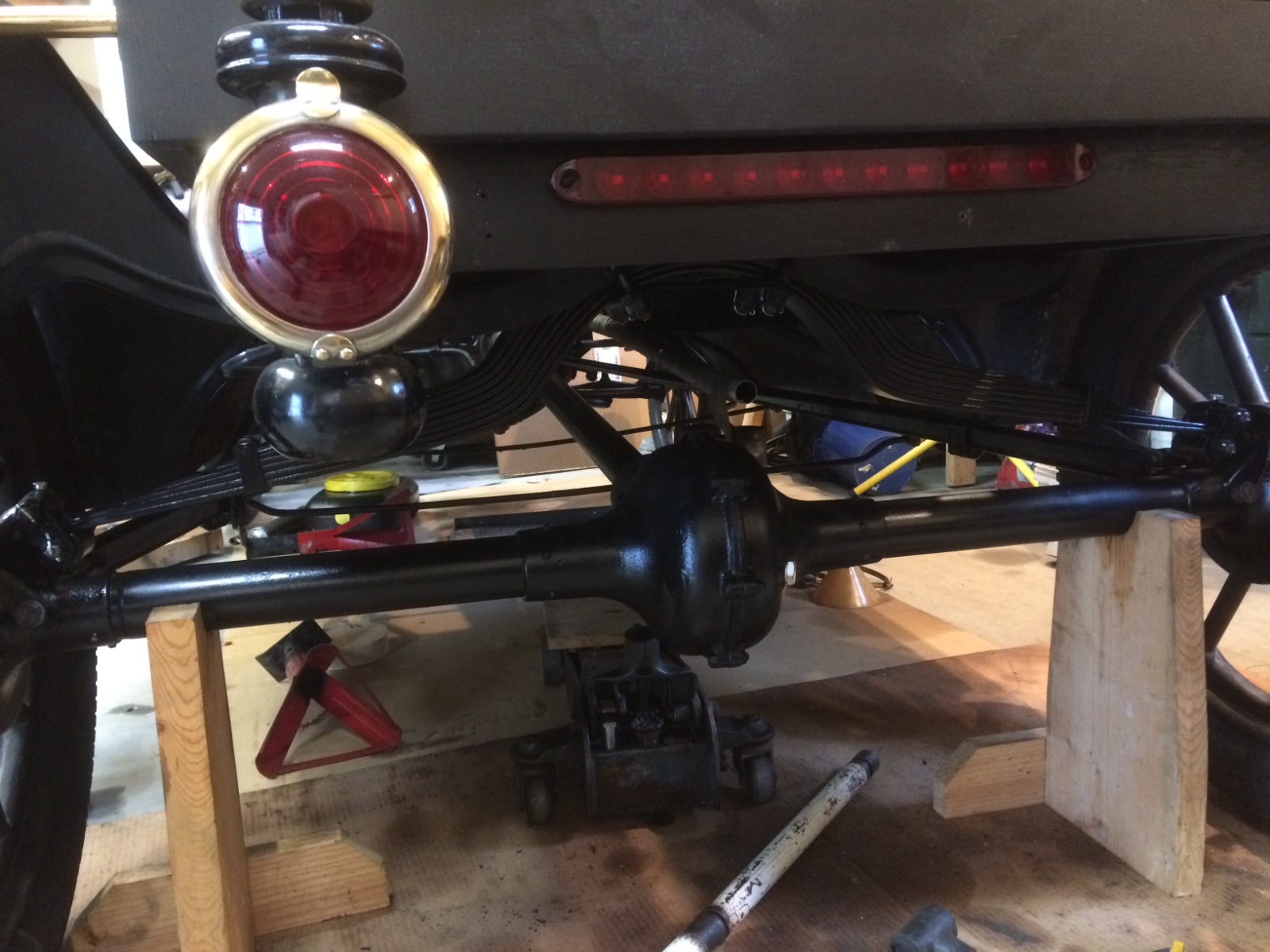

So close. Installed the rear axle today with the help of a neighbor. Second try we slipped into the tail shaft. NOS shackles should be here Monday or Tuesday. Installed new inner seal, new bearing sleeves, packed the bearings and installed, and installed outer seal. Then checked the hub bolts. Guess what I now have to order. They were pretty shot. I can wait a few more days to make sure it’s safe.

Neil, the nuts which come from the vendors and are correct for a T, are thinner than hardware shop nuts. This is to provide maximum clearance between the inner ends of the bolts and the brake drum. Worn axle tapers/hubs will exacerbate this. However, the thinner nut will not take the same tension that others will, and it is not difficult to strip them. I try to use standard nuts first, changing to the thinner ones if there is a clearance problem.

Hubs all Cleaned, wire brushed, painted, and reassembled. Turning nice a true. Ran the differential last week with the wheels off. Sound nice a quiet. Everything looking good so I couldn't finish looking at the rusty rear springs. All disassembled and wired brushed. Picking up some spray graphite slip paint tomorrow. Saturday finish reassembling and a test ride. I’ll post finished pictures then. Been a lot longer project then I was thinking, but worth the wait.
