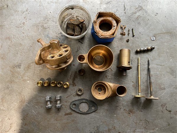

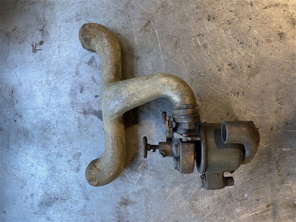

I am always working on my Ford, and I work on the carb at this time. I thanks Kim to help me with special parts. I would like to discuss with you about this carb befor to make mistakes.

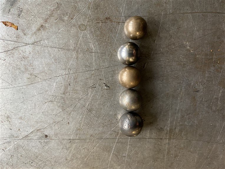

I have 5 balls : 2 brass same size, 2 steel same size and 1 steel bigger size. Normaly it was 5 brass same size? Did you alredy saw this improvement?

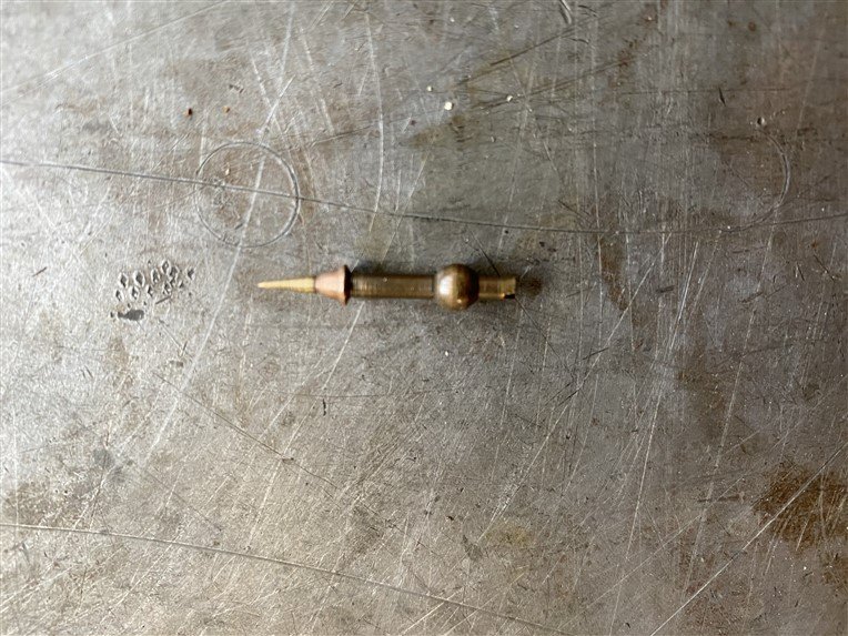

What do you think of my needle which adjust the level of the fuel in the carb. I have to make a new one? I could make a test but your experiment could help me.
I heard some people said these carbs doesn't work properly? It is right or they just did'nt understand how they work?
Thank you for your post, I join some pictures.

They are simple carburetors and run well. Throw out all the old balls. Buy new ones the correct size. Grind the seats with a small ball shaped stone the same size. Fuel height in the bowl is critical to getting the engine started.

I am not taking in any rebuild work at this time. I probably will again next year but I am too far behind due to some things going on in the last year or two So I am not soliciting your rebuild. Clean everything well, it will work fine.
