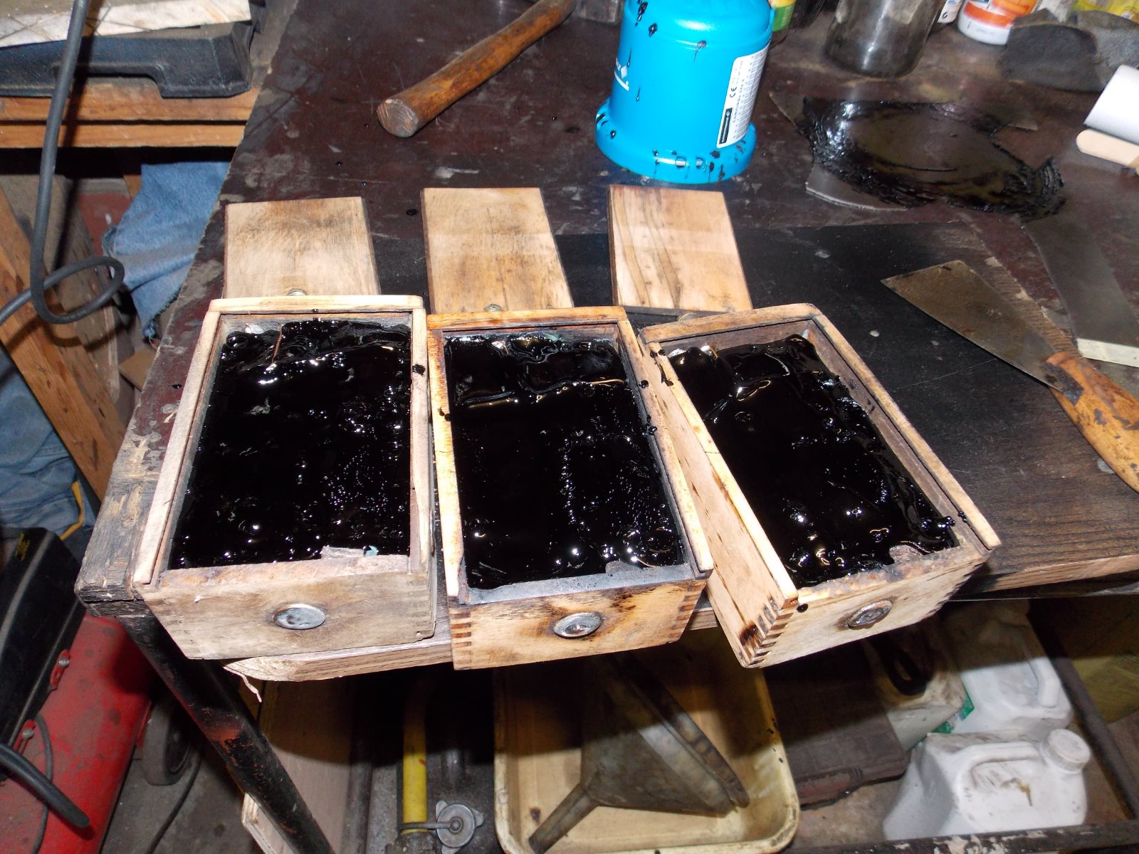

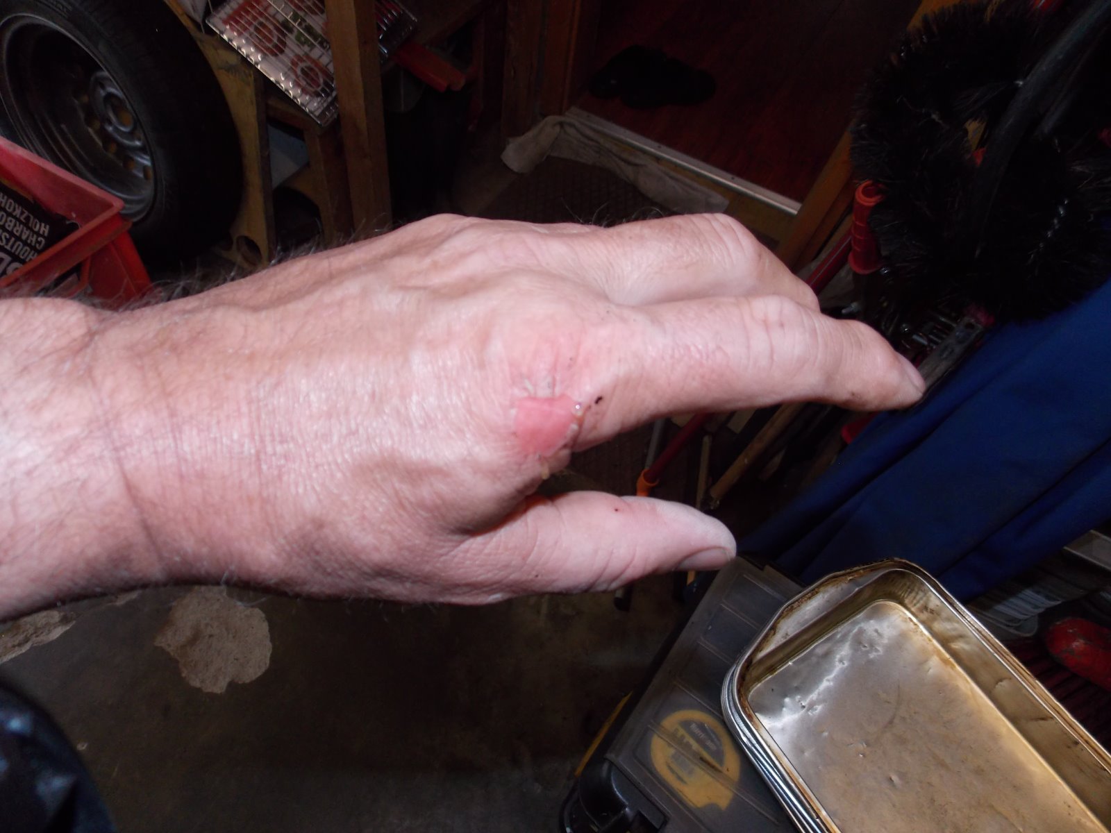

AndreFordT
Posts: 562
Joined: Sun Jan 06, 2019 12:25 pm
First Name: Andre
Last Name: Valkenaers
* REQUIRED* Type and Year of Model Ts owned: 1926 ; 1922 ; 1915.
Location: Scherpenheuvel
Re: coil repair
Post by AndreFordT » Fri Feb 22, 2019 9:28 am
Some time ago I was in a hurry and didn't use gloves when I was filling three coils with tar.
This is what happened.
Be careful and take care use good gloves to protect your skin.
Andre
Belgium
