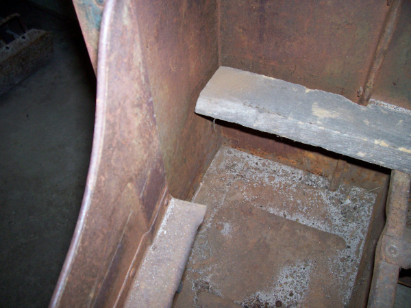

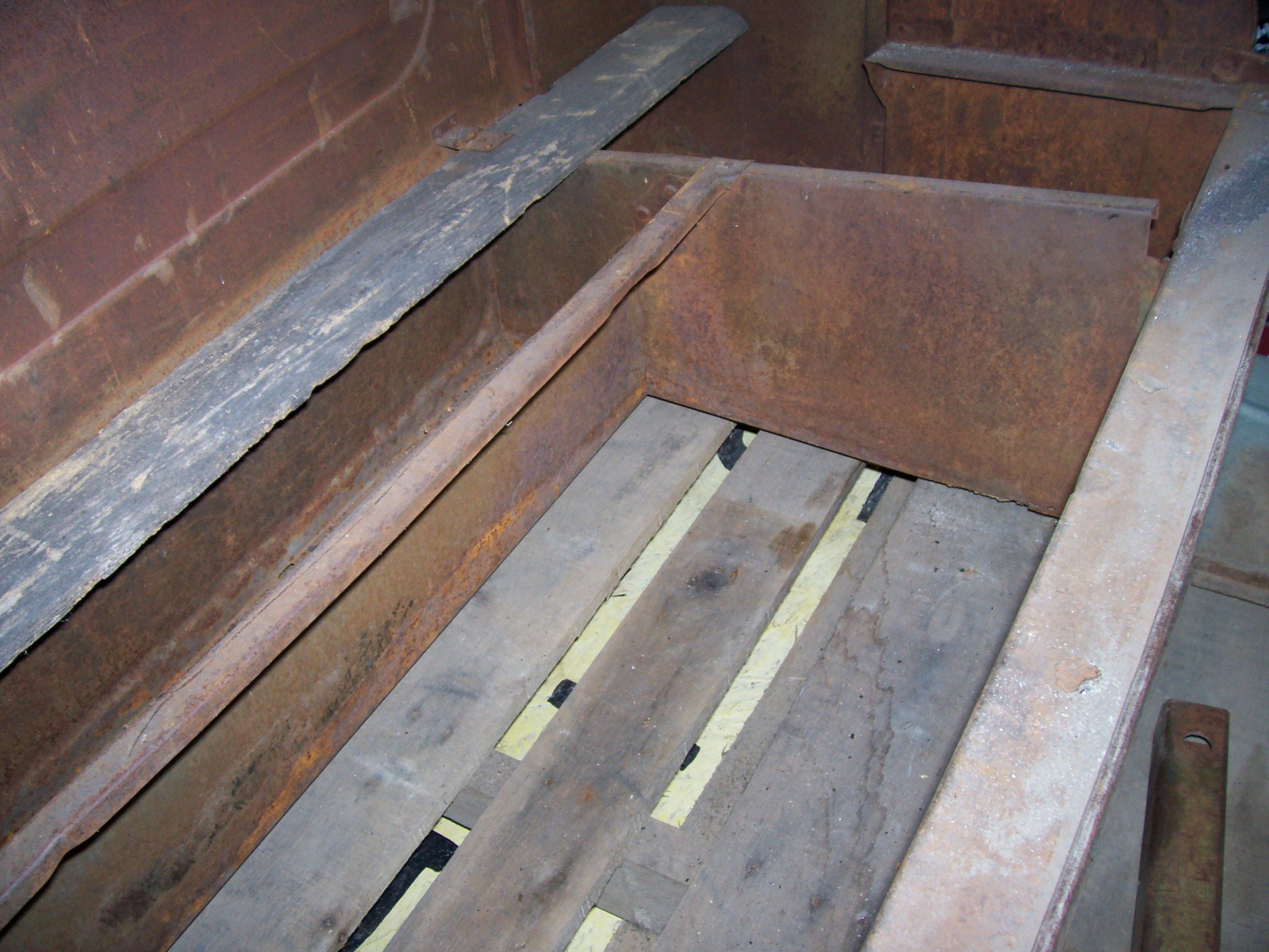

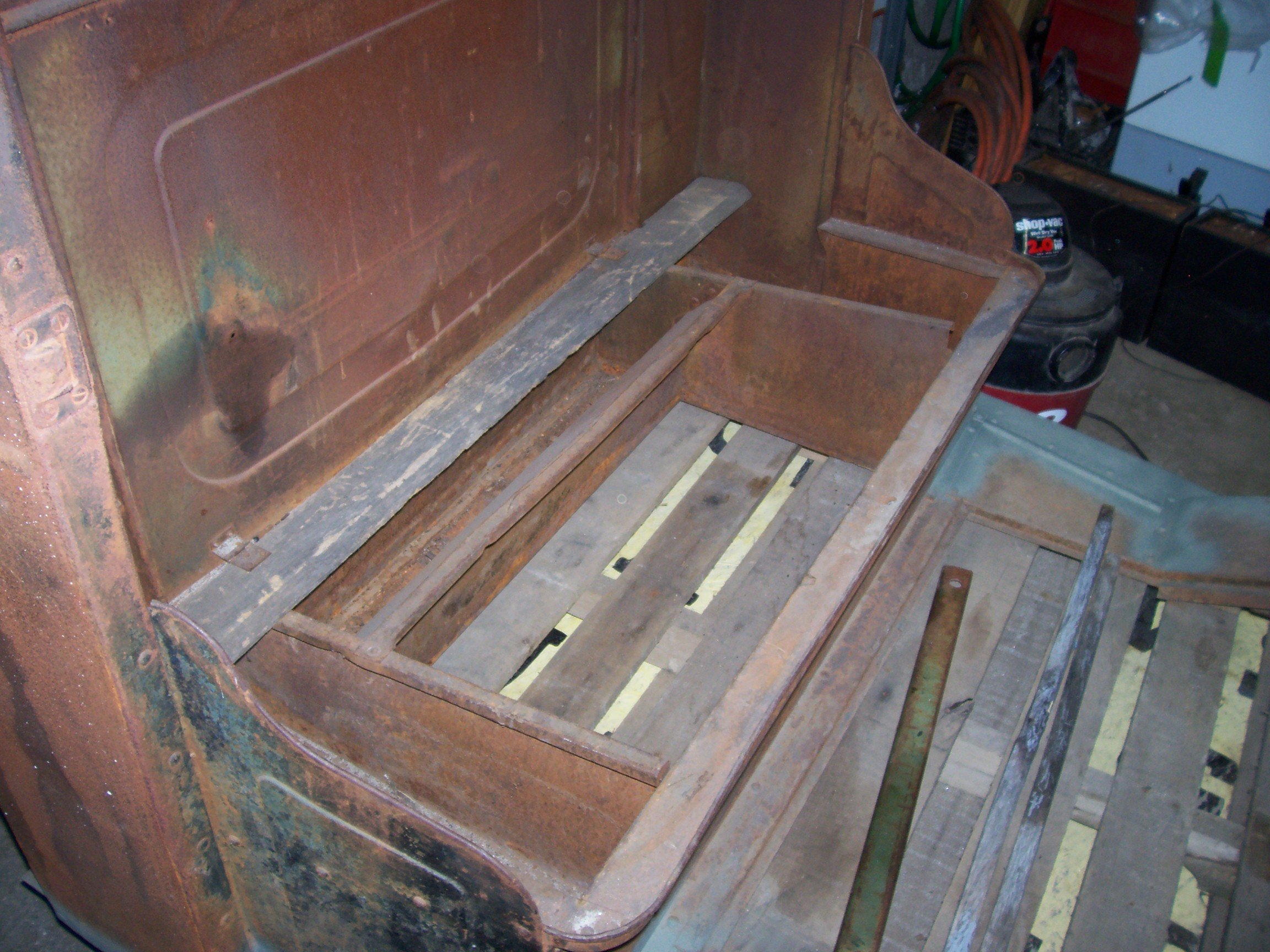

I also would like to see what a TT seat looks like. My Two closed cabs both show a hinge riveted to the back of the cab and to a wood beveled piece. What does the rest of the wood look like?
[image][/image]
[image][/image]
[image][/image]
The back of my cabs show something was attached just above the wood seat .
Herb
