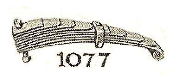

From the parts catalog...
Rear Springs.jpg (28.11 KiB) Viewed 1963 times
Although the top leaf is very short, they are often found broken.

Post by HPetrino » Thu Oct 08, 2020 12:47 pm
Rich,
When I took mine apart one of the little top leaves was broken and the other was missing altogether. I don't see how there can be much flex at the top of the stack. It's hard (at least hard for me) to understand why they are so commonly found broken.
