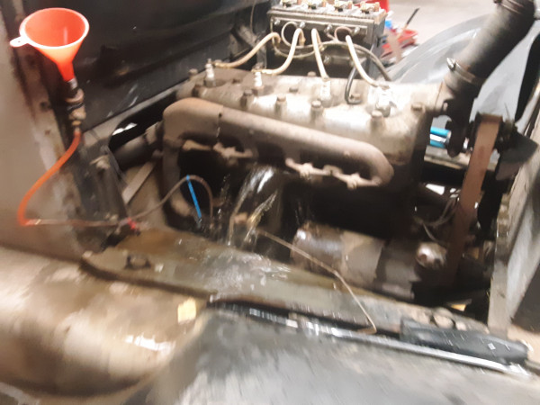

I started up my engine after installing the freeze plugs and the radiator and apparently installed the freeze plugs wrong. Do the freeze plugs go dome in or dome out?

Dome out, then you use a punch just slightly smaller and a hammer and tap the center flat. This expands the plug to seal it in place. Some put them in dry, some use a sealer like ultra black Permatex in a thin film on the edge. Some use a buffalo head nickle that they form a cup in, and then set like a steel plug.

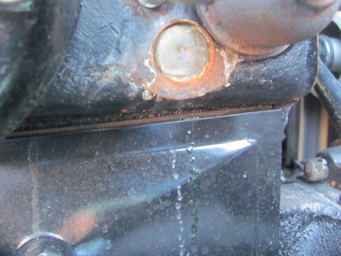

I'll agree with Steve Jelf, the soft steel of reproduction Welch plugs are prone to early rust out from within, after just 6 years, the soft steel plugs developed leaks around the rim of the steel core plug. Was weeping, so instead of replacing, for then, added a smear of J-B Weld.

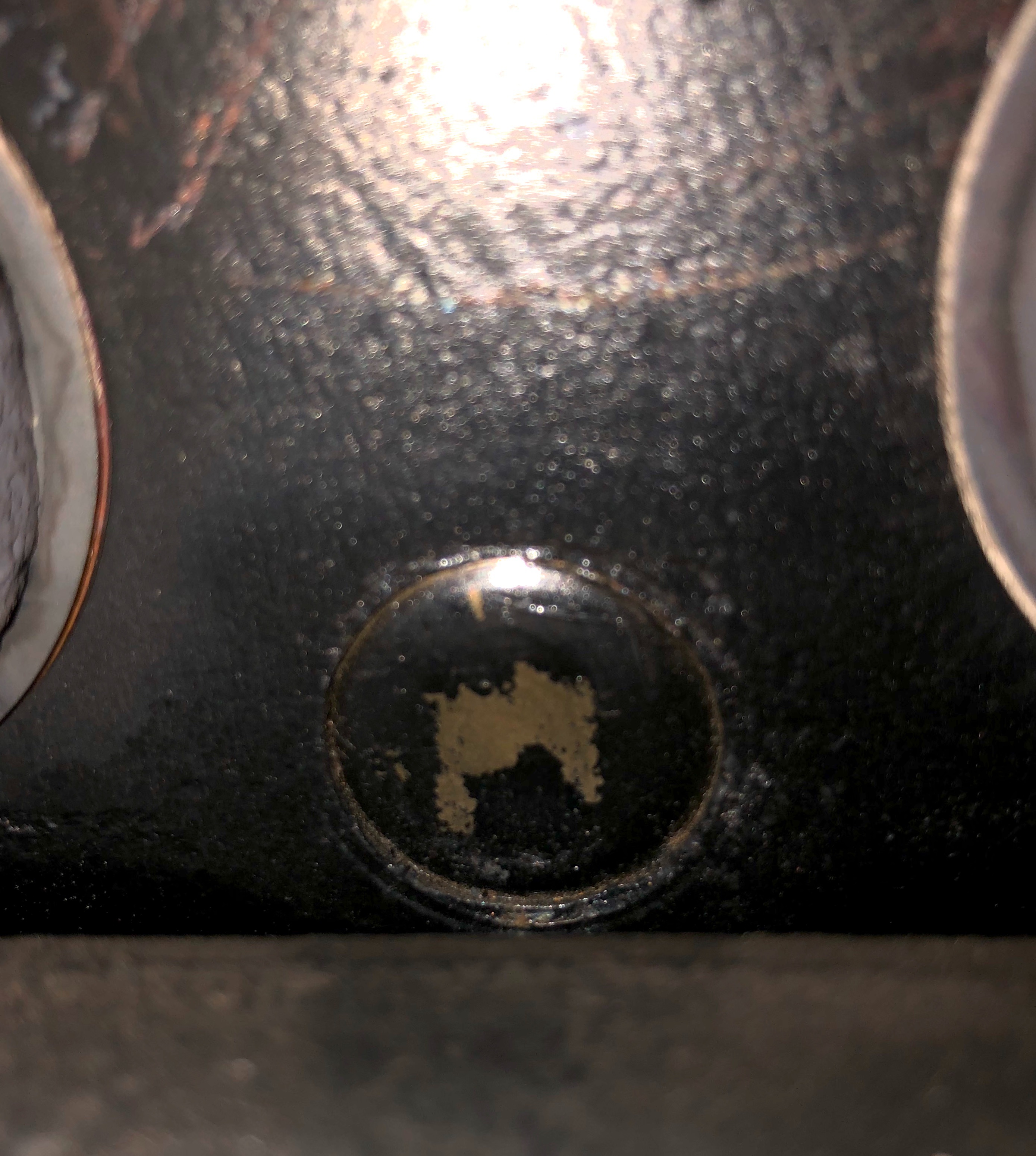

This held for a few more years, then pulled the motor for a cracked reverse drum and installed brass plugs. Brass won't ever corrode. Oh....the radiator in my T's get flushed every 2 years, and new coolant added, distilled water and green anti freeze
Typical weeping from rusting soft steel core plug.
Brass core plug, never rust.....

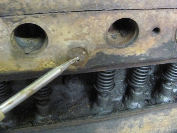

Original Ford better steel plug, they last for years, but even then rust from the inside. Pin hole in center made it easy to poke out this old plug
