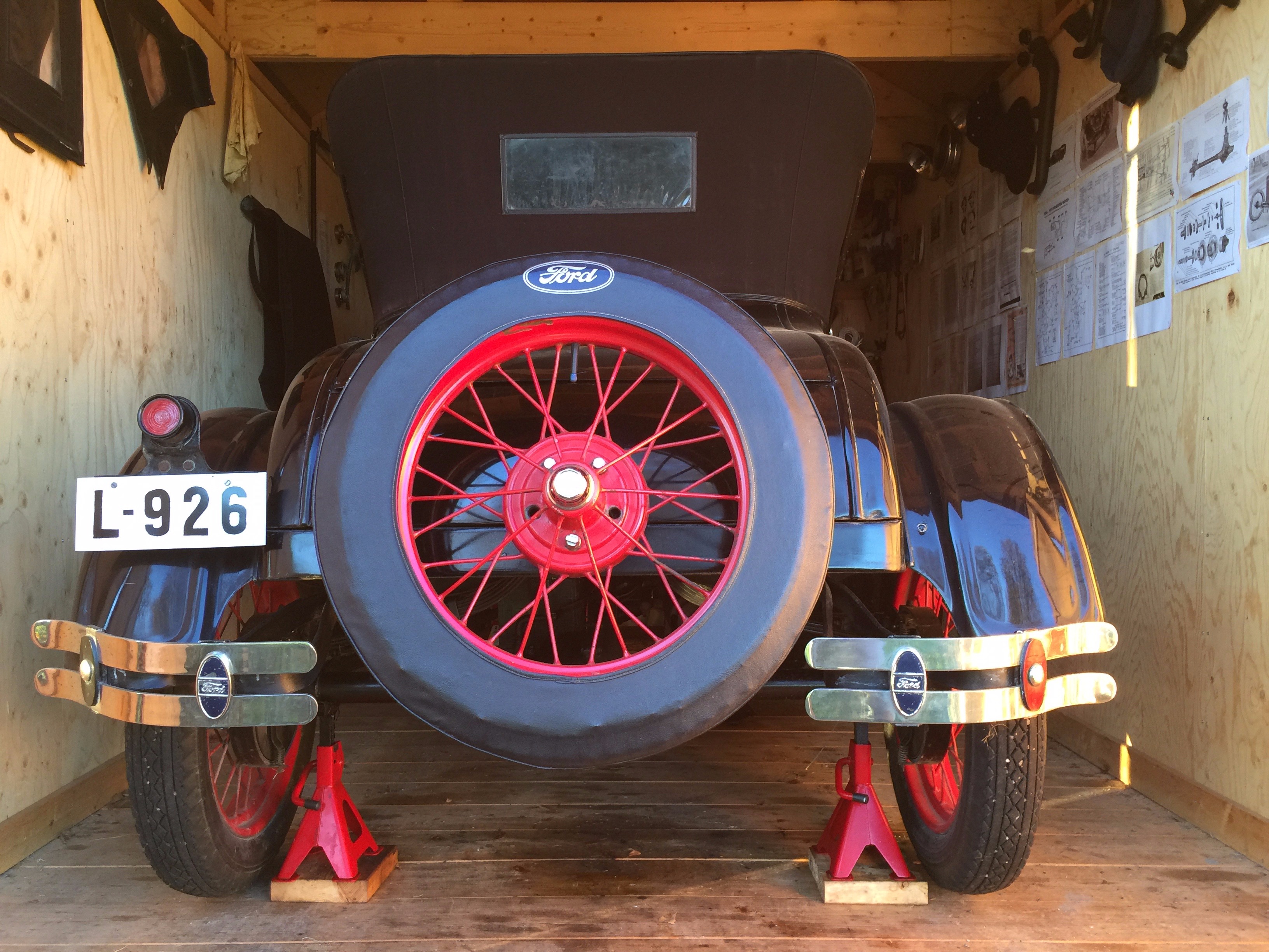

Re: Photos of 1927 Coupe Rear Bumper Brackets?

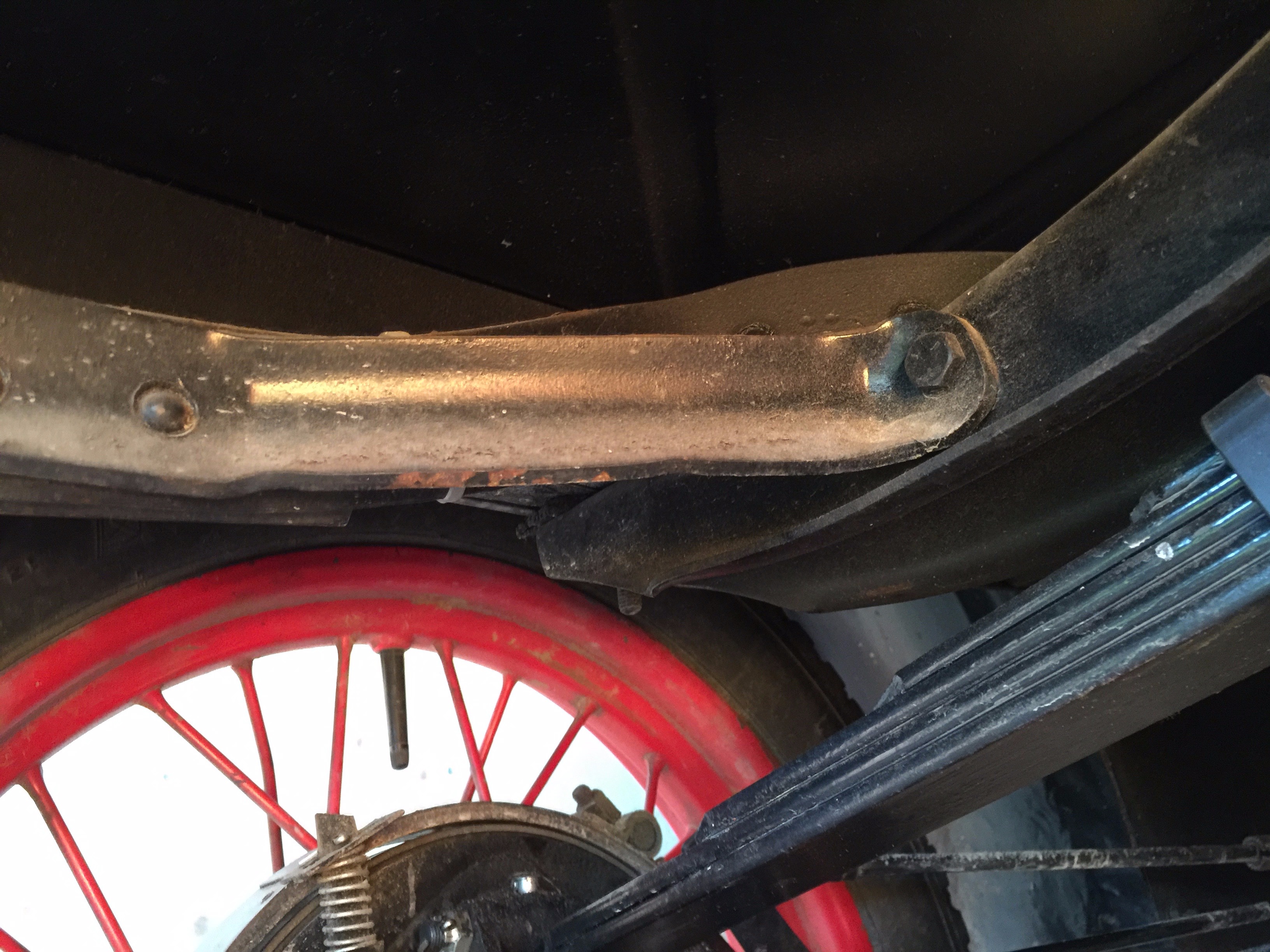

Hi. This is how my brackets are attached on my 1926 roadster.

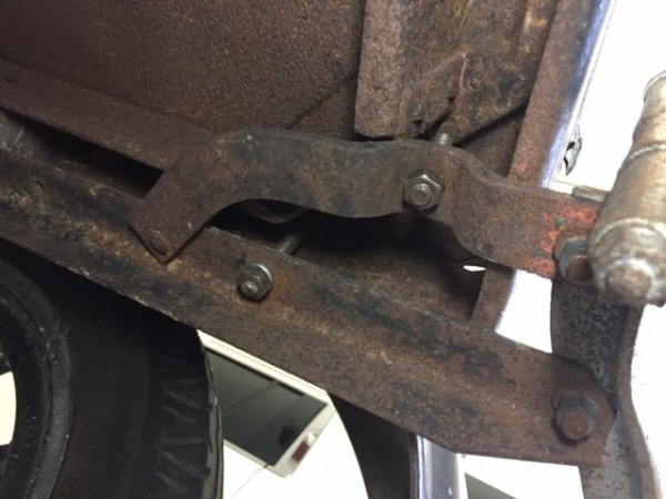

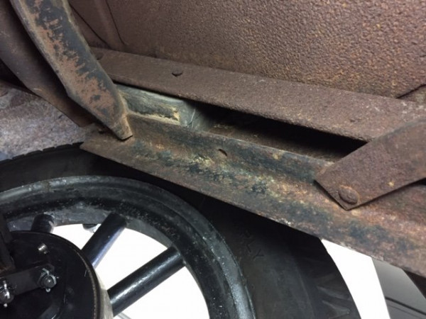

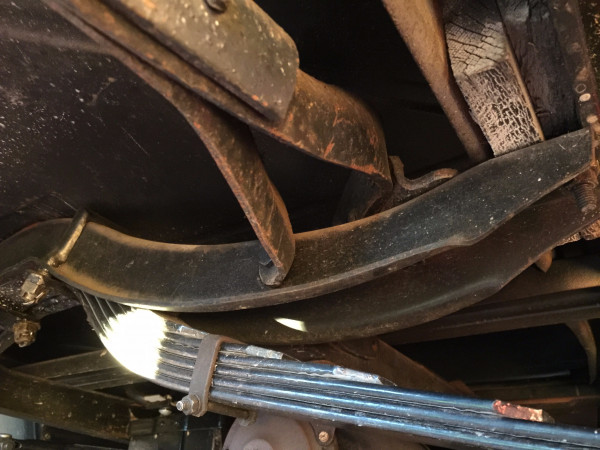

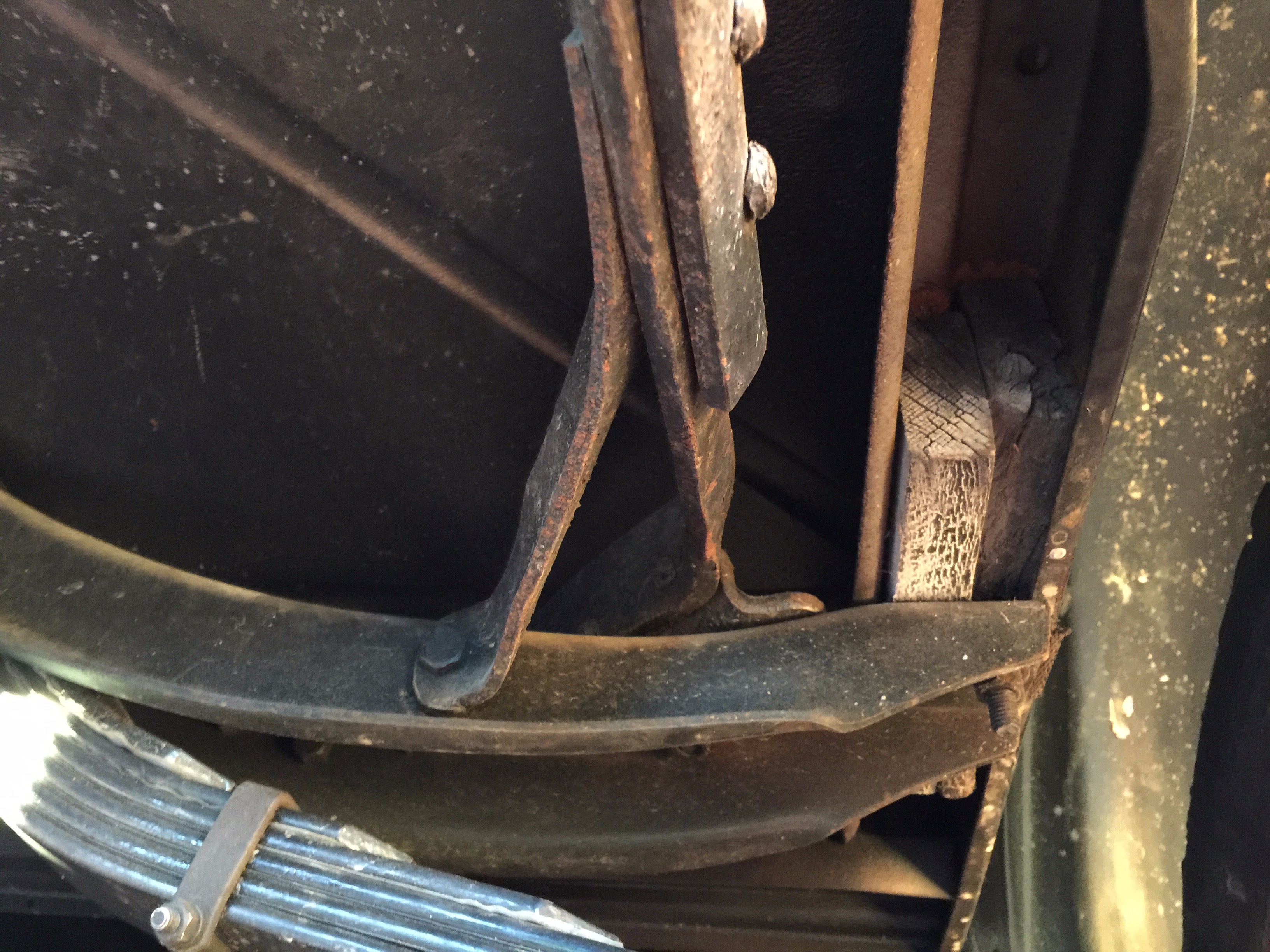

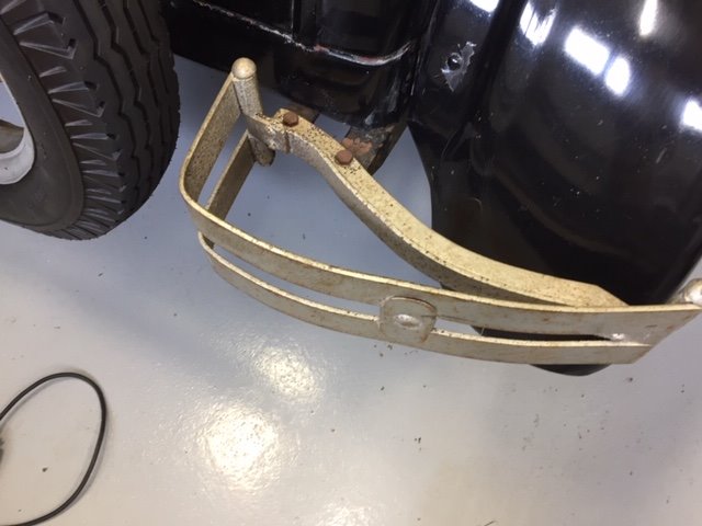

Different rear bumpers with different brackets. The photos are from a 26 that was in storage for 41 years and never dissasembled
Thank you VERY MUCH!!
The last set are the ones on this car!
I really appreciate the help!
Dear Bron:
I wonder if that last set are some kind of aftermarket set.
But they are a direct match to what is on this car, which is an absolutely original 1927 that was never touched until I started the restoration. It only has about 20,000 miles on it, and it is immaculate in every way.
This particular car was not driven after the 20K miles ran up on it, due to an ignition problem. The flywheel magnets were coming apart. I assume the owner parked it when he was told it might cost as much as $15 to get it repaired. It was in storage with the first owner, then was sold to someone else, who also stored the car without touching it, until it was purchased by my dentist in the mid 80's. He had it in storage until he decided he wanted to restore it, and I wound up with the task. The dentist's real specialty is Porsches, and he knew nothing about Model Ts, so did not want to mess with it himself. The car is now in the advanced stages of reassembly, and we had to lift the body to remove the bumper brackets (one bracket was broken from a collision, but no damage to the body or the bumpers themselves.) when we originally took it apart. I was told by a local authority here in Tucson (Ken Petrick) that these must be aftermarket brackets, since Ford brackets fit the car with no body removal or lift required, and could be installed by the dealer or owner with no problems.
Thanks again, Bron! I really appreciate the help!

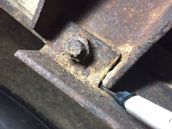

So two with the same brackets .
They do not require any lift of the body - look very closely at the front of the L angle bracket where it comes in contact with the frame crossover - the bracket is notched at that point so it sits on the underside of the frame crossover - the screwdriver blade is in the notch - you take the nut off the frame /wood block bolt and assemble at the front and work backwards with rear bolts dropping in from the top
Thanks! That answers a lot of questions!
Apparently it IS a stock ford bumper bracket. It's just that few people have ever seen them before.

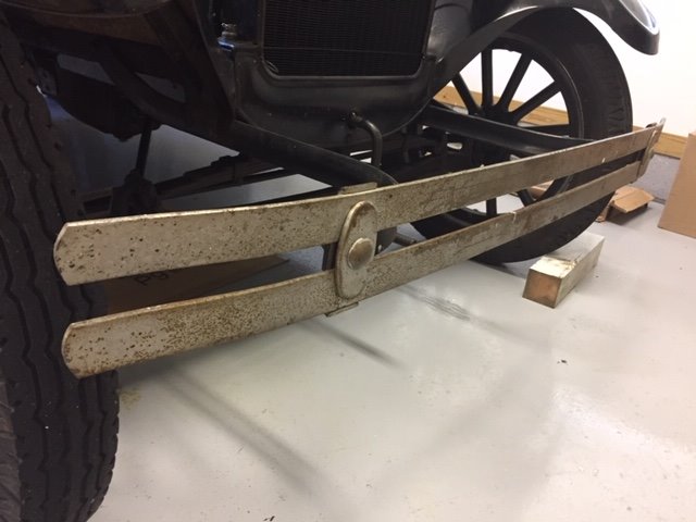

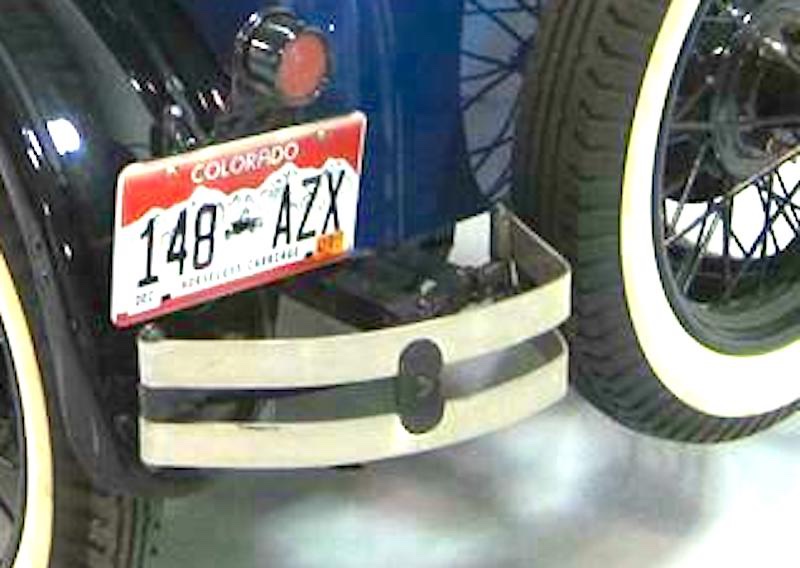

To add to the discussion here is a pic of my front bumper
and links below to Forum 2010:Bumper and a 27 coupe sold at Barrett Jackson event in 2014 . On the Forum 2010 note the Marquette ad in the Ford Service and Field paper.
http://www.mtfca.com/discus/messages/11 ... 1283355195
https://barrettjacksoncdn.azureedge.net ... 62394.html

Bron
Thanks for posting those links. Pretty clear that the rear split bumpers on the Barrett-Jackson runabout are aftermarket bars, and sure are identical to the Marquette brand.
Right on - so both my and OilyBills are Marquettes , but Marquette was smart enough to design so you didn't have to lift the body, re the angle bracket
notch. Small little thing but made for easy owner or service center installation. And only less than $9. No small change back then, but did the ladies like T's more with bumpers or not? I can only venture that the large skirts of the day were of concern not to get dirty or caught on fenders or spare tires.
