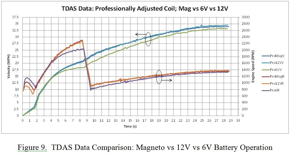

Here is measured performance data I took for three ignition operating conditions: 6V Battery, 12V Battery and Magneto using a New Day Timer and professionally adjusted coils.
Ignition operating on 12V battery was equivalent to Magneto operation when spark advance is properly controlled manually. 6V battery operation is notably degraded due to the longer coil dwell time to fire spark which reduces the available timing advance range. Some folks have reported minimal degradation with the spark advance range optimized for greater adjustment range.
