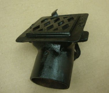

Re: What “heater” options did T’s have for the cold months?
This is what kept drivers warm in the winter

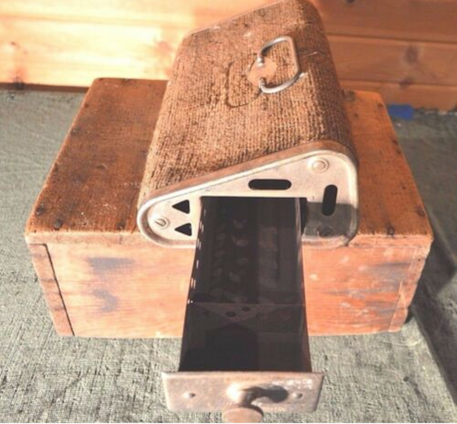

A Model T era holdover from horse & buggy days is the foot warmer with a drawer to hold burning charcoal. This isn't as rare as you might think. I see them occasionally at estate sales and farm auctions.

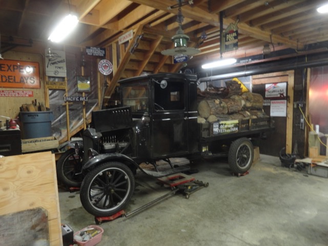

I use shop skates. Put the truck up on them, push it sideways into the back corner
of the shop, and there is sits from November to whenever I feel like getting it out
again when the weather gets nice again. I use the Swedish approach to the car hobby:
do all the heavy repairs and upgrades while the snow blows outside, have it ready to
go when the birds return to sing.

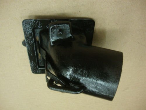

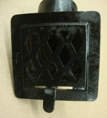

I've had this on the '19 Centerdoor for many years - works great and the floor "kick" register is on the wife's side so she can can control the cabin
temperature !
temperature !

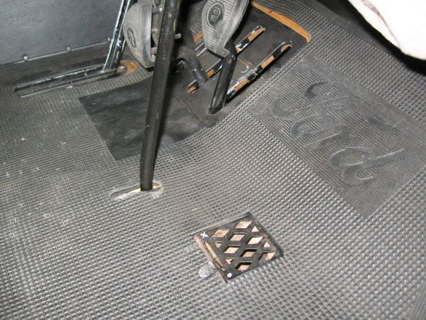

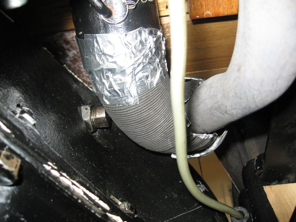

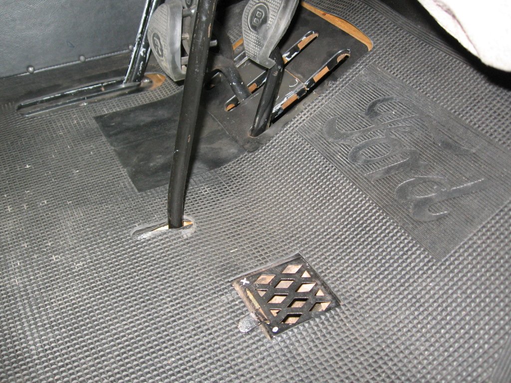

I found a floor grate with a flapper door that I liked on eBay, so I installed it on the passenger side floor board and used some of the wrapped aluminum manifold heat tubing available at most auto parts stores. I slit the tubing part way and wrapped it around a section of exhaust pipe to send the heated air into the body of the floor grate. I used some aluminum duct tape to help seal things up. The ductwork doesn't interfere with the factory carb air pipe.
Works better than nothing and looks neat (to me)!
When winter is over I remove the factory carb air pipe and install my air filter. I also remove the heater tape and ductwork, but leave the grate in the floor for an extra fresh air vent.
