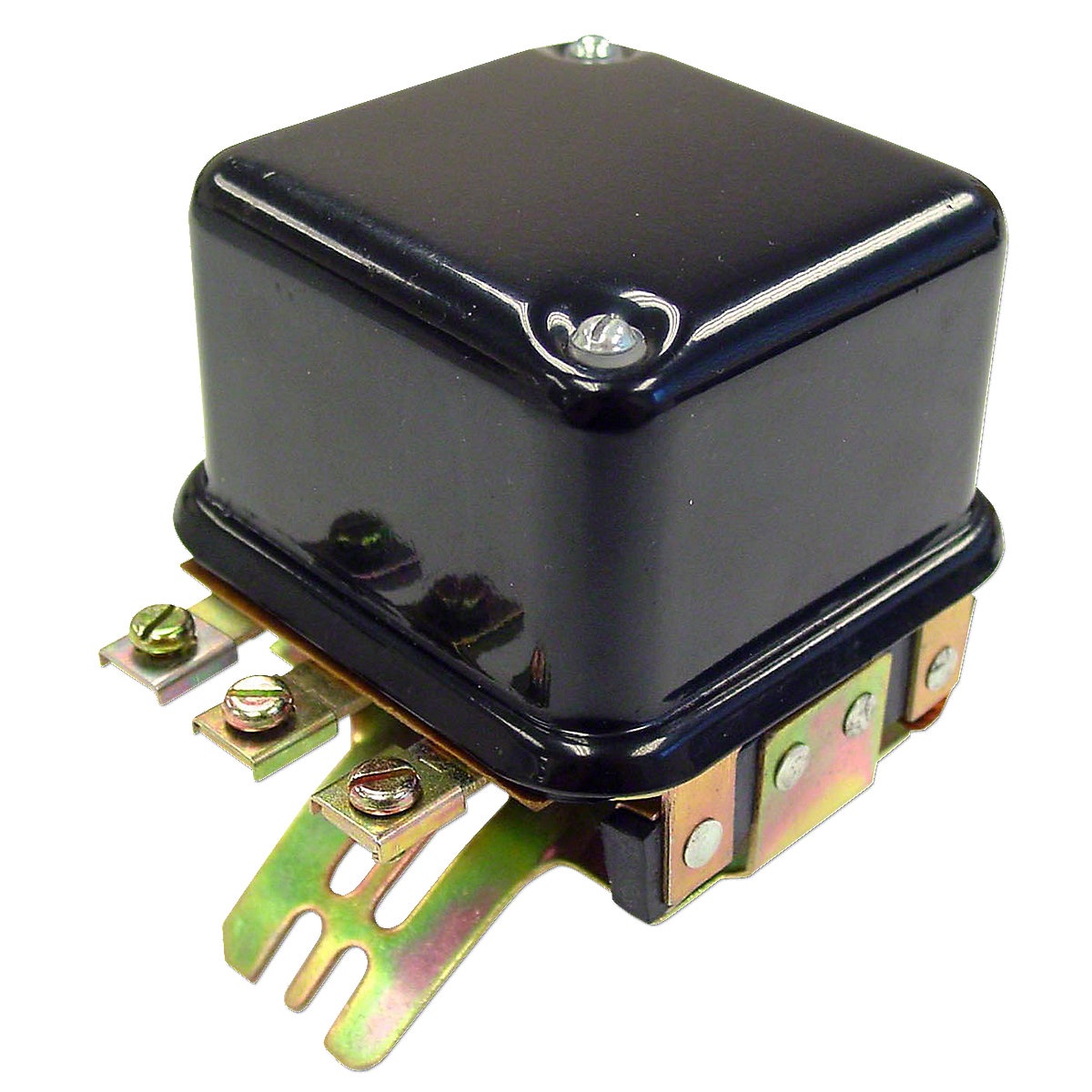

Last I heard, Fun Projects has still not rereleased their VRs for sale. I currently have a 6v system but would the following be an alternative, though obviously a non-stock appearance, for someone with a 6v system? A temporary alternative until Fun Project VRs are once again in stock.
https://www.steinertractor.com/ABC153-6 ... -Regulator
Electrical is not my thing so I don’t know how to judge this product as acceptable or not. If it isn’t, anyone have some alternatives?

The description says for use with two brush generators only, so I would say not for model T 3-brush generator.

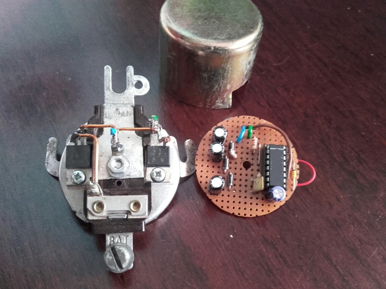

Question then can the exposed electronics be adapted to work properly - it costs $10 with $1. 50 shipping. There are many similar but this had voltage & amperage in the range.
Found this on the web https://1925modeltford.wordpress.com/20 ... regulator/
V 3.jpg (15.14 KiB) Viewed 4584 times

TRDxB2 wrote:
Sat Oct 31, 2020 1:32 pm
Frank,
I couldn't see any schematic with that link, but from what I could tell from the photograph the high-current components looked as if they may well be wired as a you would expect a shunt regulator to be.
It'd be interesting to know what the IC was* but if it were the SG3524 John E and Jim mention then the cct is probably a similar design to the one I've come up with using a TL494 (they're quite similar), so I'd expect it to work fine. At the end of the day they're just a switching regulator, which have long become a very common thing.
In terms of your other question regarding use of the existing cutout. If you were to source all components new (or were very good at removing components from old boards) then I see no reason why not - at least as far as the carapace/chassis is concerned.
You would need to remove whatever mechanical components there were inside and fit the requisite electronics. It may be possible to also utilise an existing diode from a solid-state cutout, but as I've never seen one I couldn't be certain of that (IMV you'd want to use a schottky diode). Similarly to the photograph you've shown you'd try and utilise the chassis as a heatsink for the high-current devices.
*UPDATE - I had another quick look at the link (to see if there was a schematic mentioned) and scrolled down to discover a Q&A I'd not seen previously. That seems to confirm it's the SG device, so my comments stand.
