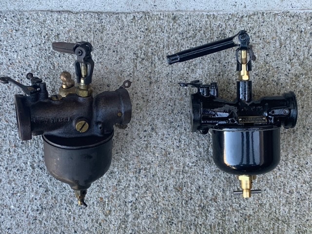

I have been running a Kingston carb (L4?) on the 13T. Over the last year, I’ve read numerous threads about T carbs and decided I wanted to purchase a new model carb and keep the Kingston in reserve as a backup/spare. Though there’s always debate and disagreement... there seemed to be a consensus some carbs were simply better performers. Though a Strom OF had my attention, I decided to contact Russ Potter and order a Holley NH swayback.
This week I received the Holley NH from Russ and I give him my appreciation for his workmanship/knowledge. I installed the Holley NH today and was actually shocked at the difference in the 13T’s performance. I know the mind can play tricks and perceive a difference in something, like performance, when there is actually little difference. Well, bring out the stack of bibles... because it was an obvious difference and I’ll swear to it!
I followed this link to adjust the Holley NH carb after installation:
http://www.mtfca.com/encyclo/holley.pdf
The carb started up easier than I expected having not dialed in the adjustments yet. It had a smooth idle and it took little time to adjust it following the MTFCA instructions. The difference between the Kingston and the Holley NH was immediately apparent upon opening up the throttle. The carb’s impact on acceleration and its throttle response were outstanding.
I’ve read in past forums where Russ dynoed different carbs on the same T engine on the same day. I haven’t run across those findings. I have found some material about cfm ratings on various carbs and the debates as to what the results mean. I also understand the Kingston was only cleaned/serviced by me versus the Holley NH being newly rebuilt by an expert. However, through obviously anecdotal evidence... I’m a believer in the ol’ Holley NH!
Anyone have a link to Russ Potter’s dyno testing or some good articles on carb performance?

I don't understand why you would want to use a 26-7 carburetor on a '13? Why not change the spray needle?

Larry,
Almost everything I’ve done on the 13T has been getting it closer to original in a series of baby steps. However, I guess in my mind if I do something which is a deviation from that process... I would hope it’s a choice which someone who owned the 13T back in the day may have reasonably made to improve their T.
The 13T already has a 1925 engine in it due to the original engine being out of commission. I would think if someone of that era replaced the engine, it wouldn’t have been an unreasonable choice for that person to put a similar later model carb on it to improve the performance. Just as, apparently, hundreds of thousands of people purchased Strom OF carbs back in the day to improve their Ts performance.
One day, I plan on rebuilding the 13 original engine. I might possibly keep the Holley NH on it; however, I could see taking another baby step and putting on a carb which would’ve went with that engine. Would a Holley G be such a carb?
I know there’s always great debates between the folks who want to keep their T purely original and those who implement more modern upgrades to enhance the performance of their T. I feel more akin to the originalists’ perspective; however, purchasing a Holley NH didn’t feel like such a radical deviation in my circumstances.

Because the casting is different...Original Smith wrote: ↑Wed Oct 14, 2020 11:15 amI don't understand why you would want to use a 26-7 carburetor on a '13? Why not change the spray needle?

You can use the 25-27 NH carburetor on your '13! I do. Just change to the earlier spray needle and 6208 clamp nut. That way you can use your original carburetor adjusting rod.

Larry, yeah I think that’s a reasonable future project. Spray needle 6213 and clamp but 6208 would be all I need, right?
