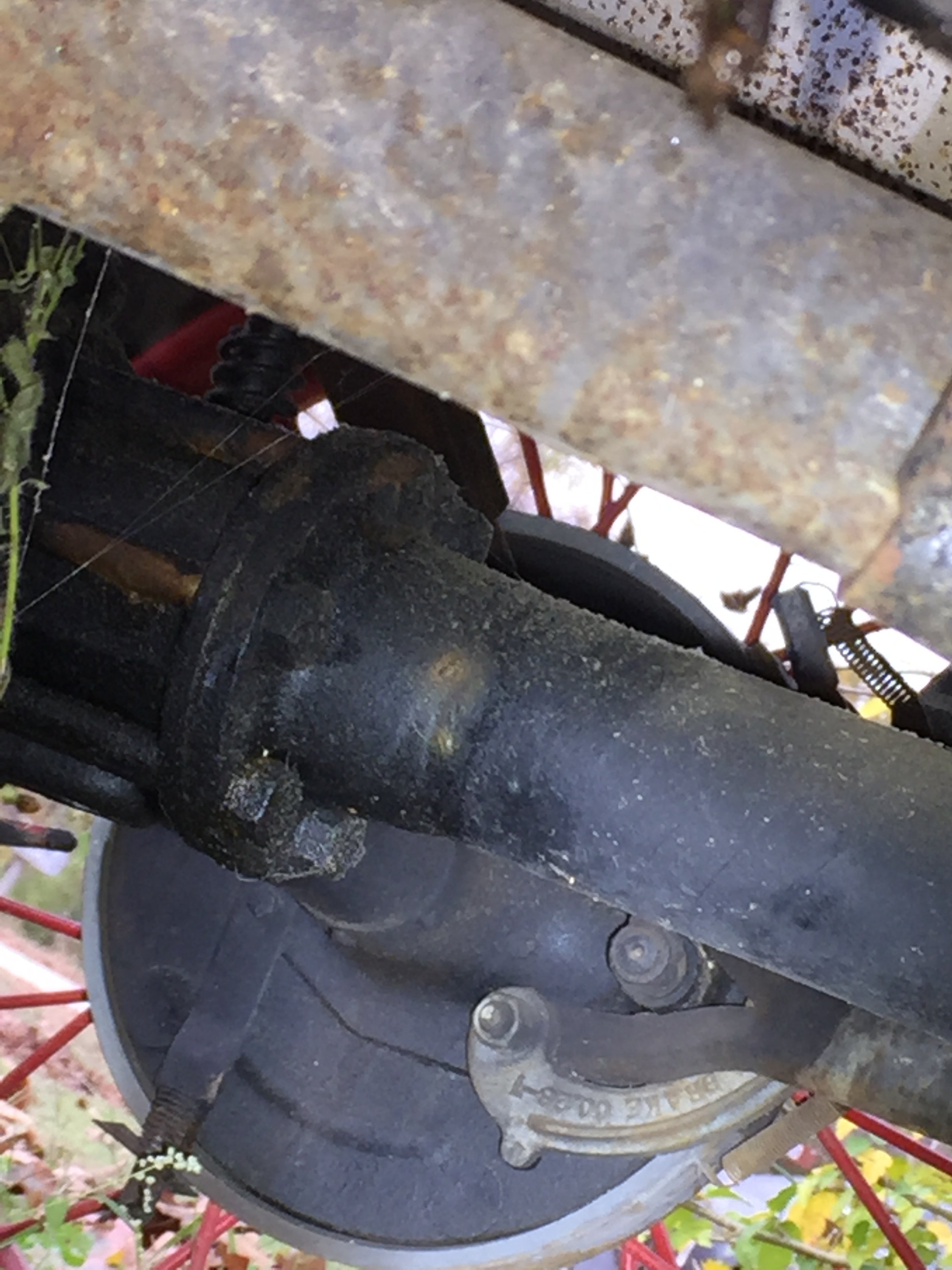

Ok, did some checking on friends cars and found what you were talking about...sort of. The rear flange isn't made from the torque tube, it is a forged flange that is welded to the tube and the bead ground flush with torque tube.
This is George Clipner's 1926 Touring, I had him take a picture of the flange because I wasn't sure what you all were trying to tell me....I also had Derrick Pang take a picture of his 1923 Touring of the same part and the same thing was noticeable.
Notice the bump on the rear flange where it meets the tube? Notice also that it only appears on the bottom of the tube and not the top because it looks smooth. That's the flanges edge, the space below that, that looks a bit darker and has a ragged looking edge is the weld...more than likely it's a brazed joint. But that's the look you get when you grind a weld or brazed bead down to make it flush. This could've been a nice clean looking joint if they had automatic orbital welding equipment back then, but since they didn't, they had to do it by hand with a torch and rod.
I don't have drawings to work from, but the torque tube wouldn't be strong enough to take the torsional stress of the tube/spool. So, the flange would have to be a separate piece joined to the tube rather than made from it.
So, I've made these correction based upon what I've been told and what I've observed from actual parts.
And the cross section. I am also showing the ball/bushing housing as threaded onto the tube, whether or not that part is also brazed to the tube I don't know, but I have seen that their are rivets staggered on the outside of the housing, which suggests that it is meant to hold the ball/bushing assembly in place.
Since there is no sign of a brazed joining of these two components, I'm inclined to believe that it is indeed threaded onto the tubes end and then held in position by the staggered rivets.

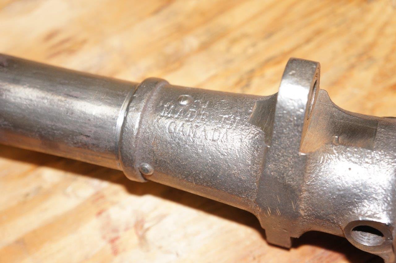

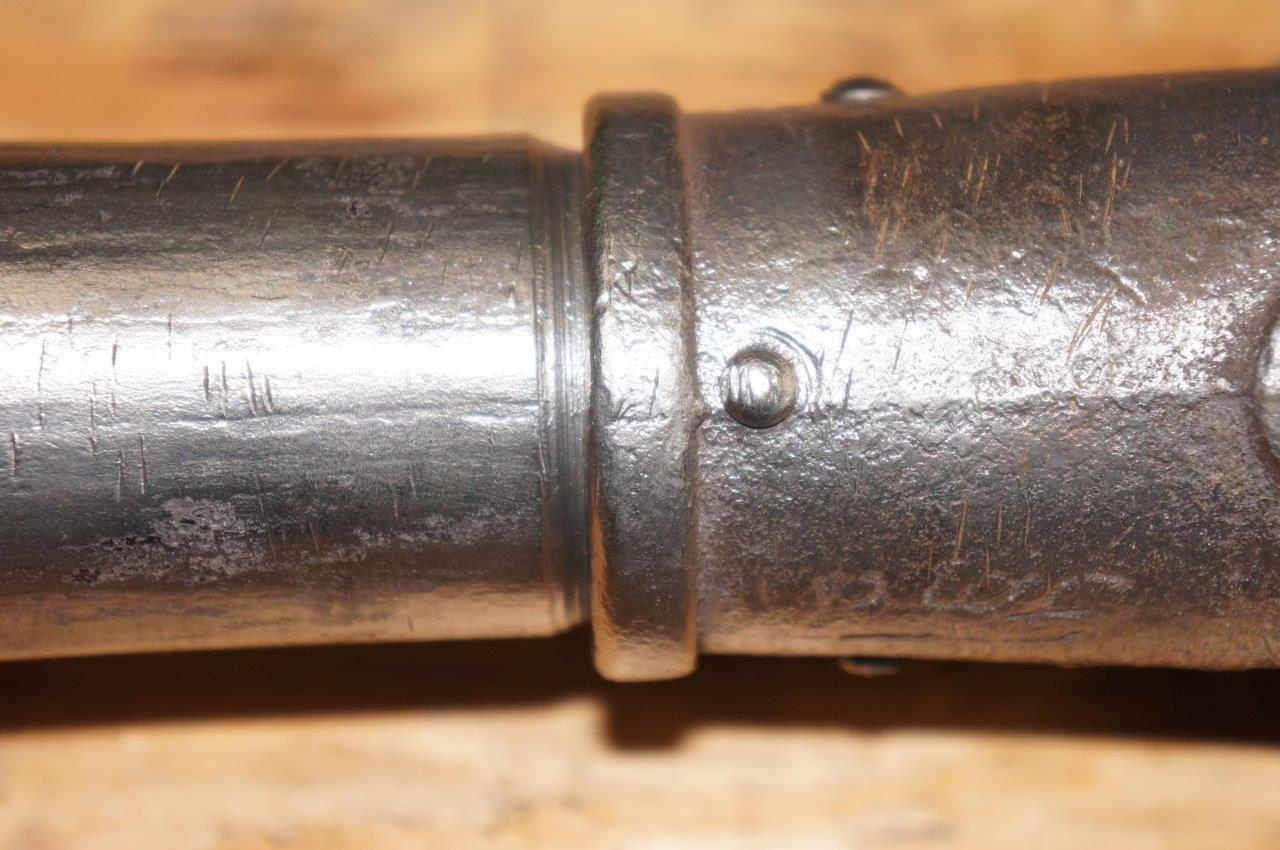

John E. Guitar
- Posts: 527
- Last Name: Guitar
- Location: Ulladulla
- Board Member Since: 2012
Re: ***1922-1927 Driveshaft Color Cross Section***
Here's a Canadian torque tube.
I'll see if I can find a butchered one in my stash and take it apart.
The threading seemed obvious on the torque tube in my 26 Tourer (the worn out car at Maryborough) as it had spun but looking at this one maybe it was an optical illusion.
