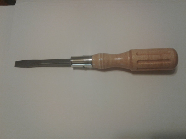

Lang's web site has a section for new products, not in the existing catalogue. They now offer a reproduction tool kit screwdriver, so I decided to treat myself to an early Christmas present. It came today:
I think it looks good.

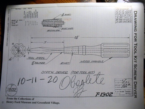

Unless I am mistaken, there is a fault in the reproduction shown. The flat point on it has been formed by dumping the blade with the square section on the flat so that the point is parallel with the faces on the square blade. I understand that on the originals, the flat tip is formed by dumping the blade with the square set at 45 degrees to flat, so that the blade formed runs diagonally from one corner of the shaft to that opposite.
Have I got that right?

Re: Do-it-yourself Santa
I think Allan is correct, here is a copy of the Ford Drawing:

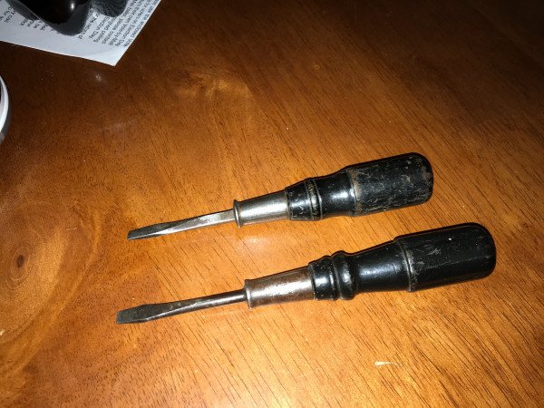

I was aware of this detail because I have replicated a few of the screwdrivers using blades from old wooden handled items. In my purchases I inadvertently purchased one blade like the one shown and didn't notice the difference until I stored it with others. My nephew has one of his workmen tun up the wooden handle blanks for me, using the same drawing as posted, and I have to fit the shafts and ferrules, mill the 8 handle grooves and stain the handles black.
Forging the blade diagonally means there is more 'meat' left to make a wider and thicker tip to the driver, and it it much more appealing to look at too.
