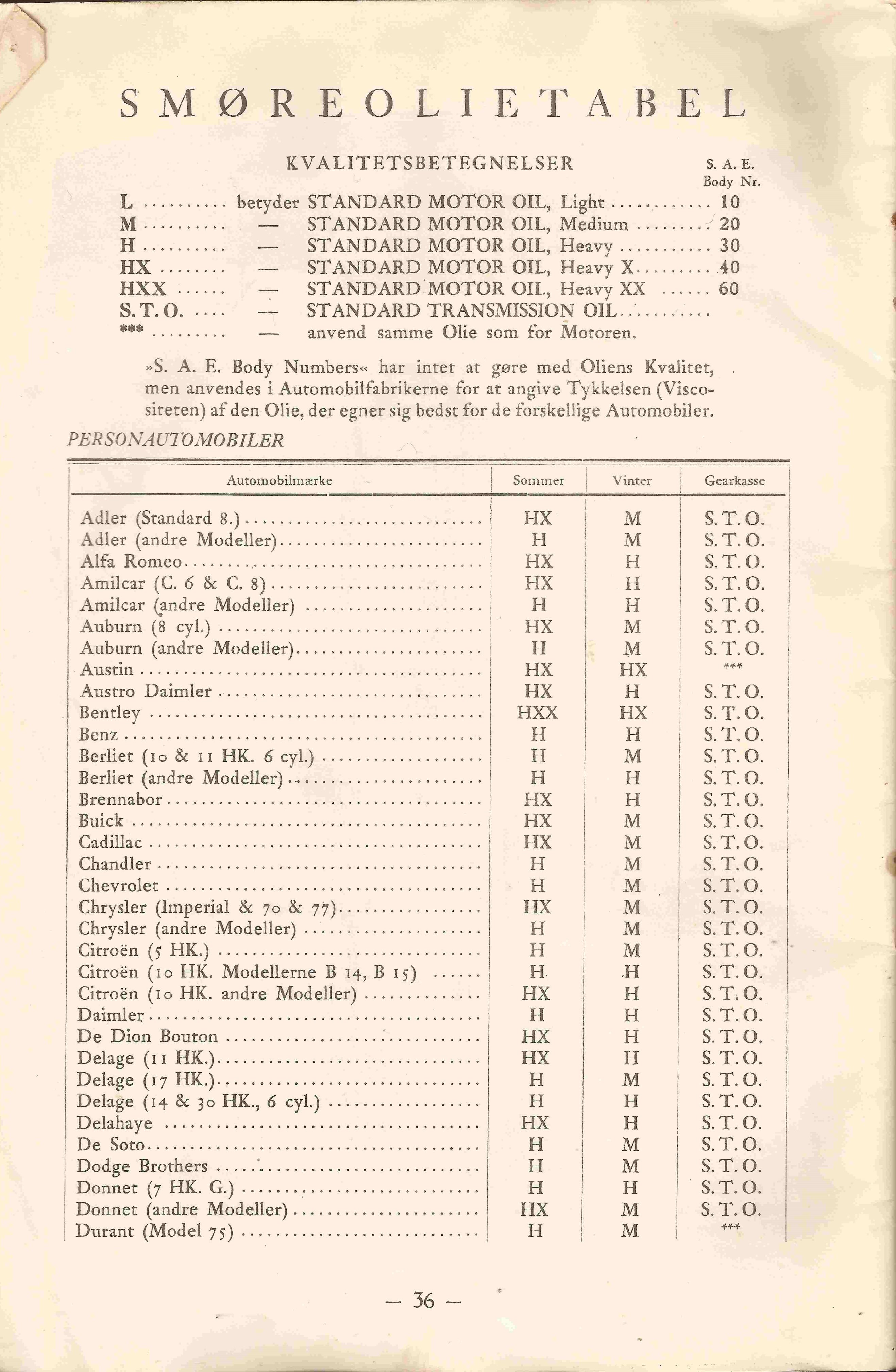

The booklet brings you through all parts of your car and how it work, and the last part of the booklet is a table showing what oil you need for your car (or motorcycle):

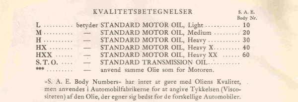

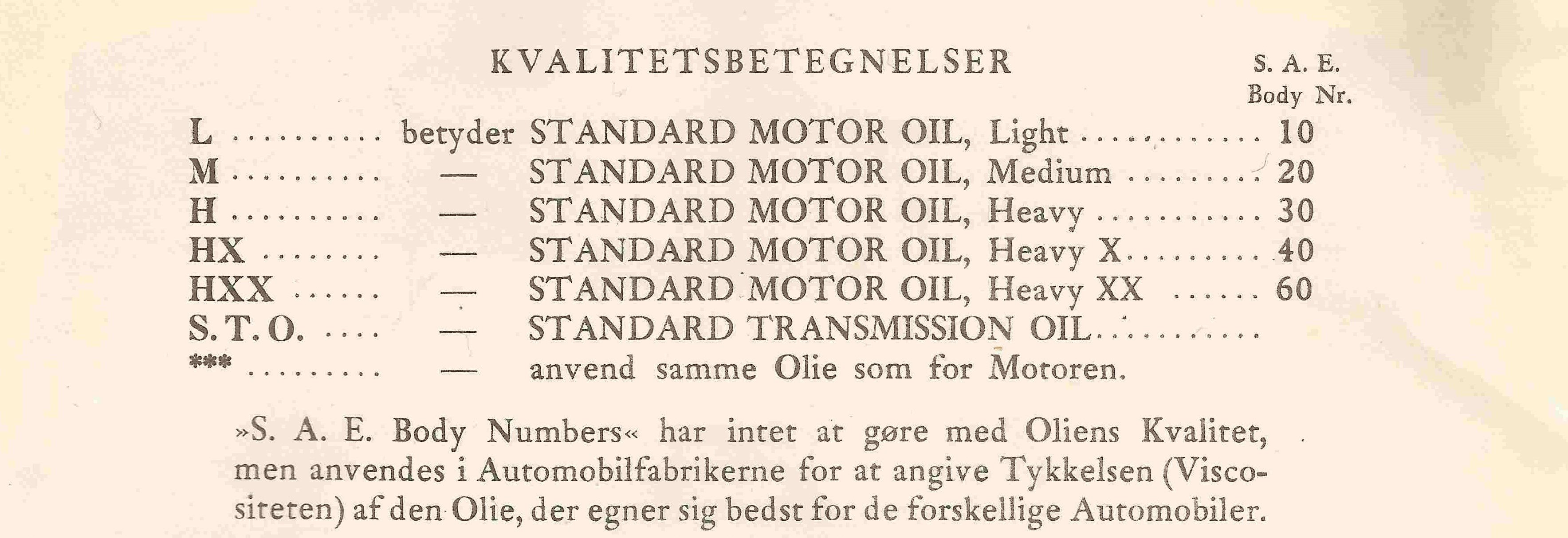

The top of this page holds a list of STANDARD oiltype and it is "translated" to the brand new - TADAAAAAAA - S.A.E visocity classification system!

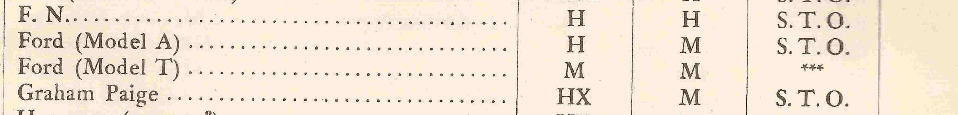

So now it is just about to find Ford Model T and that is on the next page:
SO! Ford Model T should have STANDARD Motor oil Medium = SAE 20 (and Model A Standard Motor Oil Heavy = SAE 30)!!
And that is actually compliant with my experiences that the engine have fewer "noises" when running on SAE 20 than 30, and the explanation is simple: Model T have splash lubridation and the thinner the oil the easier it comes into the bearings, which originally was intended to come from the sides and into the middle of the bearing.
OK - Now let the party begin! :-)

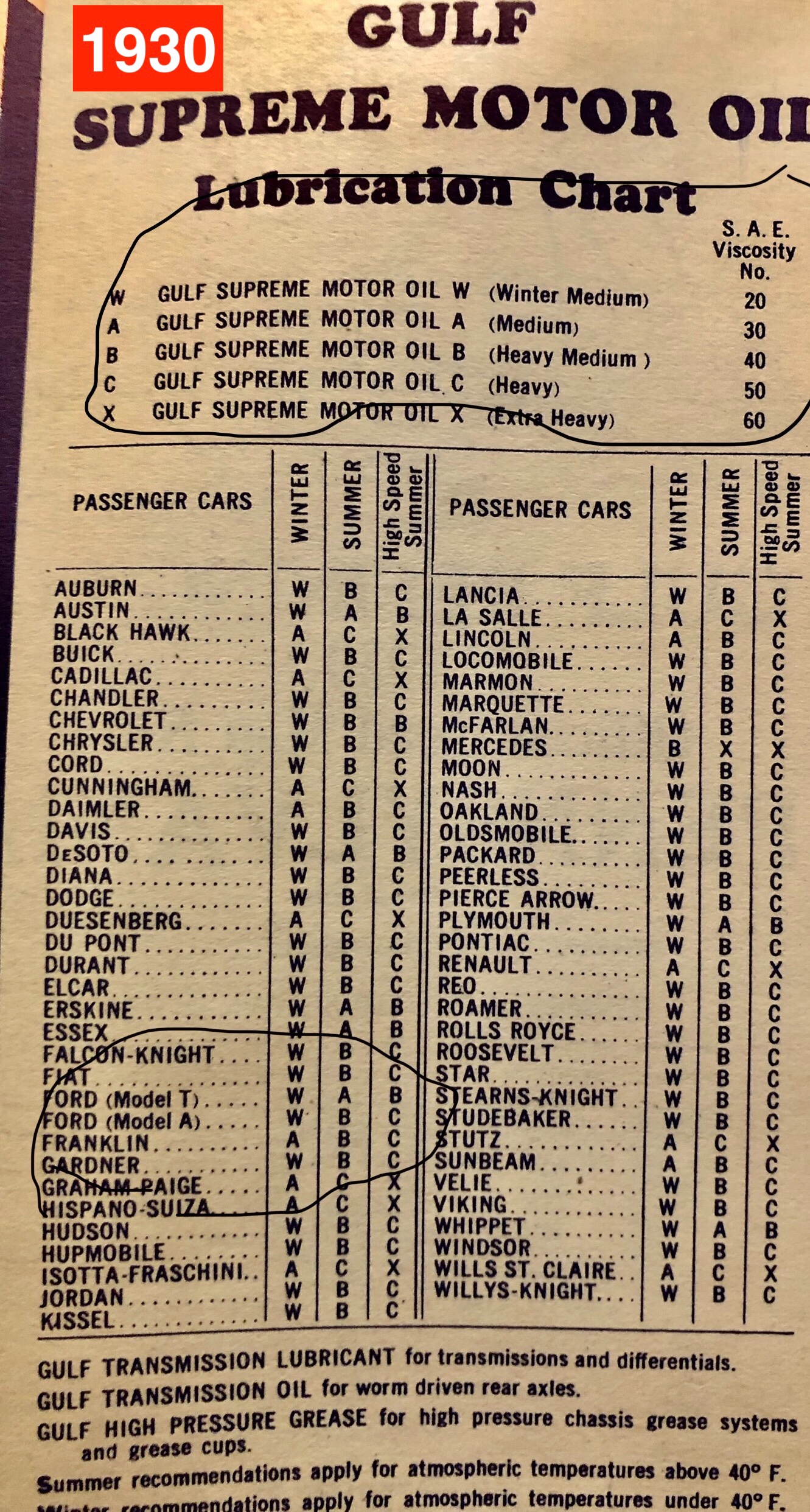

Michael
Here is another chart..... 1930.....also.
Has the Ford T using 20w in winter, and 30w in summer, with 40w for high speed summer heat.
Since today's oils are nice with multi-viscosity, for me....10w-30w has worked with my FL climate. ;)
