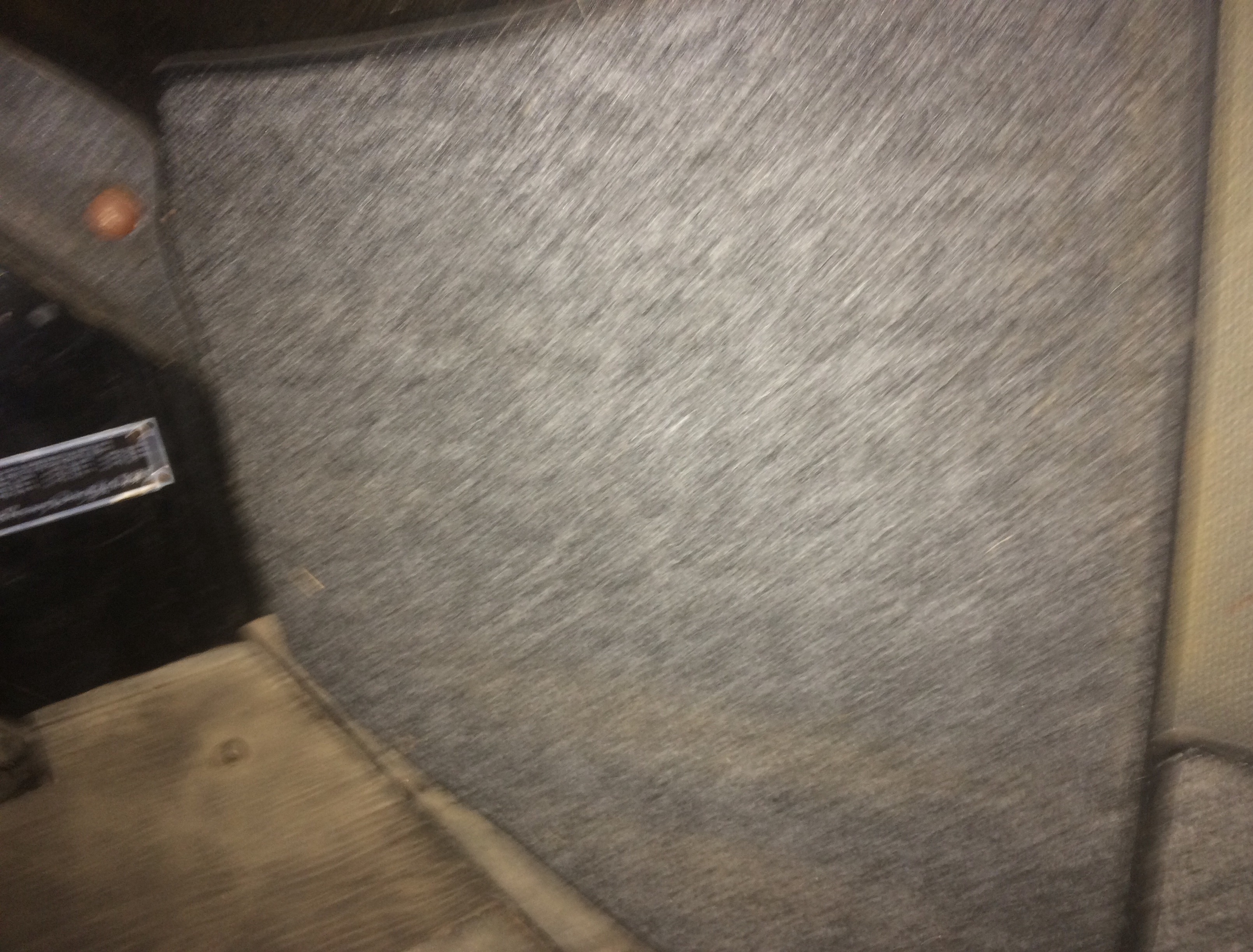

Mine is a ‘19 centerdoor so I might have wood where you’d have metal. The panels aren’t nailed or tacked but, rather glued to the A pillar, vertical wood to the rear of firewall and compound curve wood following the contour of the Cowl.

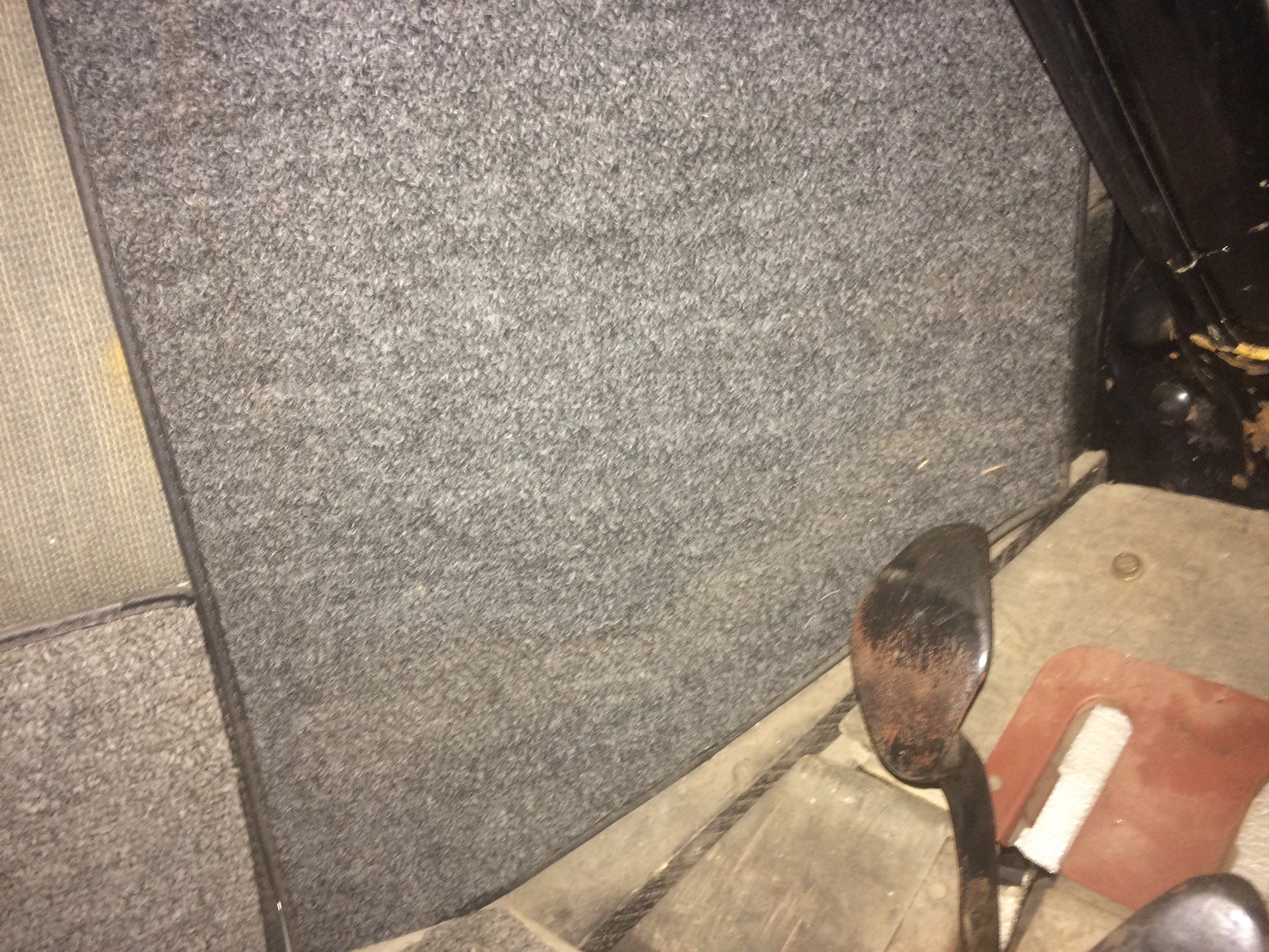

Here’s the other side. All wood is original. I’m the second owner

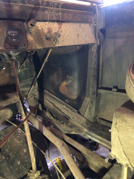

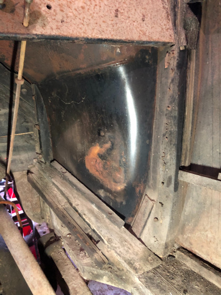

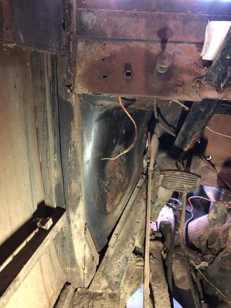

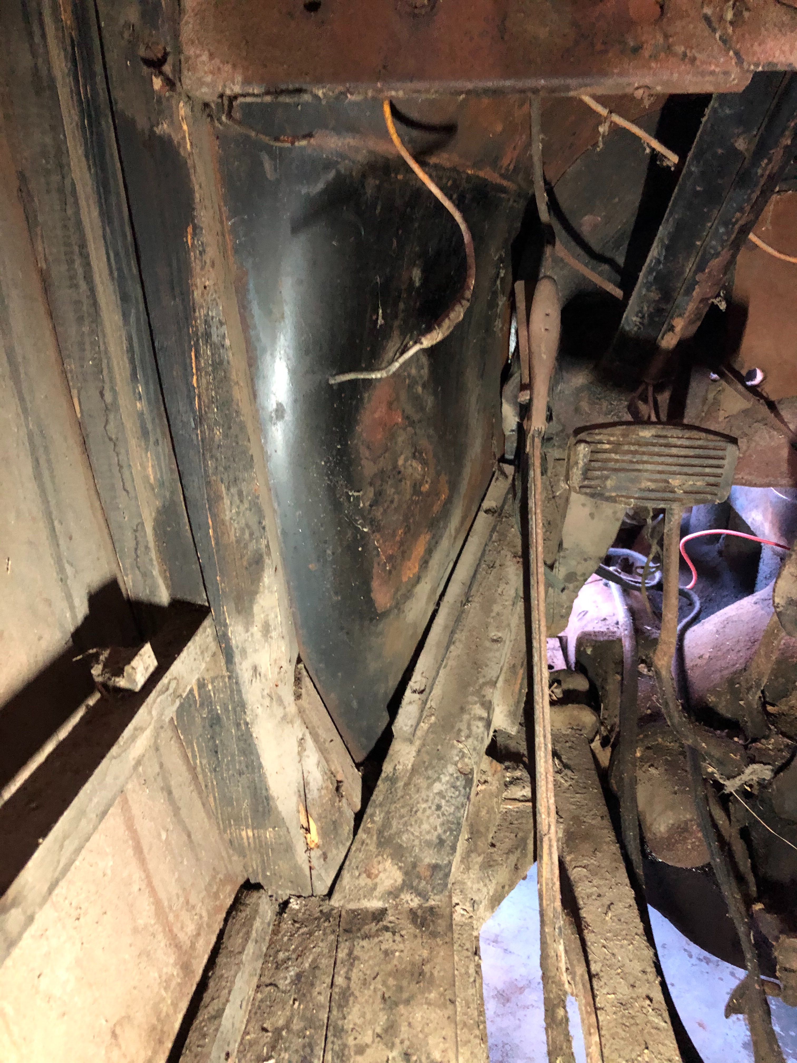

I just gutted the inside of my 21 center door. There is an oak runner about 3/4” square along the deck, and again up firewall
Here are pics of left and right side, with one unobstructed view of the area in question on passenger side.

Thank you. You have confirmed what I suspected all along. There is nothing for the top of the kick panel to attach to. It only attaches in three places: Pillar, Floorboard riser assembly and the cowl frame assembly.
I also confirmed this two days ago when I assembled my original wood and replicated pieces of this area together and found the original holes and mounting nail locations.
