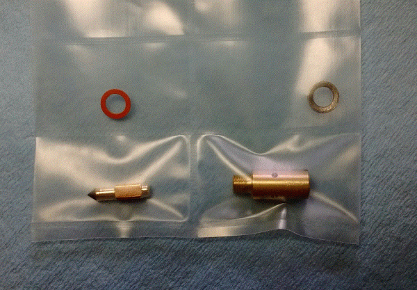

12+ volts and a float valve which is not restricted; and the two standard valves sold by dealers (grose and needle) have a greatly restricted hole for the fuel to flow through into the carb. They do not flow fuel nearly as well as the original one did. This restricts top speed and limits the length and steepness of hills that the car will climb.
If your problem is fuel starvation, this is the only float valve available today which has the correct throughput and will solve that problem:

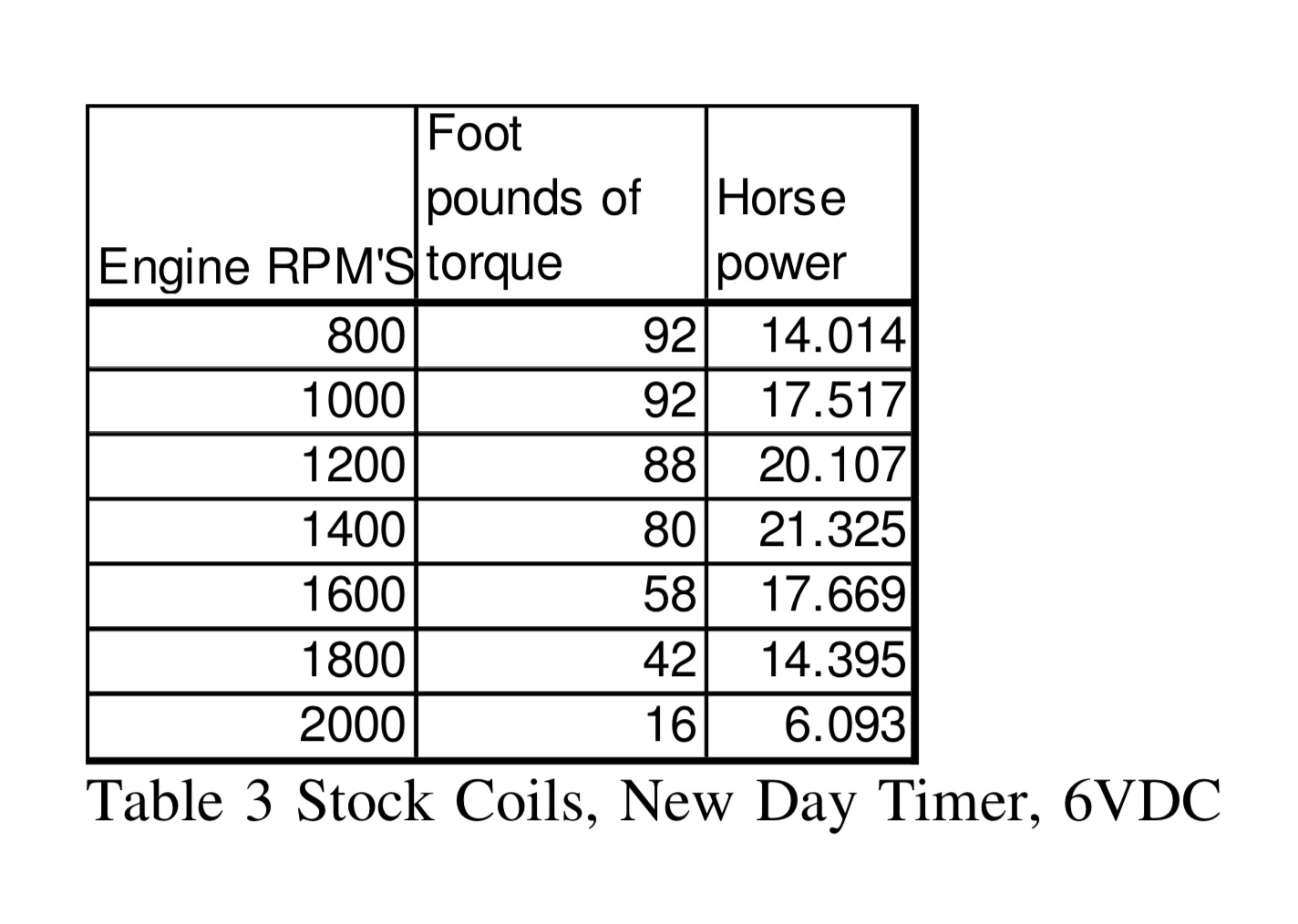

Ron Patterson
Re: 13T - Lack of Power Above 30 mph
Darin
A few years ago I wrote an article about what causes the problem you describe.
Here is a link: http://www.funprojects.com/pdf/More%20o ... Timing.pdf
If you read the entire article you will see what happens when running a Model T with a 6 volt battery.
Good luck
Ron Patterson

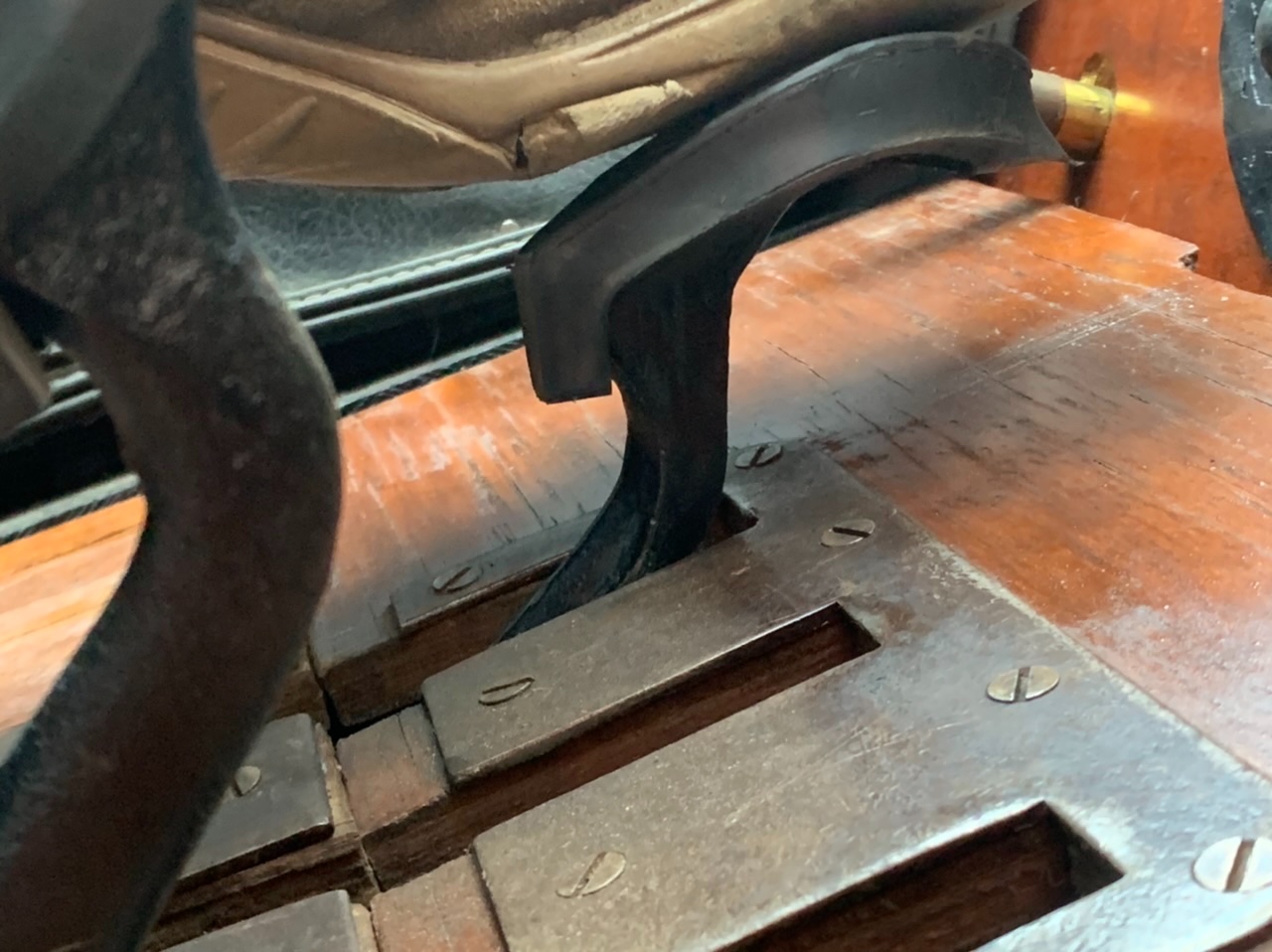

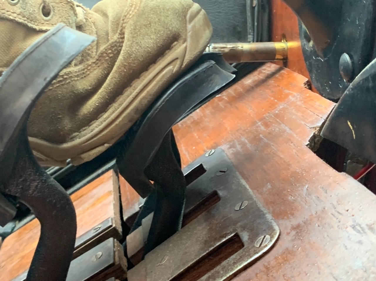

Do you know what the band linings are?
When you are seated in the car and press the pedals, how far are they from the bottom of the pedal slot in the floorboards when they are bottomed out?
Model Ts like quite a lot of room there. The pedals can safely go to within an inch - maybe a little less - of the floorboard. Keep the bands as loose as they can be without hitting the floorboard or slipping. In the case of the clutch pedal, the limit is when the link goes over-center and holds the pedal down. If that hasn't happened to you yet, you'll hate it when it does.
If the linings are super bullet-proof linings like Kevlar, they should be set up extra loose. The Kevlar doesn't wear like cotton and a sloppy-loose adjustment of Kevlar will stay effective for thousands of miles. No matter what your linings are, make it a habit to adjust then a little at a time rather than a bunch all at once. It's a temptation to make them a little snug to gain more miles between adjustments, but honestly, you will only succeed in shortening the distance 'til you need to reline them.
Kevlar is the worst culprit, if they are tight, they will drag and heat up and bind and the car will struggle harder and harder to keep going. If your drums don't explode, you're lucky, you lived another day and you can just slack off the adjustments.
Keep them as loose as possible without slipping. You'll go faster, dive deeper and come up drier.

I don’t know what the band linings my grandpa installed were; however, I will tell ya he had a set of Scandinavia linings in his parts box. I know that doesn’t mean that’s what he has in there but it seems to me a lot of folks become creatures of habit with their T with things like linings.
As far as my pedals, I’ll post pics. But my clutch pedal basically can touch the top of the slot with solid pressure. The reverse maybe an inch away and the brake pedal creates a steep angle but maybe an inch or so.

- Posts: 4389
Re: 13T - Lack of Power Above 30 mph (Progress made!) and (just added) Mag test result

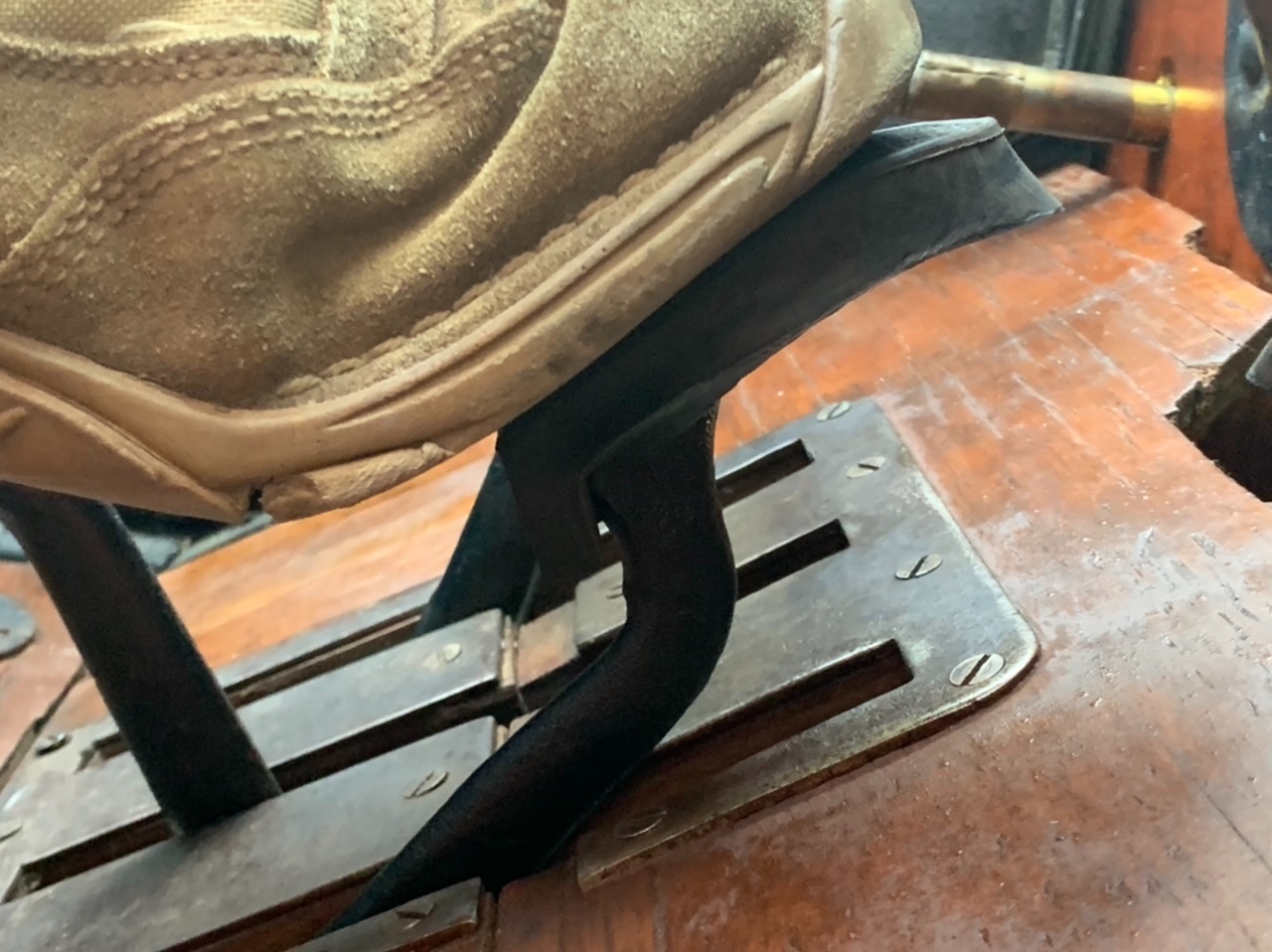

I don't know from memory, but in the photo it looks like the metal pieces on the floorboards may be placed incorrectly? The pedals due to positioning do not fit evenly, even though the slots on the metal pieces are made evenly. You should have a bit more slot above the low pedal. It should be able (with very loose adjustment) for the pedal itself to hit the floorboard. As it is, the arm hits the end of the slot with a good inch of travel not used.
Perhaps the long slots go on the upper board, and the shorter slots go on the lower board? I am not sure about that, so hopefully someone with a better car than I can elucidate us.

Steve - I’ll send a pic probably Tuesday when I have a break from work next.
George - I’m very concerned with the safety issues. The issue with speed is I want to ensure the T is performing properly... I know it’s not when I could barely get over 25 mph. So I don’t want to run like a scalded dog, simply want to know the T is in proper condition. Terrible story about the fatality T rollover.
Wayne - I have no idea about the pedal positioning. All I know is when I push them, the correct things happen. Would love to learn if someone has input on the pics I submitted.
Darin

- Posts: 4694
As to the slots in the floorboard. Sometimes the pedal shafts can become bent from use over the years and also some reproduction pedals such as Rocky Mountain Brake pedals can be slightly different than the original pedals. Another thing is when the cams on the side of the transmission or inside for the low gear become worn, the pedal must be pushed farther in order to move to the side and compress the bands. This could cause scraping on the sides of the slots.
It would be good if you can find a local club and perhaps someone who lives in your area to become a mentor on how to drive and how to adjust the T. Usually slowness is caused by either ignition or fuel problems. Sometimes by low compression if the rings and or valves need work or replacements. Someone who can drive your car and listen to it run and is knowledgeable with Model T's would be a good friend to have. Some day, you can pass it on to other new owners. The Model T is not as fast as newer cars, and the top speeds are much lower. They also slow down on hills so even a slight grade could affect your top speeds. If you lived near me, I would come out and check your car. The speed of a T can even vary with the load. Sedans are heavier than Tourings and Tourings are heavier than Roadsters. It can vary with added passengers. I have a hill I can climb in high near my home and I use it as a test to see how my car is running. On that same hill if I add 1 passenger it will barely pull in high and if more than 1, I need Ruckstell or Low. It would even help if you could drive another stock T and let the other driver drive yours so you can compare.

Scott
Do you have a part number and supplier for the Full Flow Float Valve with Lead Washer? I think it would help my 27 roadster pickup.
Phillip
Phillip

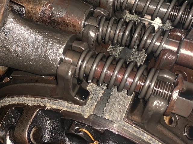

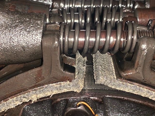

Re: 13T - Lack of Power Above 30 mph and Pics of the bands
I was able to get some pics of the bands today to help determine what type they are. Do they look like the Scandinavian type?
I don't know if there's a part number, but Scott is the supplier.
