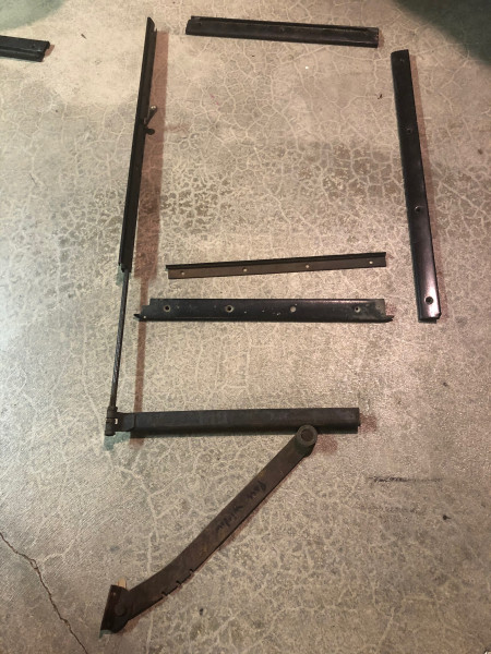

Here is a photo of the hardware I removed from my ‘24 coupe. This was quarter window on the passenger side. I have a couple questions. Is this all the hardware? Is there a spring for the arm with the roller? Does anyone have the latch and window tray for the drivers side? I think the quarter window hardware in a 4 door maybe similar. Anyone with experience with this would be helpful. Thanks! mike
- Posts: 4531
Re: Quarter window hardware questions
I have a 24 Coupe I restored a few years ago. As best as I remember there is a spring that’s attached to the the arm with the roller that helps in raising the window. I was lucky enough to have all the inside trim and hardware still in my car. Good luck in finding the other trim you need. There was a 24 Coupe body that came up for sale several months ago in the classifieds. Maybe it didn’t sell and it could be a resource for parts.

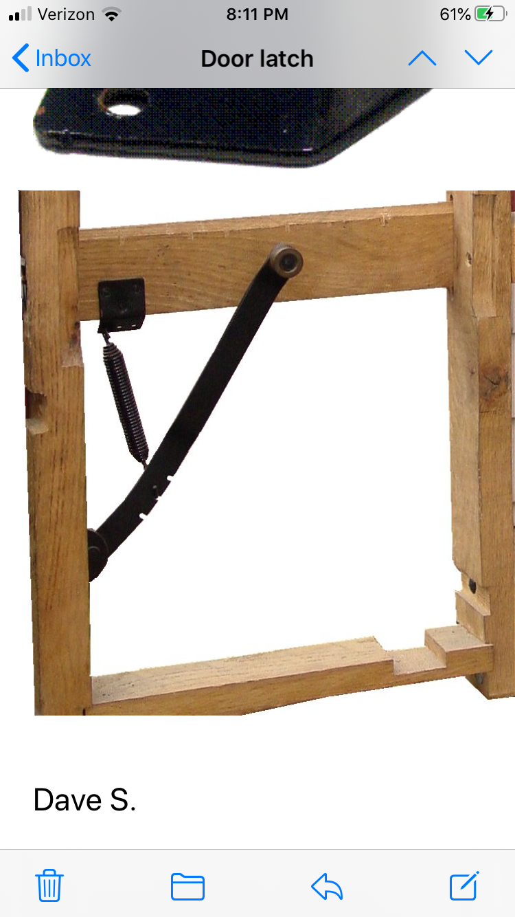

That body sold, too far away to get it. Here is a photo of the spring set up that Dave sent me.
