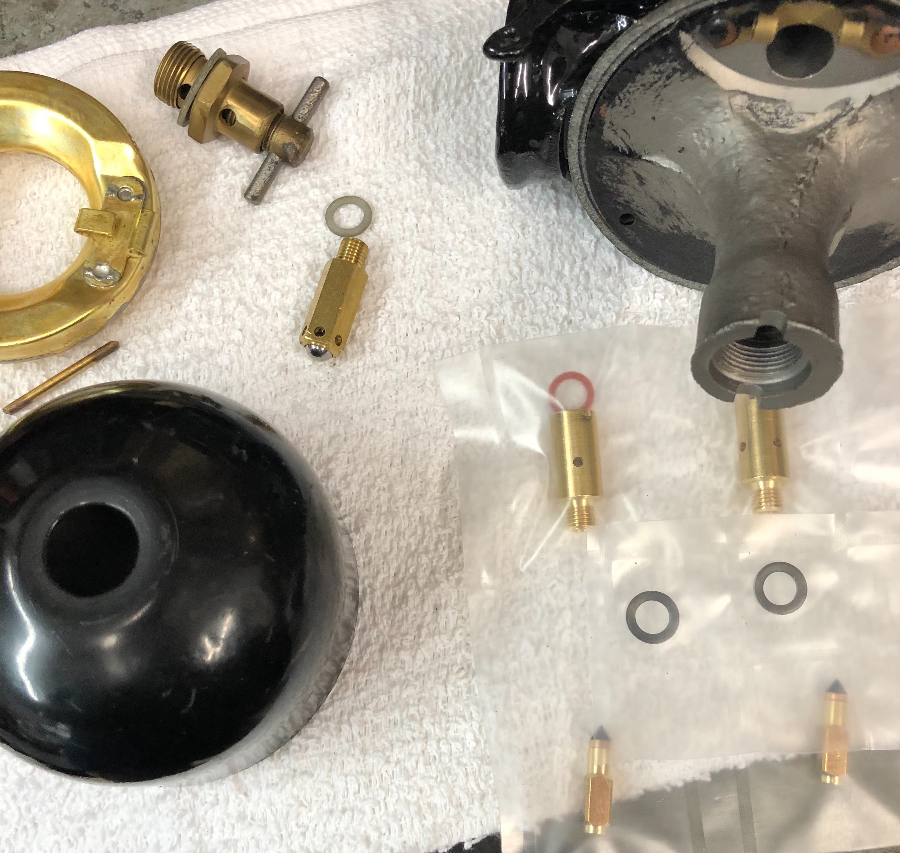

Just received some new float valves from Scott Conger. These have larger dia. opening in the seat and come with new Vitron tip needle valve and special cupped lead washer to seal the seat in the carb well. Sure like the quality of work, and bet this NH will work well, without leaks!
This carb was completely rebuilt by another, but came with a Grose valve, ball type, that IMO are worthless due to stopage and leakage.
The new Full Float is in the lower right.

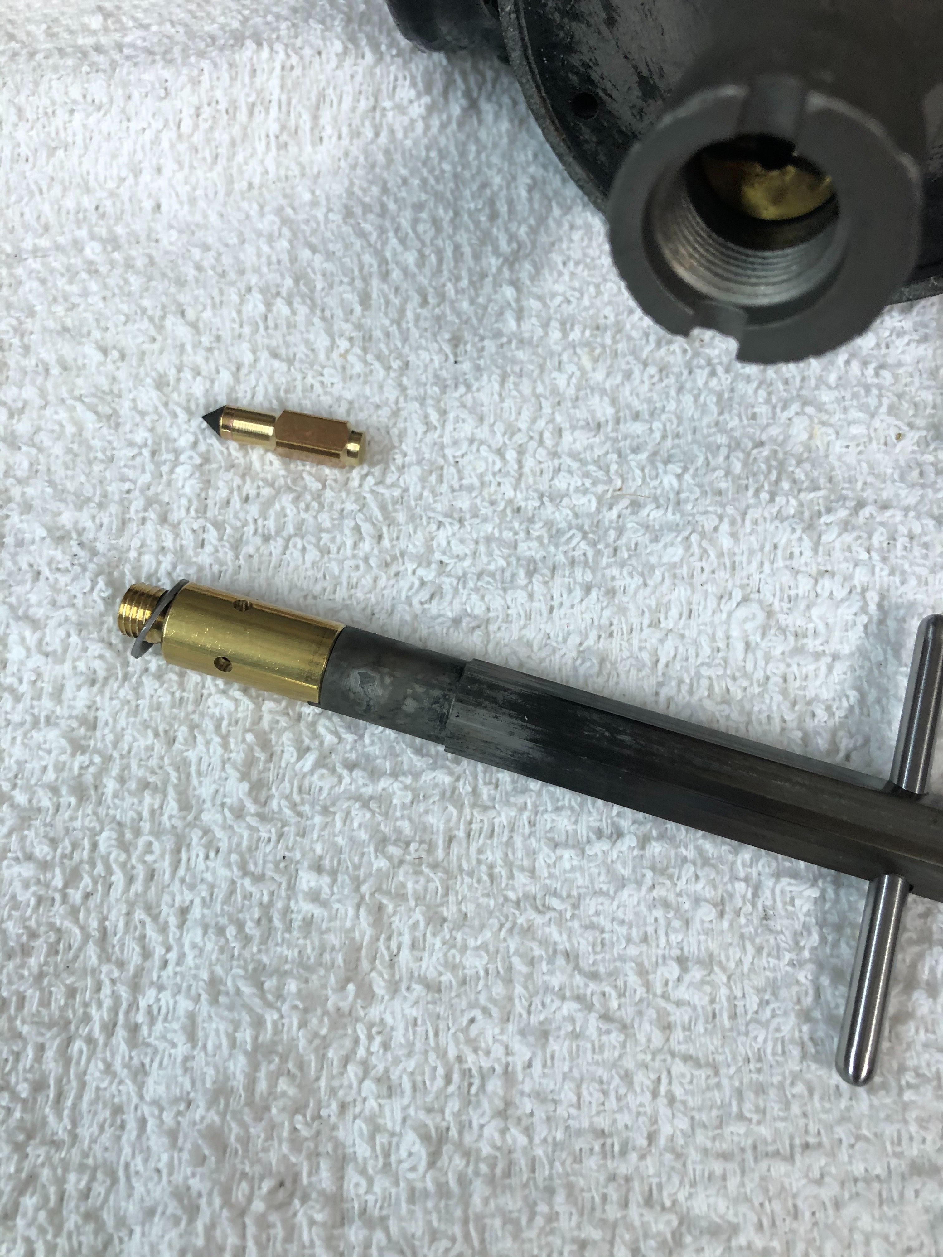

Got his available seat tool , works fine, nice tool!

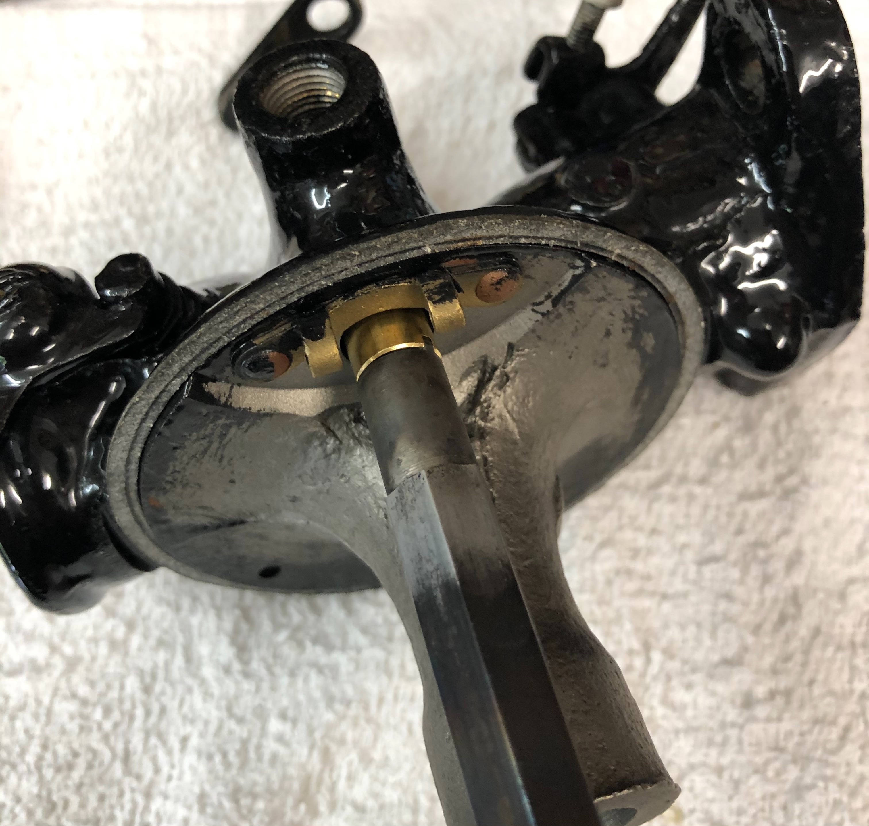

Inserting the valve seat.

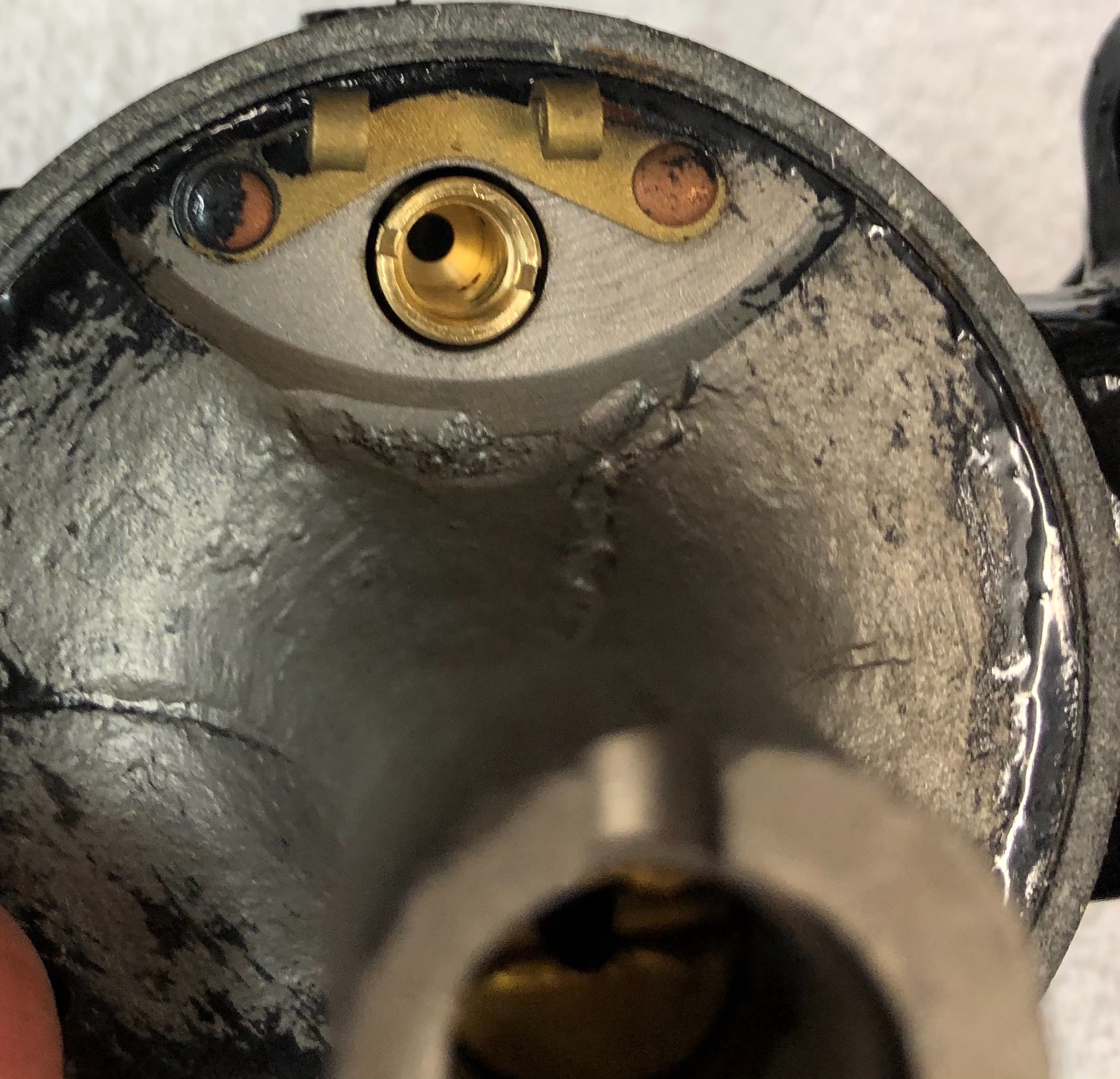

Now one can appreciate the larger dia. of the bore of the seat, full fuel flow to keep the carb bowl topped off, when the engine demands full support from that NH :)
