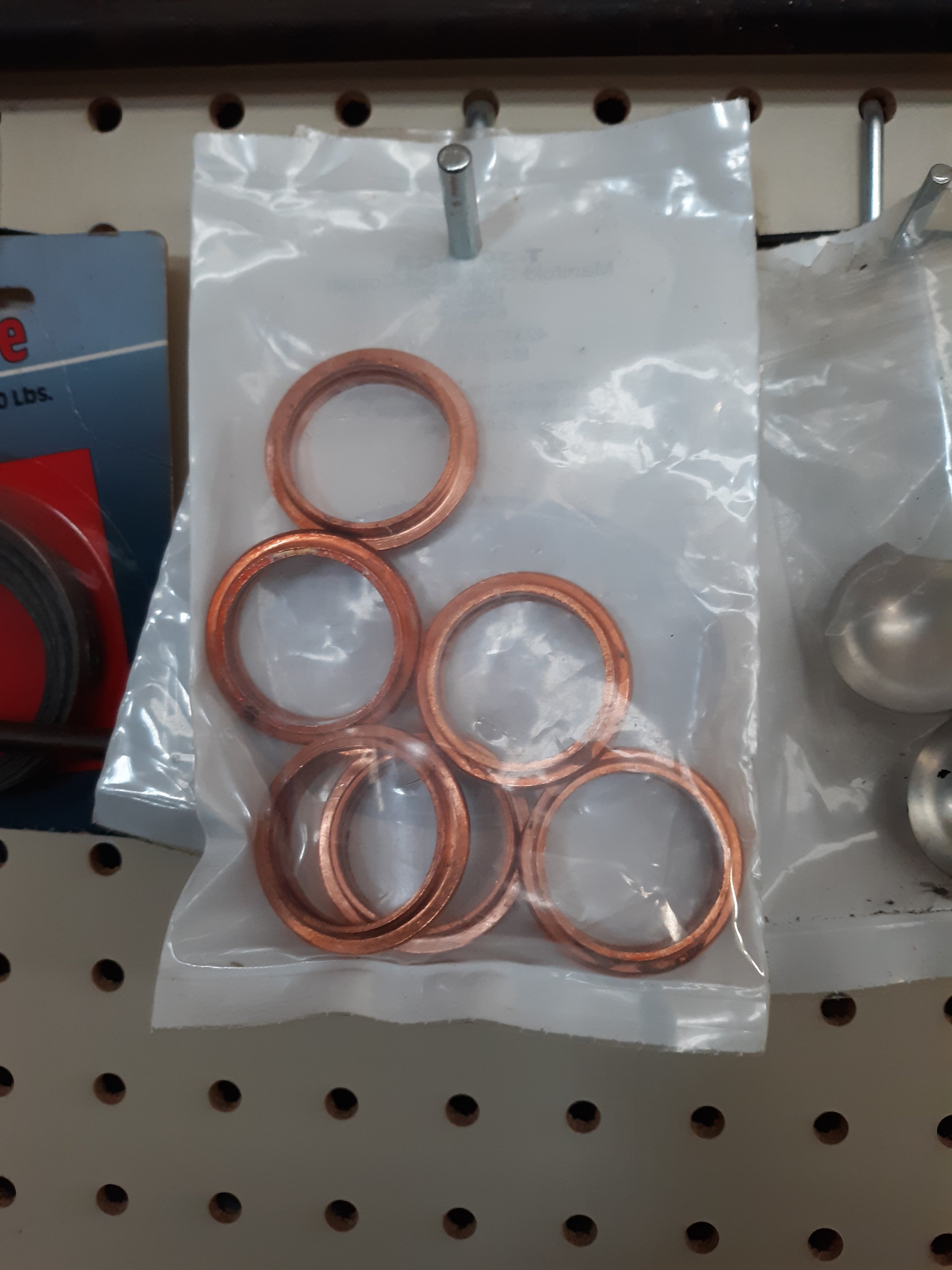

Poisonnally I prefer this type...IF you can even find them. Bit pricey, but I find them to really work well.
Snyders still might.."T-3063-CR"...around $28 a set.
Couldn't find them at Langs.

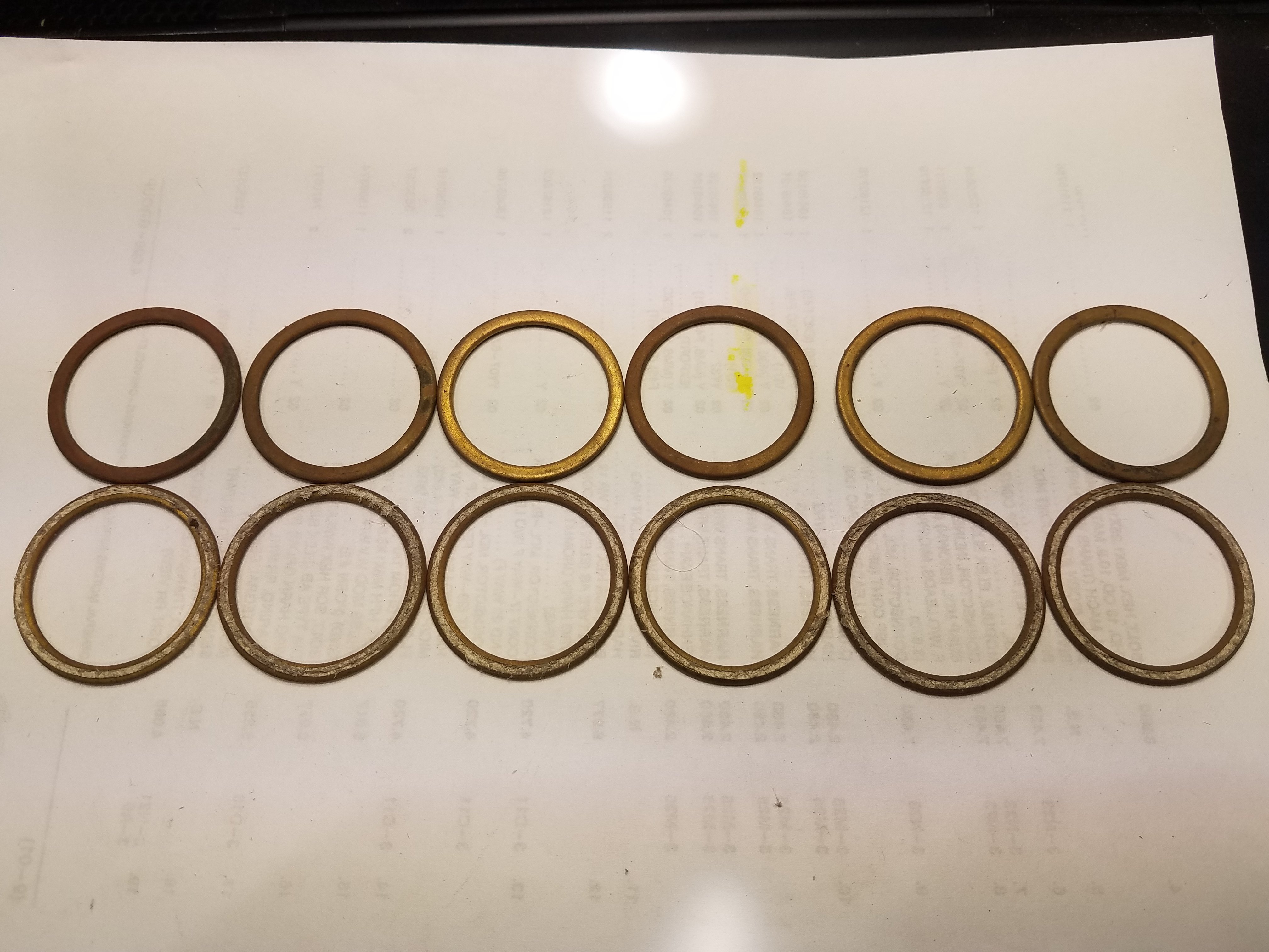

Just for reference, these are what original Ford NOS units look like.

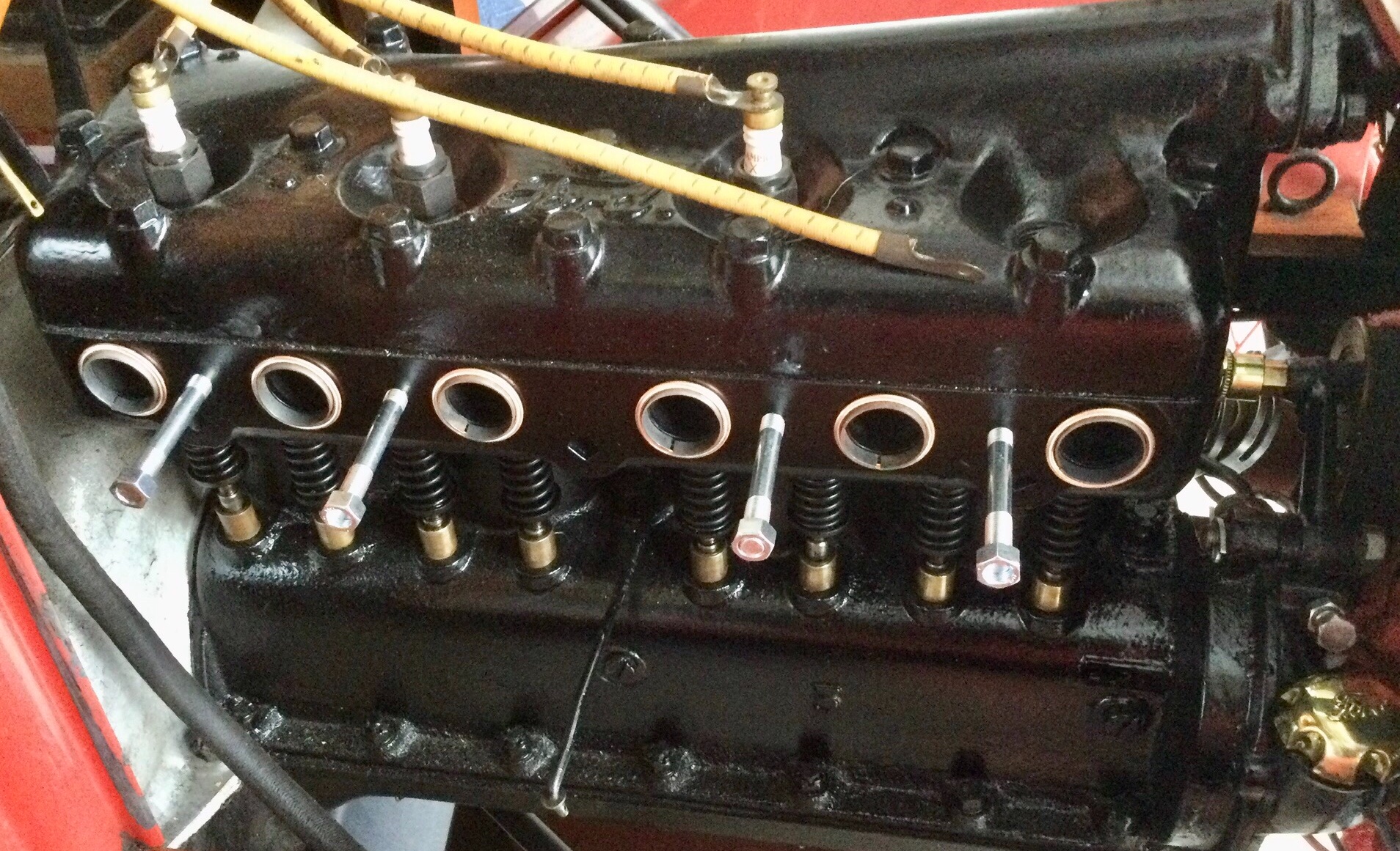

I hang mine from the sleeves that are installed in the block. I also "glue" them in place with a dab of grease, just to keep them from getting displaced by the slightest bump. Yup, the grease makes some smoke on a first start, till it burns off. But, what's the fun if you don't have a little smoke?
Tighten the clamps down very gradually, alternating from one clamp to the next in repeated steps, so as to pull the manifolds down evenly.

Great info, thanks for the pictures! I will put them in the block first.

That's just but one of several reasons I like the "all inclusive" copper rings I posted pics of up above. Just stick 'em in the block and go! Very easy, and they seal absolutely perfectly. To me, this is a case of "you get what you pay for". Good quality and good service.
