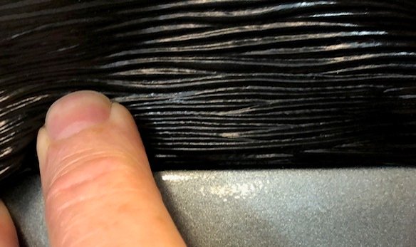

Seeking a sanity check on attaching long grain fabric to 26 Tudor wood roof frame. Don't want to do this twice.
1. Is it best to use a tack strip or just nail directly to frame and add hidem over it?
2. Fold fabric over it self to create double thickness with or without tack strip and cover with hidem?
Pictures:
1. Single layer of fabric.

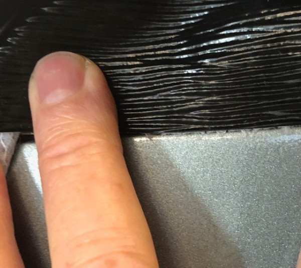

2.Double layer by folding fabric over itself.
Long grain double (folded over) layer no tack strip.jpg (80.59 KiB) Viewed 3812 times

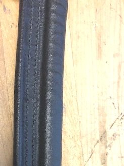

3. Hidem that's tacked over tacks holding fabric to frame.
Hidem strip.jpg (25.23 KiB) Viewed 3812 times

Stretch, tack, sealant along the edge then hidem welting. It would be hard to pull tight and tack with edge folded over. Nailed to frame, no added tack strip. Unless you have a heated space (mean on the hotter side) might not be the right time of year to do top fabric stretching. google Youtube on replacing top on vintage cars.

The binding shown is not what I know as hidem binding. The clue is in the name. Hidem binding has two rows of stitching either side of two raised ridges which carry a round plastic bead. These beads are lifted at installation, tacks driven between them, and then the relaxed beads hide the tacks. The binding shown would be installed with upholstery nails which are not hidden.
Someone may be able to shine a light on when hidem binding was first introduced, sometime in the 1920's I believe, so it may not be authentic on earlier cars.

When I installed the top material on my 24 Coupe I pretty much did what you stated in your no. 1 way to do it. Stretch the material to the edge of the wood and if need be lap it over a bit. Then take a sharp knife and evenly trim the material as necessary. Remember it’s OK to lap over the material. You can trim it nice and even later. The welting I used is what Allan mentioned. That’s hidem welt.
After you trimmed it then use the hide em welt and tack between the welt and let the welt close over where you tacked. It will make a nice seam after you get through.

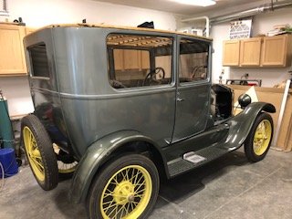

I have both versions and the one you noted did come with the top kit from Cartouche, the picture is what I got from Lang's.
26 Tudor.jpg (26.89 KiB) Viewed 3782 times

Dwight, the binding you show in the first post is called “ wire-on”. After tacking or stapling in place, it is folded over, showing a nice finished black strip.
I believe it’s later than model T production, but I’ve been away from upholstery and top work for a long time. Pretty sure it’s more of a 19030s and beyond product.

Well, my '26 Tudor rain gutter covers will fit over the ends of fold-over welt, but not Hide-em welt. Fold over also provides a more water-proof welt, as you install it with the small bead at the bottom, so water just flows over it.
I've not heard when fold-over came into use, that would be interesting to check out. Just because we see tops with hide-em nowadays doesn't mean that was what was used originally.

John, would you concur that the wire-on is a bit later than model T product? An important note if anyone does use wire-on. Be careful to install so the flap is formed DOWN after install. DOWN AFTER INSTALL ! Sealer applied underneath, also. Personally, I’d use sealer under the wire-on and also under the flap before bending down. If not installed correctly, it will be a great rain catcher. I’ve seen it installed upside down once or twice. Also, the joint should be center rear OR on each rear corner. They make a small metal cover to cover the joint that gets nailed on.
For the non purist, it does look nice to finish a top off.
