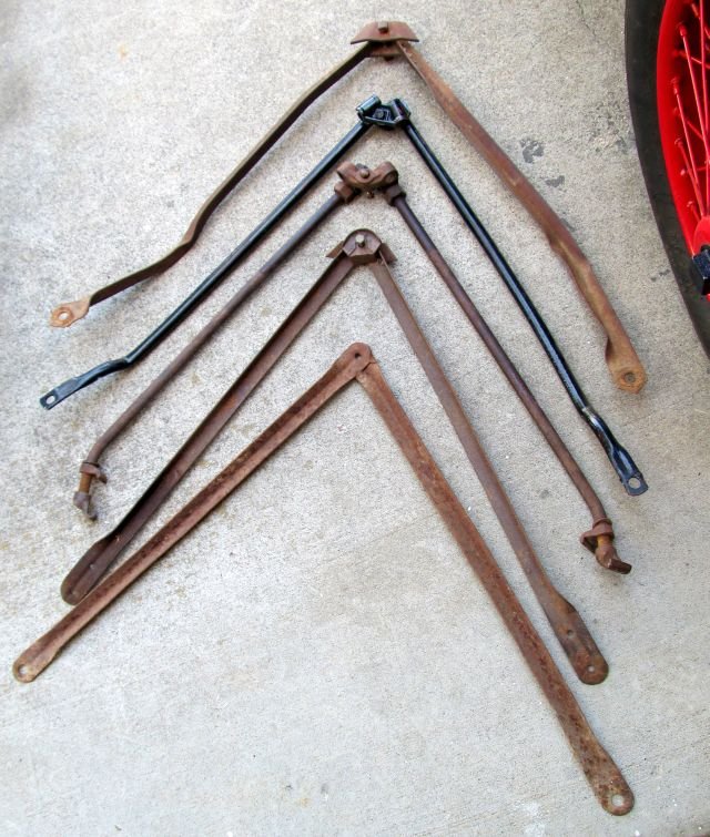

Re: EARLY WISHBONES
This shows some of the various versions. I'm sure there are many others.
http://www.mtfca.com/discus/messages/82 ... 1541109101
http://www.mtfca.com/discus/messages/17 ... 1320655814

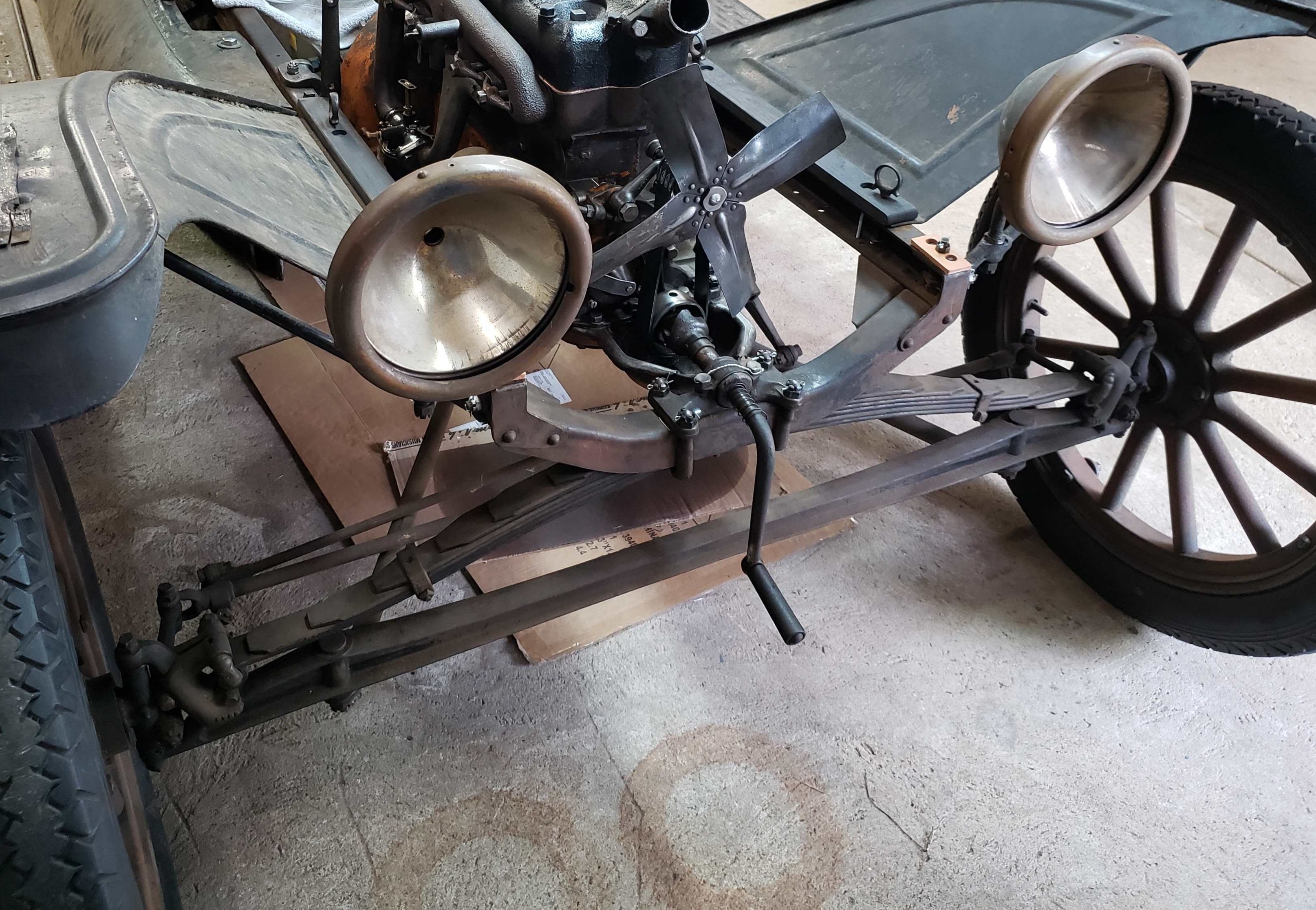

The 15 runabout that I restored had one of the old aftermarket wishbones attached to the bottom of the axle. When I was putting all the restored pieces back together last spring, I noticed that my front axle was not leaning back towards the rear of the car as much as it should have been. At first I thought I had installed the perches in the wrong side, but I double checked and knew that I had not made a mistake.
After that, I reinstalled the aftermarket bottom wishbone and then the axle had the proper 5 1/2 degree pitch towards the rear like the picture shows below. The later T's had the single wishbone attached to the bottom of the axle as Frank mentioned.

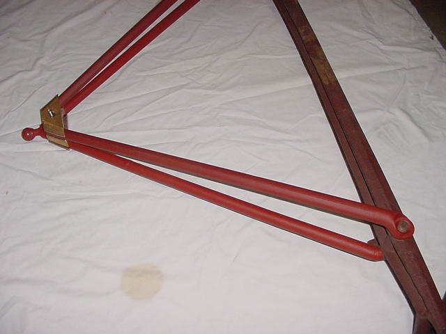

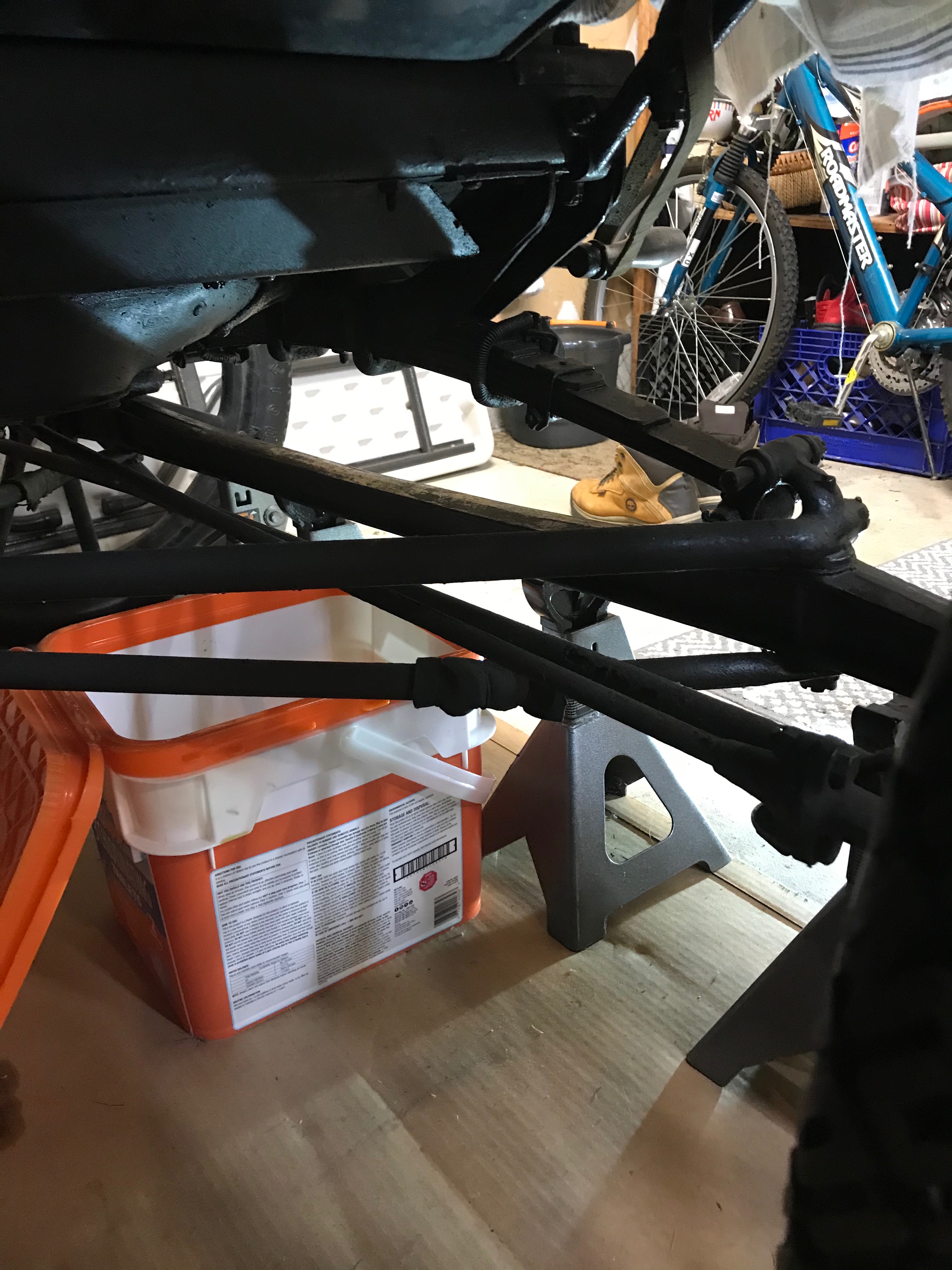

Part of the problem with a top mounted wishbone is that under some driving conditiions the axle can move in such a way as to render the car difficult to control. After Ford himself was involved in an accident (not too far from where I live) the wishbone was redesigned to attach to the bottom of the front axle starting I believe in 1919.
I added a second wishbone to my 1917 using parts I bought from <https://www.ebay.com/str/antiquetmotorsportsllc> He sells a dual wishbone clamp and the later style wishbone ends. You provide the rods.

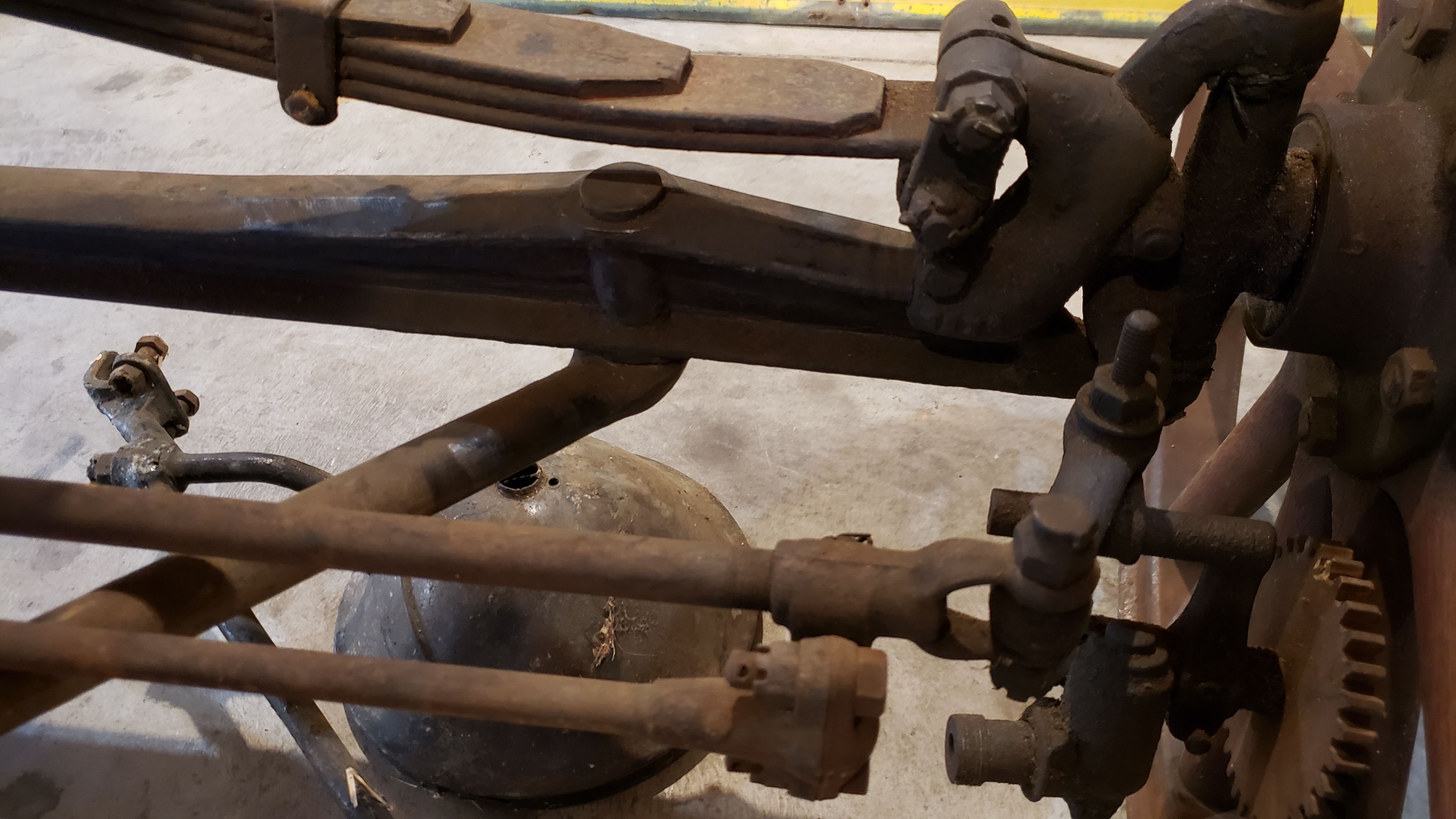

My 1915 front end has a unique solution. The spring perches are replaced with accessory posts that fit into the old perch holes on the axle and place the wishbone below the axle. The spring is then lengthened with accessory leafs and clamped to the axke ends with cast pieces..
The original issue wasn't with bones breaking, but with incorrect axle geometry with the wishbone being placed above the axle. Either doubling them up or moving the wishbone to below the axle corrects this geometry issue.

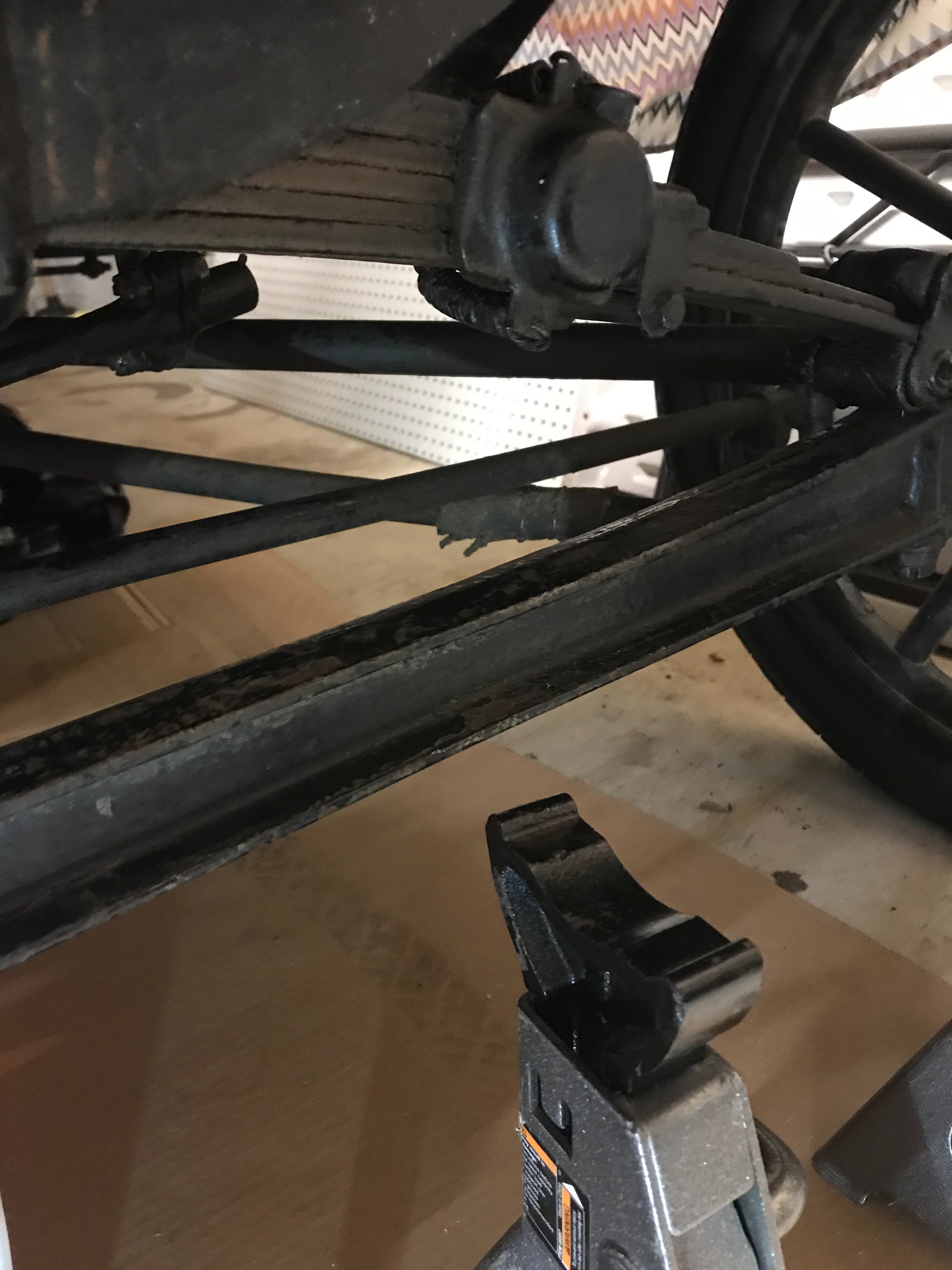

I had the same situation with my '15 Touring. Unfortunately, the local fix was to install a second "under the axle" wishbone...which does work, but the standard perch is not long enough to allow the castellated nut to screw onto the perch far enough to use the NECESSARY cotter pins.
Sure, once can grind off some "meat" off the ends of the wishbone, but the resulting thinness of the metal made me a tad uncomfortable.
My solution was to purchase this:
https://www.modeltford.com/item/2733S.aspx
I am happy with it.
Dave
I am happy with it.
Dave

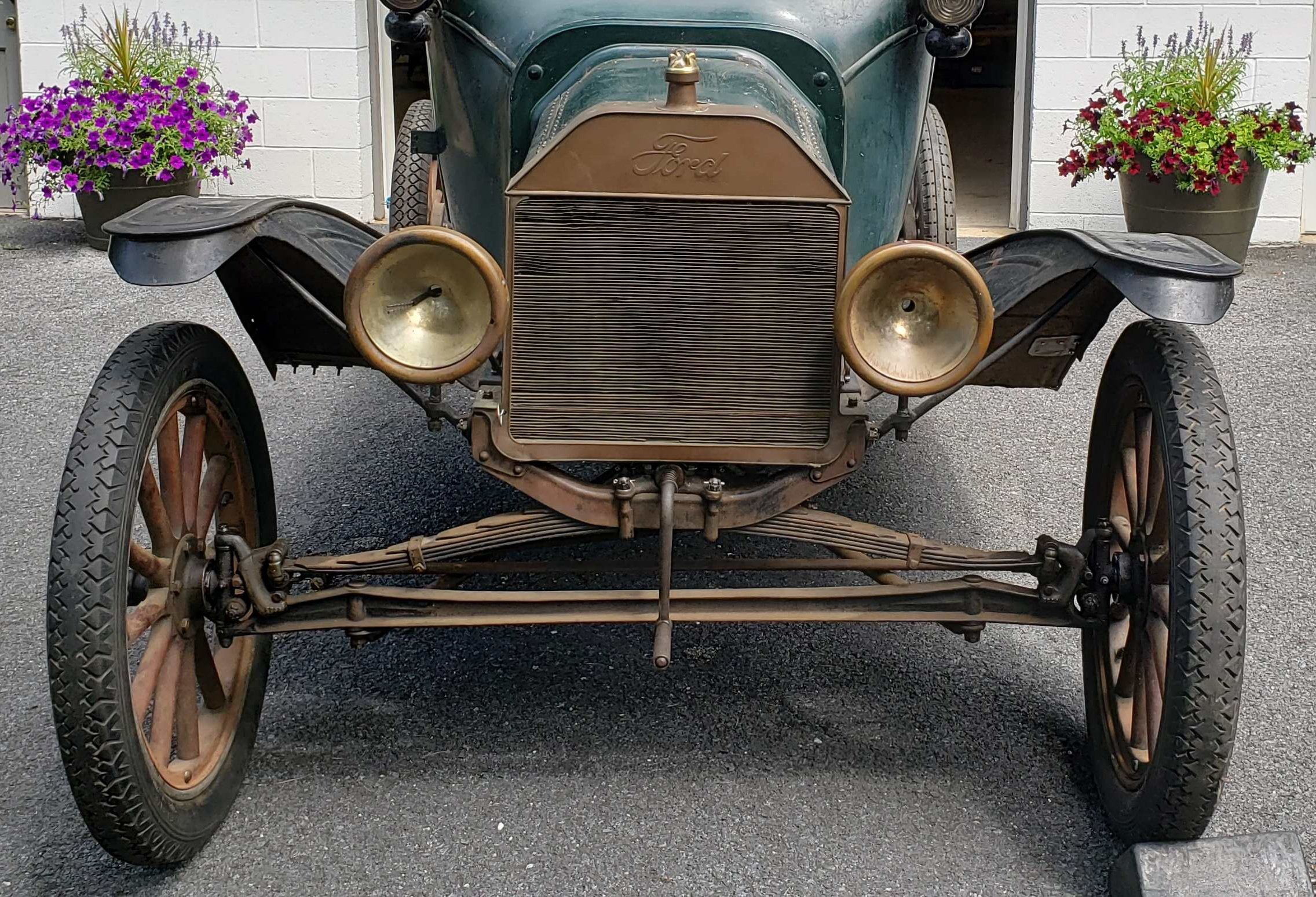

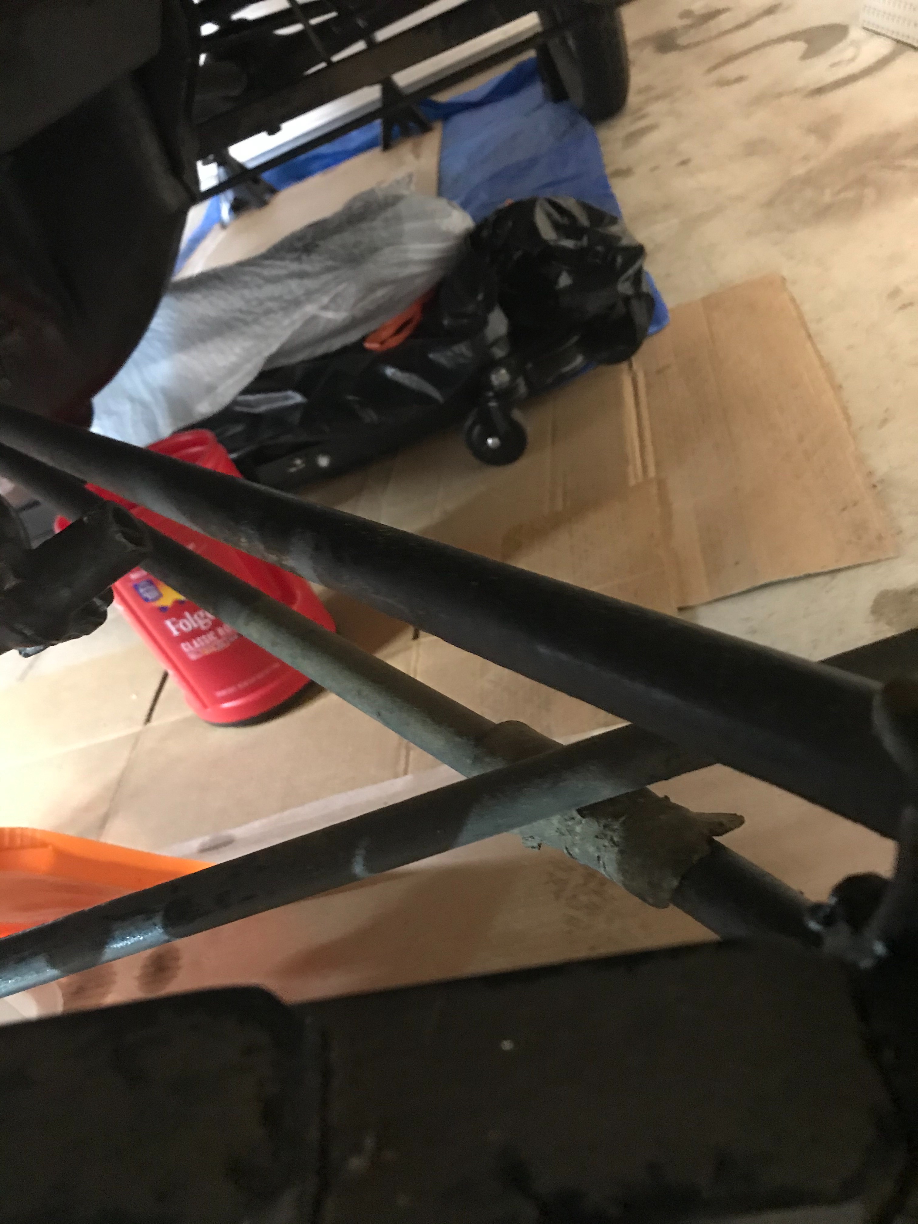

Not to hijack this thread....
Looks like my ‘13 has the additional wishbone support?
Gene
Gene
