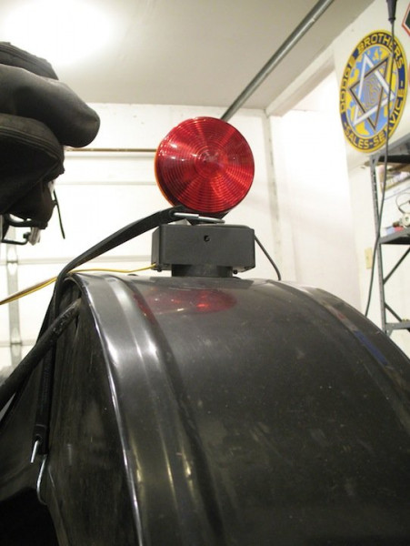

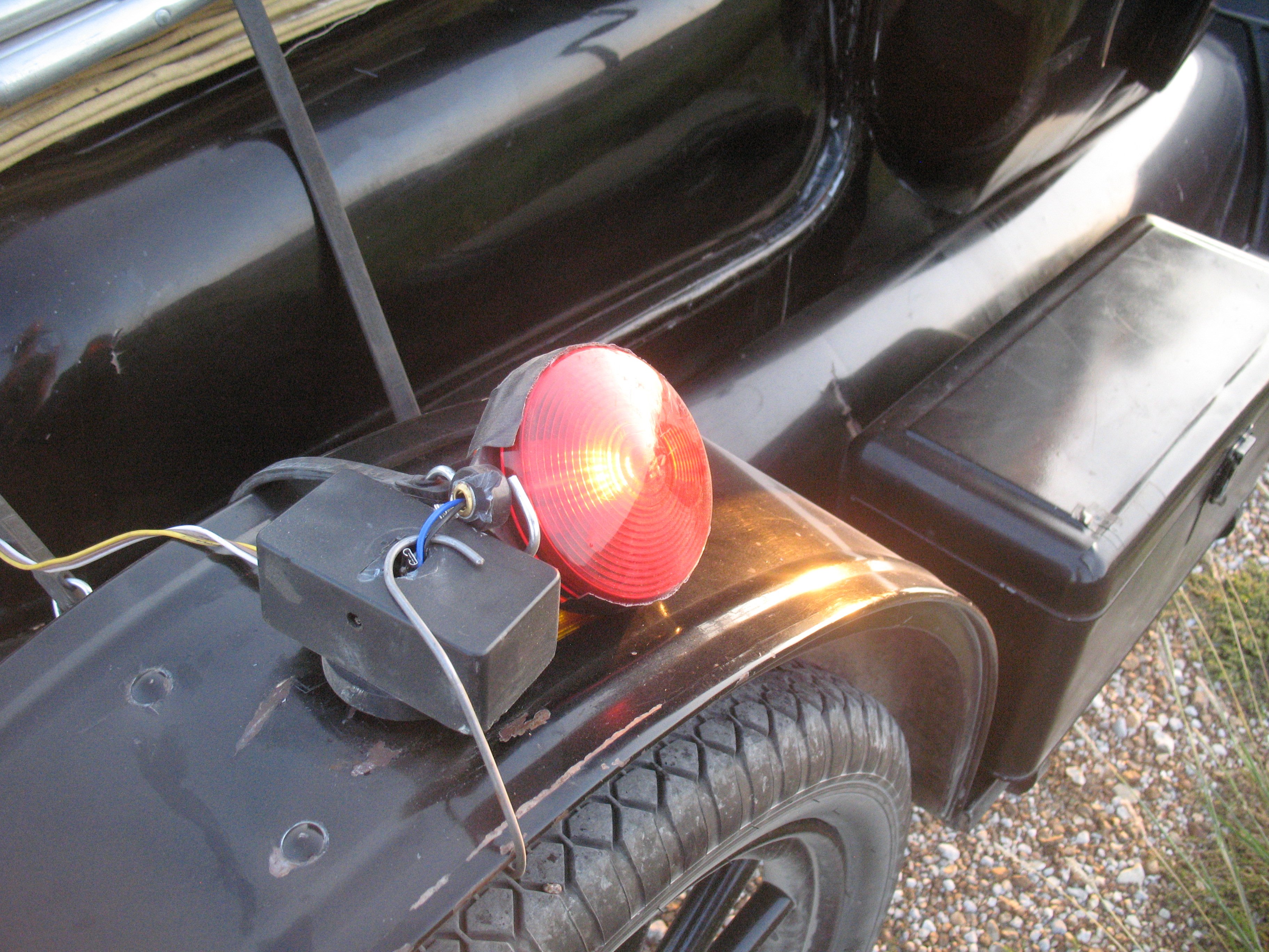

I adapted HF magnetic trailer lights and set them on my fenders. I had to use welding rod hooks and bungees to keep them from bouncing off.
Since one of them shook apart on a country road I've decided to do something else for tail lights.

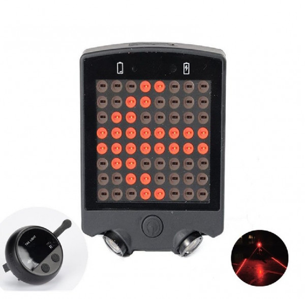

Google search came up with this inexpensive turn signal light $35 only need one (no brake light) https://nueby.com/product/bike-rear-sig ... gLw4PD_BwE
Note has laser pointer lights too pointed on the road surface
And there are many others https://www.google.com/search?q=wireles ... efox-b-1-d
