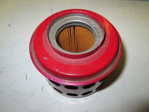

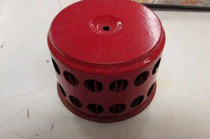

I recently removed my air filter and re-installed the stock heat pipe for winter driving, but I'll be putting the air filter back on come spring.
I found a vintage Clinton lawn mower filter on Ebay, painted it black, and made an adapter cone out of brass to attach it to the carb inlet.

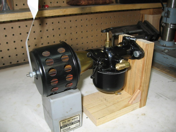

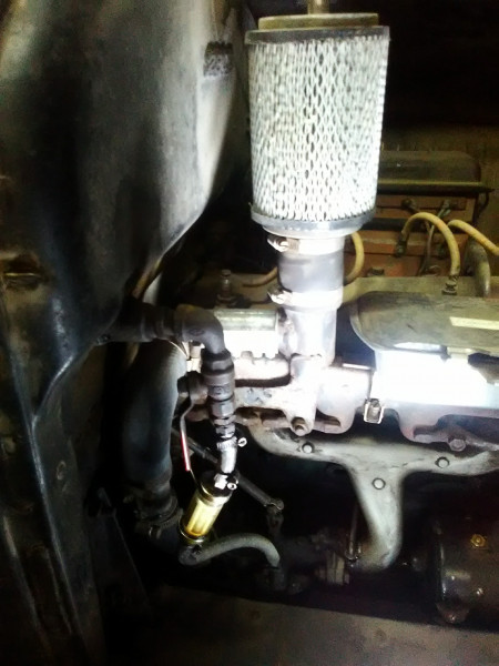

If you do it right you can have both hot and clean air.

Just wanted to warn Dennis on that clear glass fuel filter, you might want to use something else. I had one on my 68 Cougar and the O rings began to leak and caught my engine on fire. Luckily, I had a halon extinguisher handy and put it out. Just melted some wires. Swapped out that filter pronto.

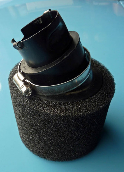

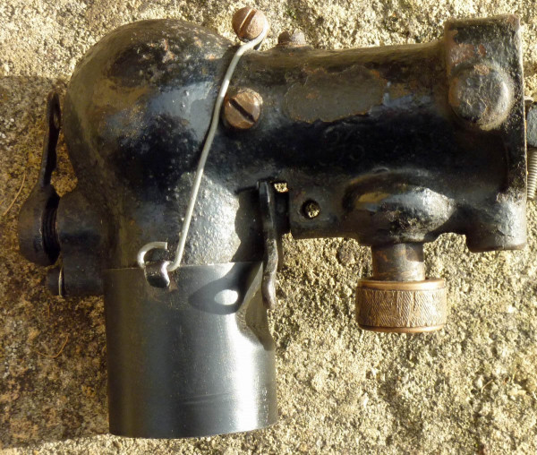

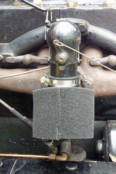

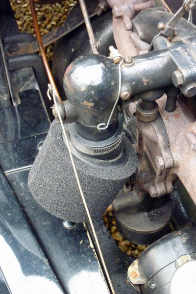

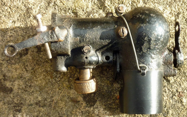

Steve,
you inspired me to sort a 'been meaning to' job.
My '26 Coupe has a Vaporizer so a different design.
I bought a dirt-bike angled filter for about $6 and I also did a bit of sheet metal work.
The tricky bit is a 'dent' on the engine side so that the choke control can operate.
No mods to the car. Doesn't seem to get hot next to the vap.
