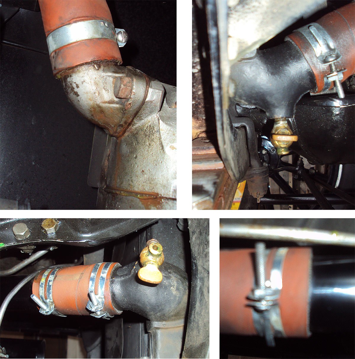

Topic author - Posts: 6895
Re: Tudor, leaks in one garage but not the other.
I went out to take a picture only to find the camera battery dead. It may be in cahoots with the Tudor. It is charging now. I didn't look during the two weeks so I don't know how long the leak takes. It could be coolant that is in the overflow tube after a drive that takes a while to run down and out but the puddle seems larger than that.
I appreciate the ideas. The antifreeze artesian well deserves scrutiny. I have no idea what is under the floor. When they tried to break up the old concrete in the driveway they found a complete bed frame with springs used as rebar. their normal destruction methods didn't work well for it.
I'll get pictures later.

After you park the car for two weeks and you see a puddle under it, how is the coolant level in the radiator? It should be about half way down the top tank or about level with the Ford emblem. If it has not dropped so low you have to add coolant, just put something under the car to catch the drip and stop worrying about it. Just remember to check the coolant before you start it the next time you want to go for a drive.
Let me reiterate that my sole purpose in mentioning this was to note the oddity of the car responding differently in different locations. I have become proficient in stopping leaks for 56 years. However driving the cars always changes the dynamics. I did clean and reseat two drain petcocks this fall and tightened a dozen hose clamps. I can't always remember which car.
After taking these photos I see several problem areas and will return the car to the shop.
The first photo shows the car parked back slightly from where the leak first occurred. It also shows which way the floor slopes. The second photo shows drips at the upper and lower hoses. The antifreeze at the bottom of the water jacket probably came from the hose, not a crack but I will check there. Taking photos works better that trying to look to see. Thanks for the suggestions.
I expect Perry Kete to inform me that it is the front tire that is really leaking antifreeze.

- Posts: 4661
That's a bigger puddle than I thought I would see. From looking at the pictures, it looks like the upper hose leaks at the bottom end. You can see from the rust stains, that it has been going on for a while. It looks to me that the clamp is quite high on the hose. If you remove the hose, you might find that the fitting is rusted toward the end where the hose is clamped. It is possible there could be a hole rusted clear through maybe hidden by the hose, but below where the clamp is located.
I would suggest that you remove the hose, and clean up the fitting as well as you can, looking for deep rust pits or possibly the ridge at the top of the fitting is rusted where it is clamped under the hose, leaving a groove where the coolant can leak through even when you clamp down. Perhaps you can smear some ultra black in the area and let it set up about 15 minutes, trying to cover any holes or pits in the metal. Then install the hose again and place the clamp lower on the hose and preferably over the area which was smeared. Then let the ultra black dry for about 24 hours before you fill again.
If that doesn't fix your problem, then I was wrong and the leak is somewhere else.
That's coolant (as we all know). I have an issue with my repop rediator leaking from the radiator inlet (top hose) and am planning on pulling and (hopefully) repaiting it.... but I still think there's other forces afoot. I'm consulting my 100 year old Tarot deck, but all it seems to tell me is (a) I need to get my hair bobbed, (b) practice your charleston before the next dance marathon, and (c) get a horse. No help. I think I'll go back to casting spokes and reading T spring leaves...
