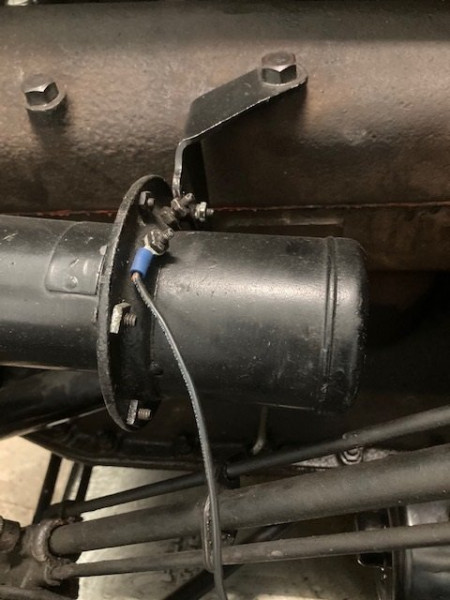

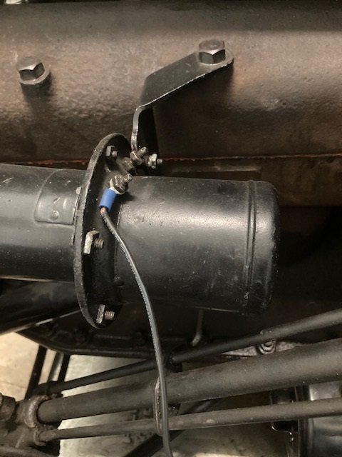

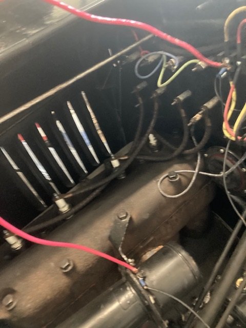

Here are some photos. If I use a larger gauge wire (red one in the photo) and directly jump it to the terminal block it works fine sounds strong. Using the switch it is weak. If I 'revive' it using the larger gauge wire it is better for a few toots on the switch but then goes back to being weak.

Clean to bare metal on each side of the head bolt and the bracket to get really good ground. Or install a second ground wire. Just a thought. Frank

A screw was loose on the back side of the wire hookup. I tightened it up and it works a lot better now, thanks all!
