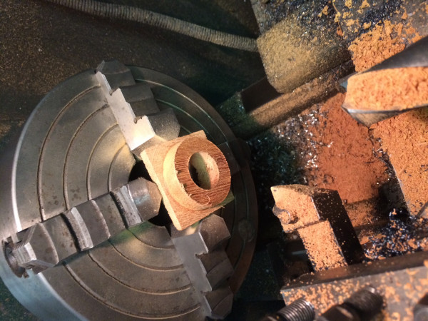

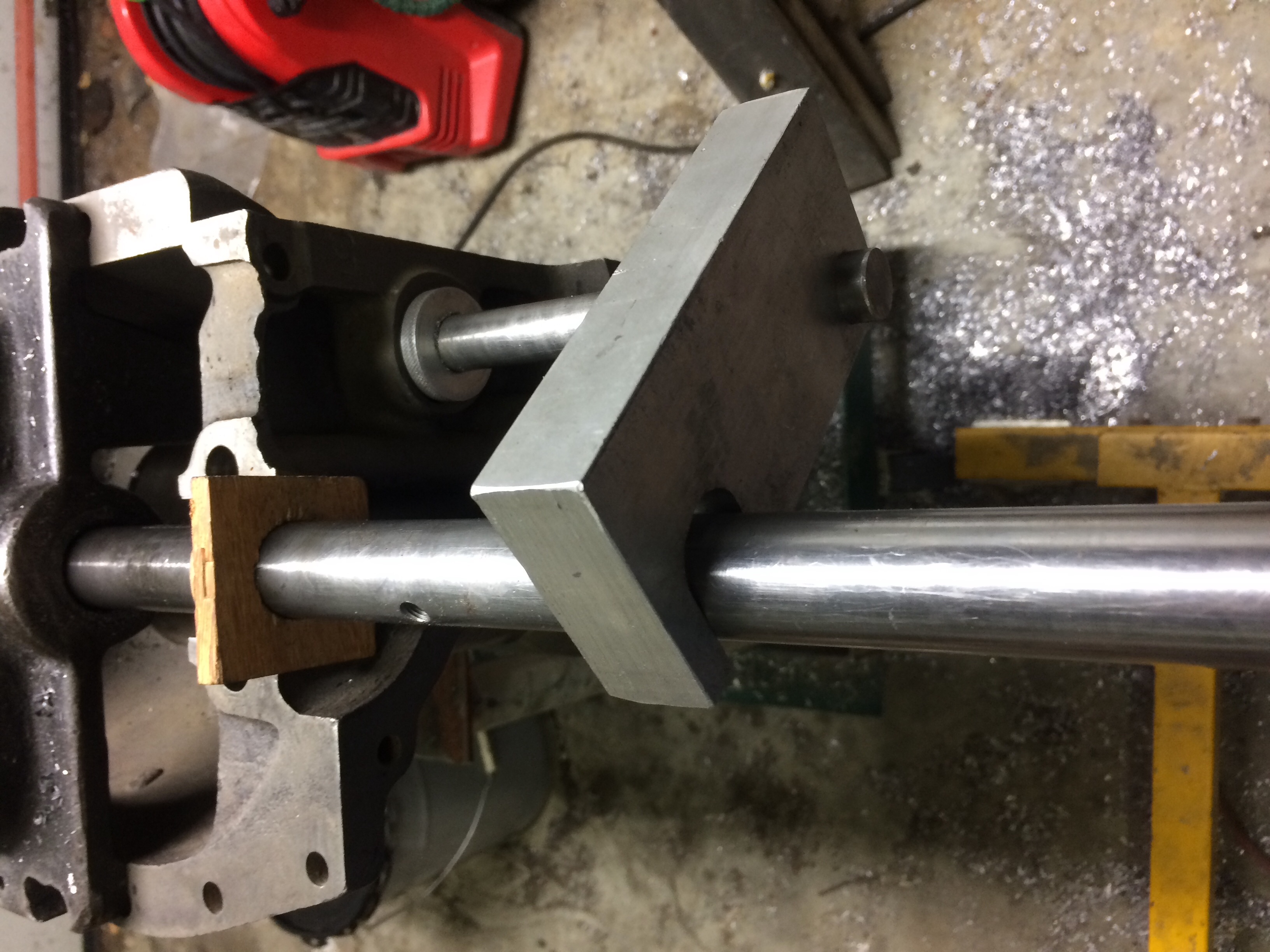

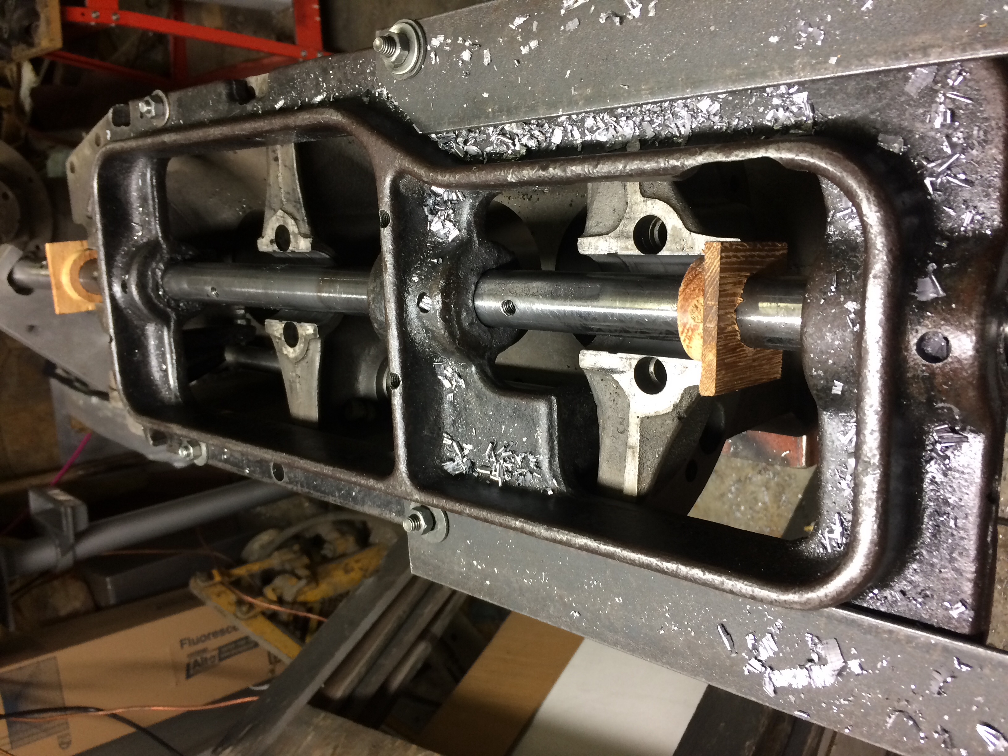

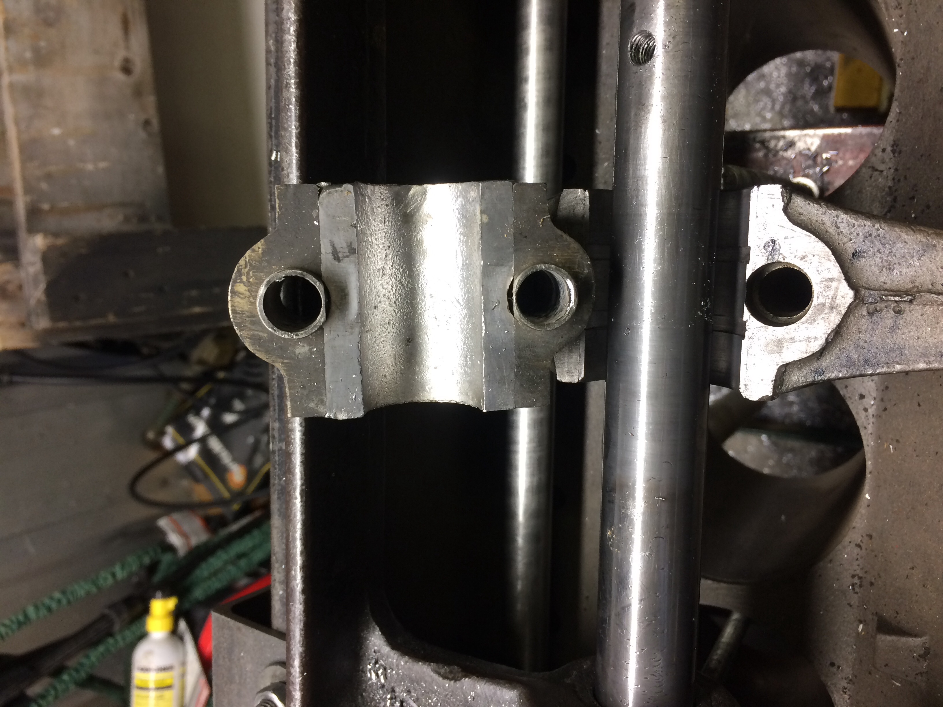

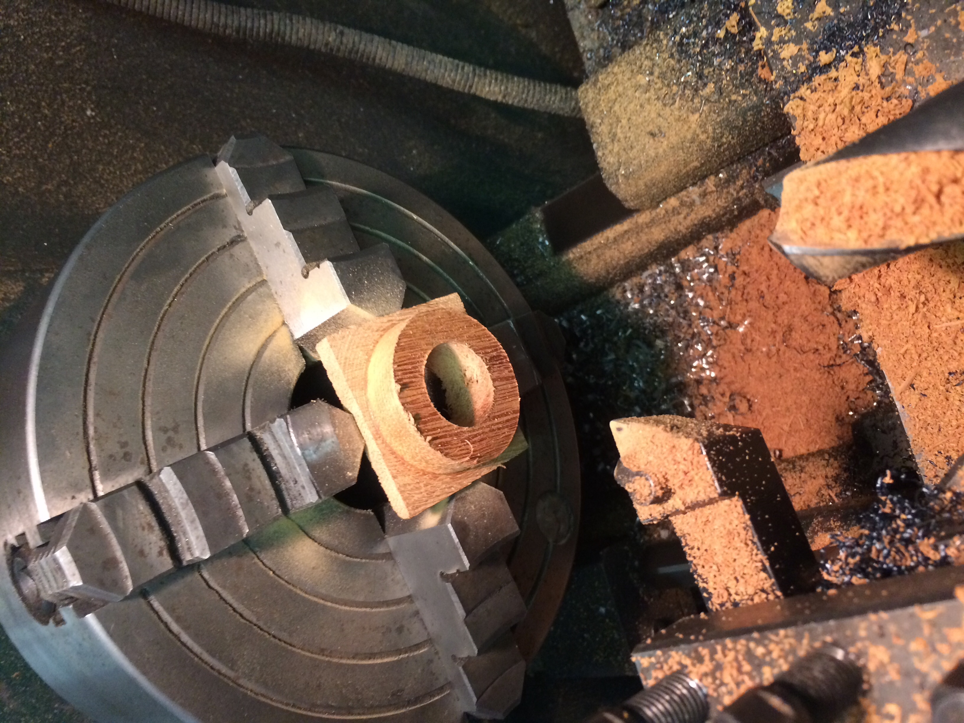

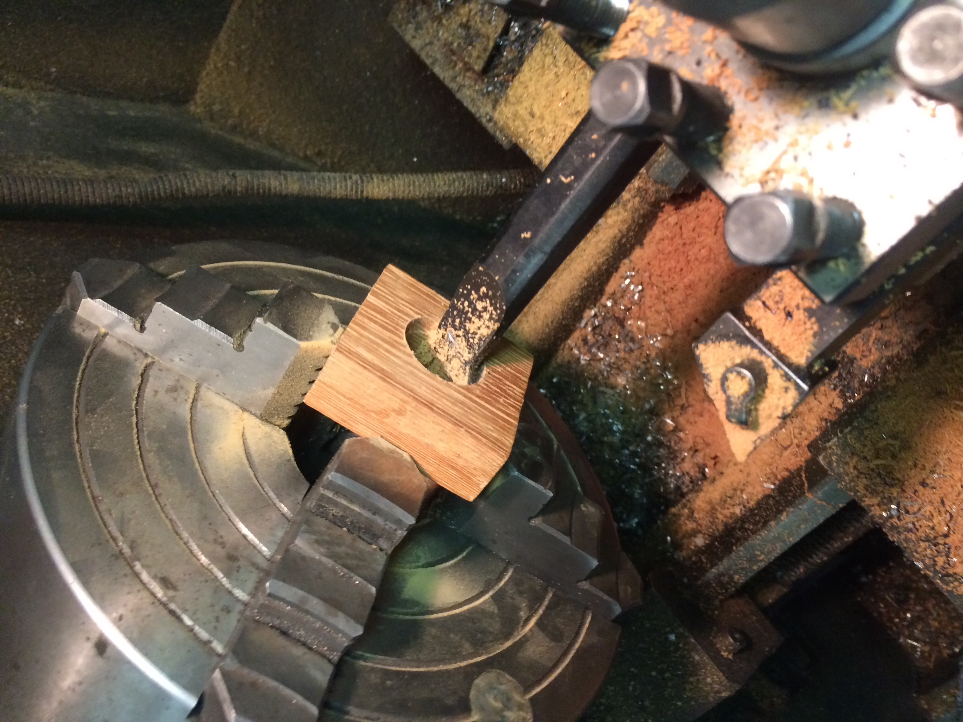

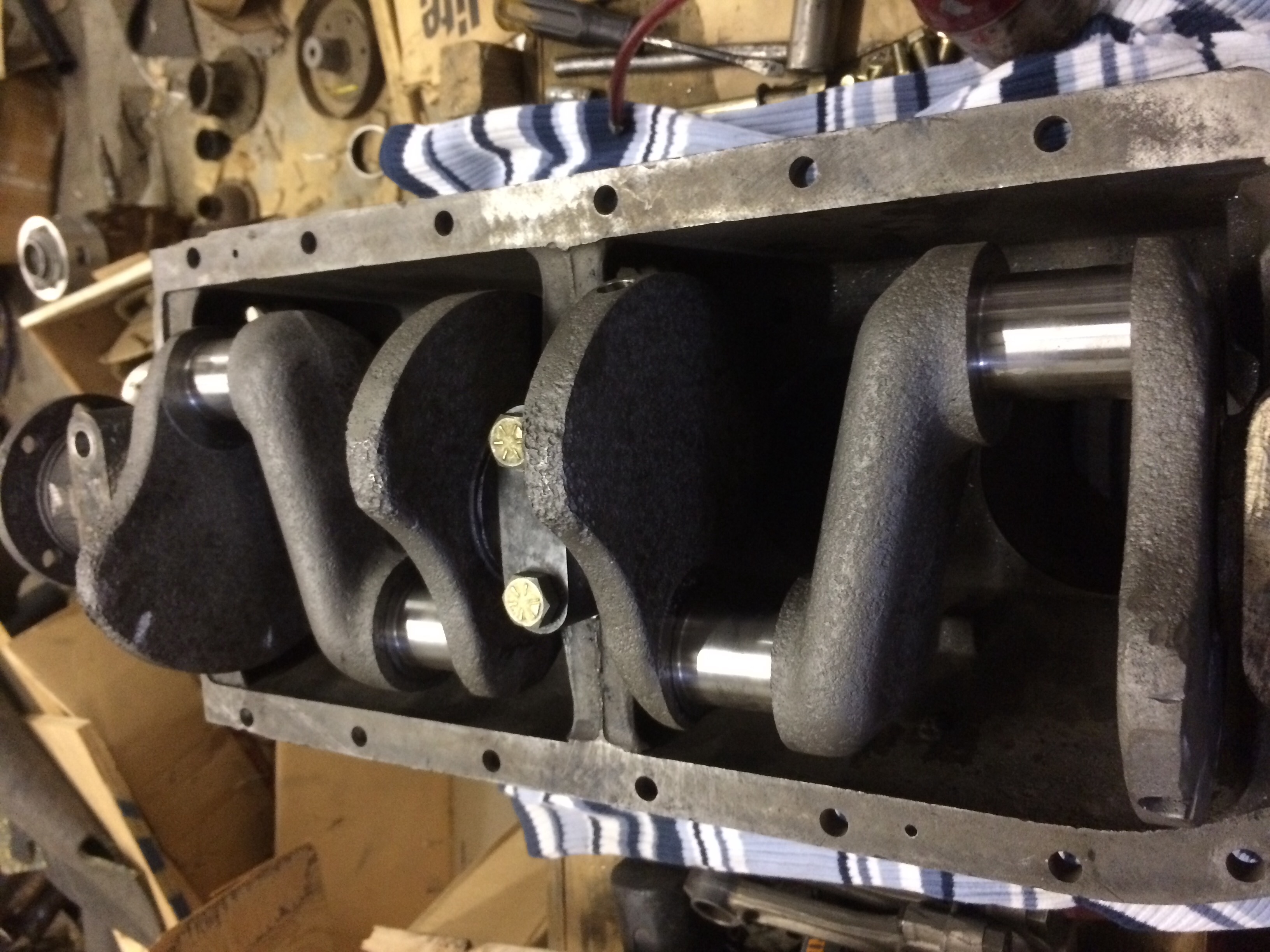

It is inevitable that when line boring blocks that you will have a “gosh dang” experience. And you end up with one bearing that needs to be “fixed”!!
So I had a centre main cap that I was not happy with the adherence of the babbit. I have 5 good surfaces and 1 that I decided to redo.
So now the struggle is how to realign everything.
I had a moment of inspiration and mentioned it to a friend and he said he had successfully used the same concept.
So here are some pictures of the process this morning. This engine has a “C” crank cut to standard A size and full pressure.

i have bored the babbitt lined inserts of the 5 mainbearing Dodge Brothers 4 cyl. engines by placing bronze bushings in the #2 and #4 mainbearing saddle in the block and the inserts in the center mainbearing saddle ... worked great ... always an optimist ...Gene French

So got the line boring done today. Re aligned within about.001”!!
