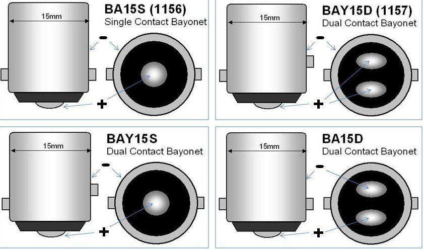

The Pro's & Con's of LED Bulbs have been discussed numerous times. This link covers several LED bulb designs and results
https://mtfca.com/phpBB3/viewtopic.php? ... ed#p124082
The base of the Model T "headlight" bulb has lugs that are 180 degrees opposite one another. These lugs match 1156 bulbs manufactured Today which are used as single filament taillight bulbs not dual filament. 1157 bulbs are the dual filament bulbs used for brake/turn/taillights and have lugs one lug higher than the other that are also 180 degrees apart. If one was to use 1157 bulbs in a stock Model T socket the high lug needs to be removed. Another consideration is if you power your lights by magneto vs generator/battery. What should be pointed out is that these bulbs, LED or incandescent, are not really "headlight" bulbs but brake/turn/taillight bulbs; still brighter that the originals and use much less amperage.

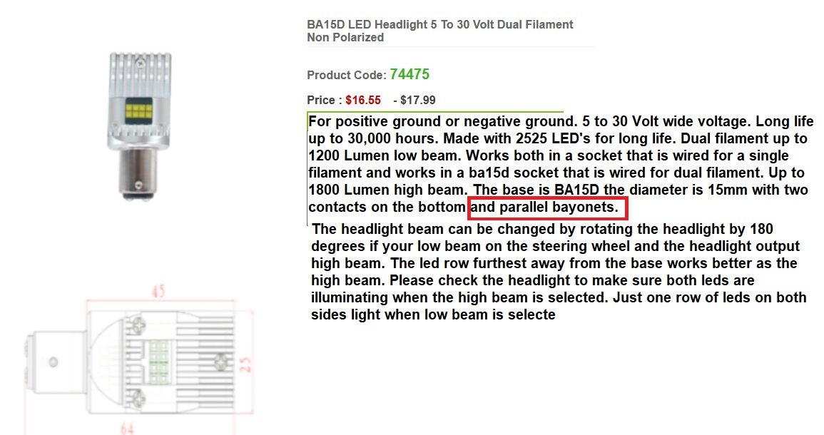

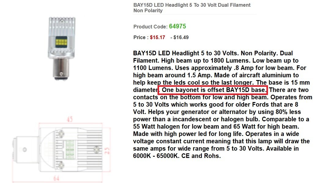

Be careful what you order. The Model T headlight sockets are designed for parallel pins (like today's taillight bulbs).
https://www.ledlight.com/led-headlights-6-volt.aspx
LEDLIGHT.COM offers two almost identical led bulbs - note the difference and choose wisely
