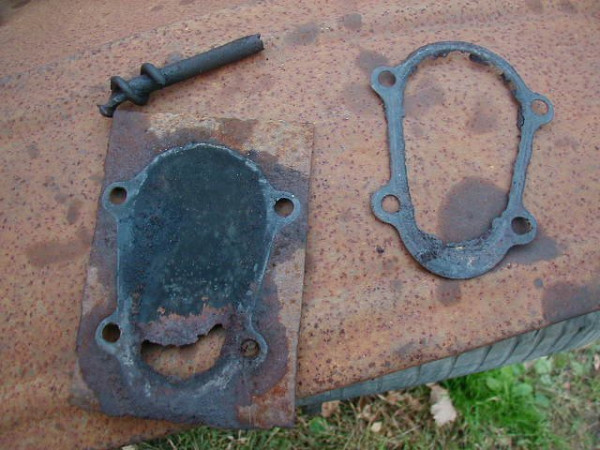

That poor old maligned vapo-rub carb. Usually very misunderstood and I'm no rocket scientist.
Get the 6273 vaporizer plate and maybe a new 6276 primary air tube if it's not perfect. How's that little 6277 heater coil around the tube?
I didn't see the little screw that passes thru the outlet pipe in the upper section and wrecked that. $25 dollars in parts.
Shipping was more than the parts. You perhaps have some high temp sili-sealant already so lightly goop up any spot that could leak air.
I even put a little around the primary air tube where it enters the bowl section and the upper section.
On a tired, far from perfect engine in my late TT with a burned out starter, three choked pulls on the crank and away it went.
Open the throttle a bit more than you might otherwise with an NH.
You folks "think" these carbs are junk? The Holley Brothers Kerosene "mixer" for OT engines have been likened to "a beer can with holes punched in it" and are far more difficult to deal with but the same notion exists there also. NO air leaks.
A shot of the well used, home made vap plate that I found on this truck. At least it was smiling!
Holler if you need any help. :)
