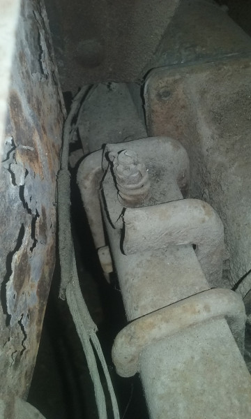

Helping install an engine in a '20 TT truck and ran into a couple of problems. Do the rear motor mount ears go over the top frame rail? and if so, then the 2 side bolts do not line up. If the rear mount ears go inside the frame rails, how high are the blocks for the ears to sit on? Also, is there a difference in oil pans between car and truck with reference to the height of the rear mount ears. And lastly, is there a difference in height for the shoe on the e-brake shaft between car and truck? Thank you for any insight you can provide.

I checked my unrestored 1924 TT and the engine pan ears are mounted to the top of the frame with a wood block and side bolt like the car, but the top bolt has a spring, castle nut, and cotter pin, similar to the radiator mounting.

thank you all for your informative replies. Of the 6 TT frames I have recently checked, 3 of them have the e-brake shaft still installed with the top of the neutral shoe 3" from the edge of the shaft. These look to be original fitment as the bolts holding it together still have the split pins installed albeit very rusty. the other frames do not have the e-brake shaft. All of the frames have only one hole in the side where the pan ear sets, which is 2 1/2 " from the top of the frame. On all 6 frames the horizontal bolts for the pan ears are 1" lower from the top of the frame compared to the car frame, so they would not fit. (ref: picture shown above). Could this be a difference between Canadian and American produced trucks? Also, regarding the front crossmember, all are original truck crossmembers.
