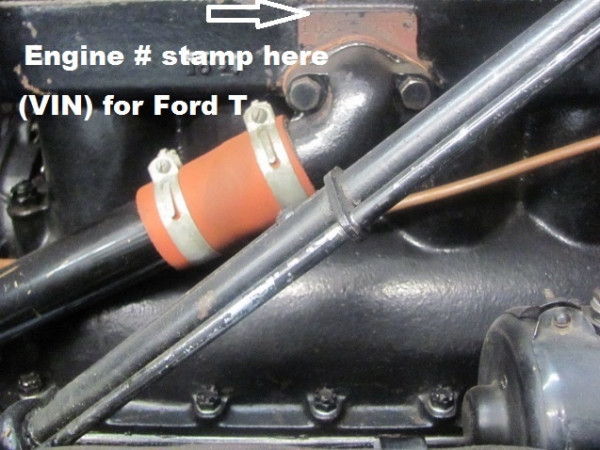

Have a new to me 1924 Touring. What and where are numbers used for VIN located and how many digits ?
Posts: 7413
Re: VIN #
Post by Steve Jelf » Wed Dec 02, 2020 11:53 pm
The only VIN is the engine serial number stamped above the water inlet. In the mid-twenties it should be eight digits. If you don't have the encyclopedia yet I can look it up for you and get the exact date.

Post by DanTreace » Thu Dec 03, 2020 9:46 am
Location of engine number or "VIN" for the Model T Ford.
