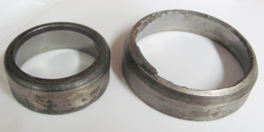

I took some old races and ground a little off the outside so I could use them to tap the others in without getting them stuck. I turn them upside down and tap on the flat. Works like a charm!

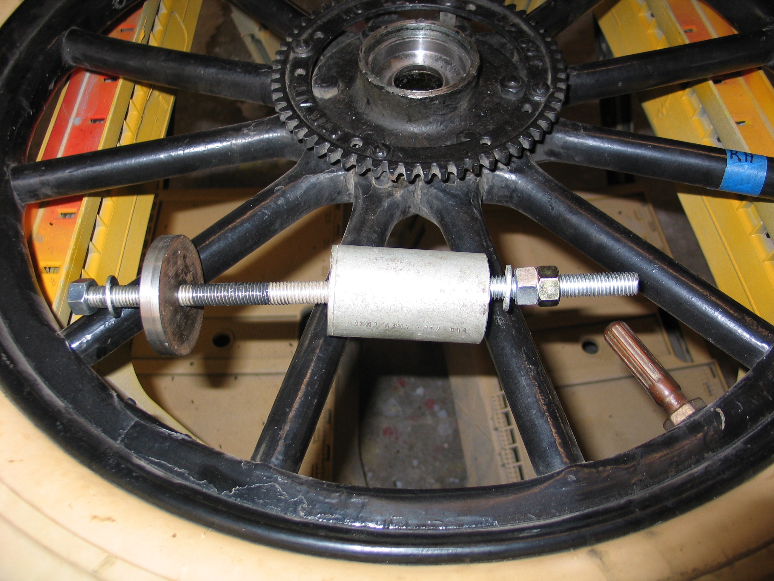

Here's a picture of my "tool". It's just a piece of fairly thick wall aluminum tubing and a length of all-thread rod. And a couple large area washers. The Ford tool would have been better, but I used what I had.
I've read that there are some combinations of thin walled hubs and slightly oversize bearing cups that are so tight that the the hub nose cracks when the cup is pressed in. Perhaps somebody more knoledgeable can explain that hazard in more detail.

So just like Tim Juhl posted, I have a set of old races ground down in outer diameter to insert the new races in a hub. Works the best
And use a brass hammer to tap around on the old race "drivers" to seat the new ones.
