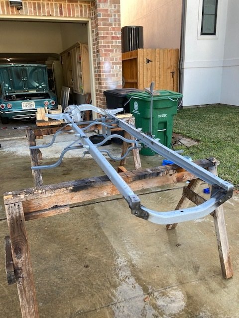

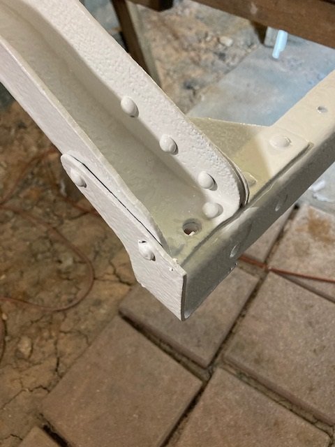

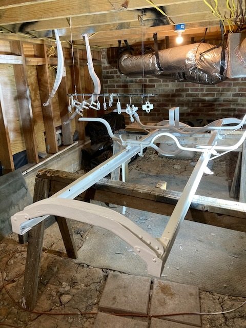

Well, here it is sort-of. Cleaned up after riveting, primed the remaining rivet burn spots and the first coat of tractor paint is brushed on. The good: it is the chassis so it won't be seen much and some parts not at all. Brushing on is historically accurate. Brushing doesn't get on the neighbors nice cars and can get into some tight spots. The bad: lots of brush marks, lots of runs, the grey primer shows through in places but it is the first coat. I think I will try to spray it on for the second coat. I wonder what the most efficient way to fix the runs and maybe sand it more smooth?

Post by Rich Bingham » Sun Dec 27, 2020 11:31 am
ivaldes1 wrote:
Sat Dec 26, 2020 8:39 pm
. . . The bad: lots of brush marks, lots of runs, the grey primer shows through in places . . .
Not to beat you up or be a smart-alec, Nacho, but regardless the method of application, the paint needs to be the proper viscosity to handle well, flow out, and "set" with an optimal "open time" before drying to a dust-free tack. This is accomplished by using the correct reducer and sometimes amendments that improve flow or drying. This requires a certain amount of judgment and experimentation. Then there are brushes. Size, shape and hair type all figure in. Alas, nowadays good brushes are expensive and hard to find. Bottom line, painting is a skill that takes some time to master to get good results. The good news is, it's just another opportunity to learn and gain yet another skill, along the path that restorations take us ! Sometimes frustrating, always rewarding !

Post by dmdeaton » Sun Dec 27, 2020 2:47 pm
Hit the runs with a little sandpaper on a block if they bother you and hit it with your second coat. Like said above, viscosity or how thin it is means everything. You can get by without expensive brushes, although they help a lot. You will be surprised how good your second coat will look. Temperature makes a difference also.
You are painting white in which your first coat will not cover well brushing. I think you will be happy with the next coat

Post by John kuehn » Mon Dec 28, 2020 10:06 am
Have to agree that doing a brush on paint job can turn out pretty smooth if your careful with the application. It takes a little practice just as it does with a spray gun.
The right paint consistency helps when brushing it on. It’s up to you of course but I would do what the poster said and smooth out the bad runs and apply another smooth coat.

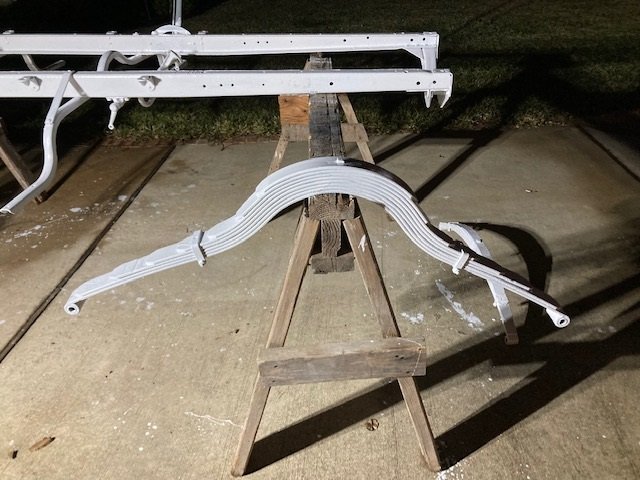

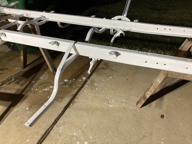

Post by ivaldes1 » Wed Dec 30, 2020 1:06 am
Thank you for the comments. Santa brought me a spray gun kit for Christmas. I had to cut the Farm and Implement paint a lot like 40% with acetone to get it to spray well enough. The result so far is much better.
