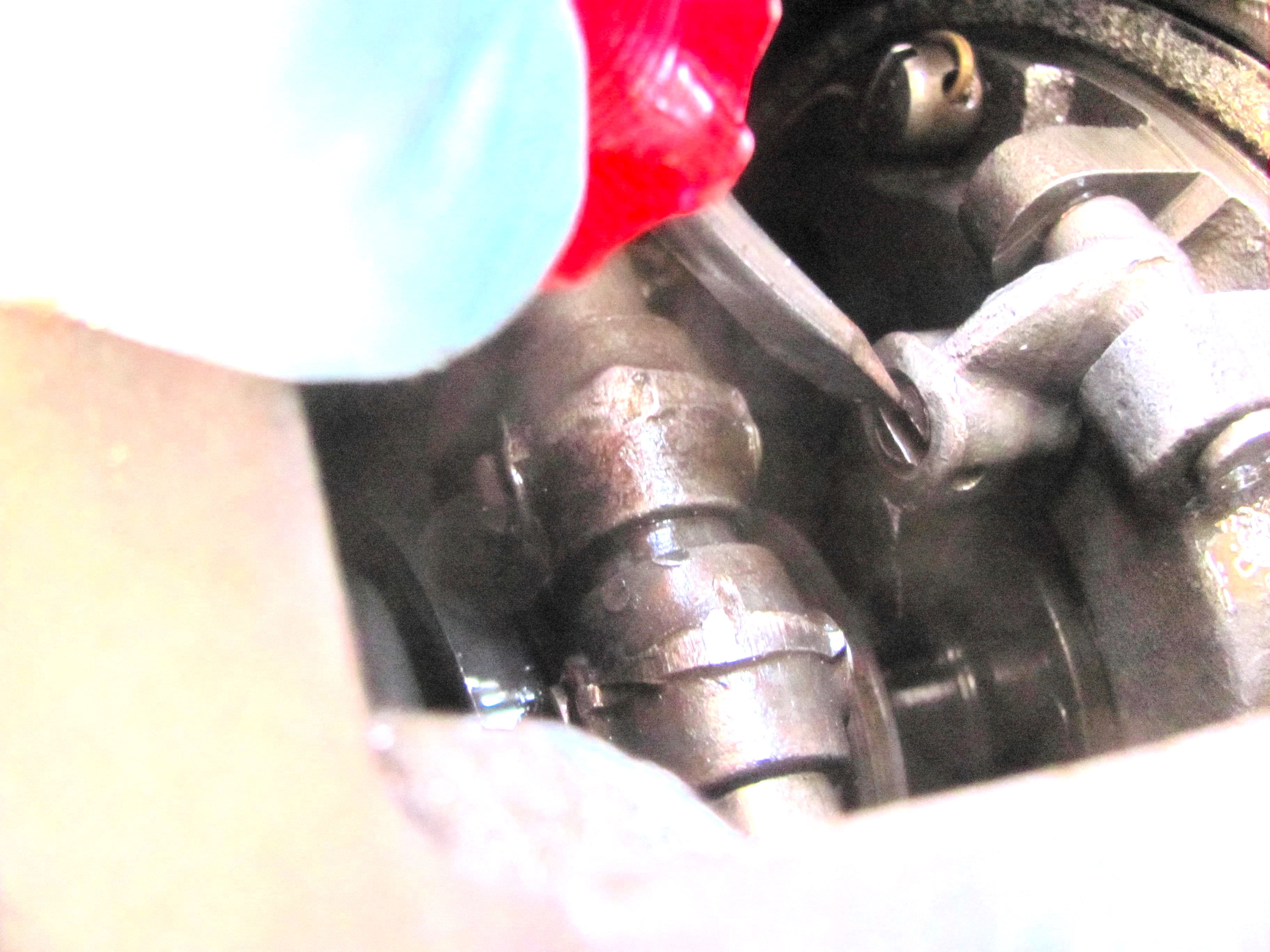

I was going to adjust the three clutch screws in the transmission. I jacked up the left rear wheel and placed the tranny in neutral. With the transmission in neutral the rear wheel will not turn. The parking brake is definitely not set. It doesn't make any difference what position the lever is in the wheel won't turn. Should it?

Push the hand brake / clutch lever forward, that will make the wheel turn when you hand crank.

I do understand that Dan, The issue is that there is a tremendous amount of drag on the engine when cranking in neutral. In fact I cannot hand crank it, and I have hand-cranked many other Ts. With the lever in neutral I can turn the raised wheel with some serious effort. With the plugs out and the wheel jacked up in neutral the engine will hand crank just fine. What I'm really looking for is this: do you think I'm on the right track adjusting the clutch screws. I don't want to pull those cotter pins unless I have to. I have nightmares about dropping one.

Most times when adj. the clutch in a starter T, its easy to just push with the palm on the foot starter button. I leave the T on a level clear driveway, as it will roll forward that way. Just a few pushes to roll the motor over to present the next lever screw. The handbrake/clutch lever forward so that the drums revolve with the driving plate the fingers are mounted on.

Maybe start by jacking up both sides, remove the parking brake rods and see how both wheels turn. If one or both feel like they are dragging then pull the wheel(s) and have a look see. Reattach the rods and check again, adjust as needed. Then check the bands to make sure they are not dragging. If the bands or parking brakes are not dragging then it could be the clutch pack. Tabs/bosses in the brake drum could have grooves worn in them not allowing the disks to release.
Something is dragging someplace. Even with just one wheel off the ground, parking brake lever horizontal or all the way forward, should not be hard to crank. With a good engine, stiff maybe, but not hard.

Without making any adjustments; trans cover and key off, parking brake lever in just the upright position. What do the drums do when you hit the starter? What does the car do? Really wants to roll or sorta wants to roll?
With the parking brake lever pulled back or in upright position, are the 3 clutch fingers loose? Can you freely move them in and out? If they don't, ether the adjusting screws are turned in too far or you need to adjust the linkage and bolt that rides on the cam for free neutral.
Turning the adjusting screws in increases pressure when the clutch is released, turning out decreases pressure when clutch is released. If the engine has not been rebuilt and rods not taken up lately, that should rule the engine itself out.
