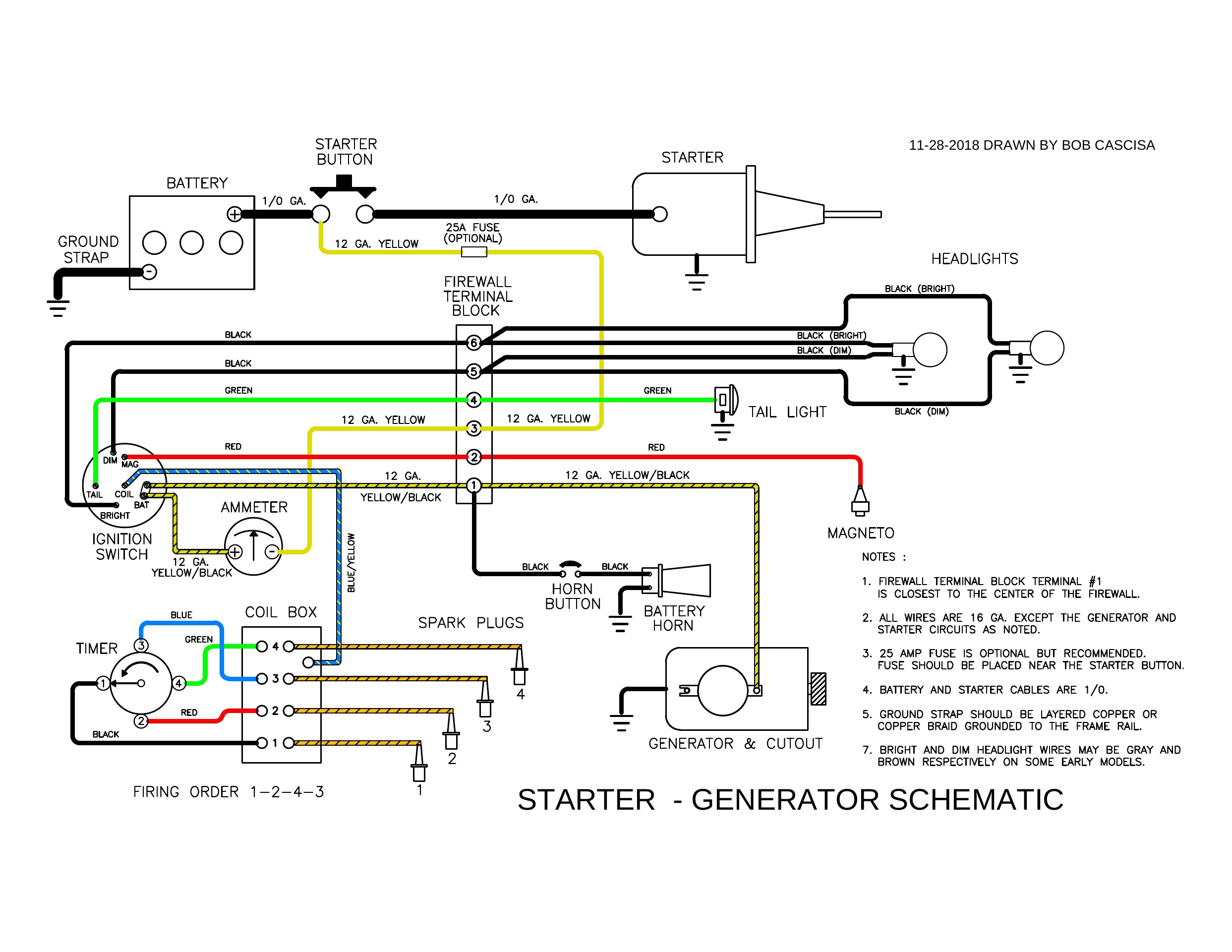

Thanks, Dan. I tried the horn not only on my '24 Coupe, also recently on my friend's Coupe, both with new "Z" heads. Same results = low volume. The horn is now on my friend's car for the winter. In the spring, I'll check your two suggestions.

Do you use a horn relay? What size wire are using to feed (+) to the horn?

The color-coded wire to the horn is part of the wire loom purchased for the '24 Coupe. It's the same size as the other wires in the harness, so it must be correct.
What kind of relay would I need to purchase to boost the volume? Brand name? Store? Part number?

So, suggestions to boost the volume, please? How will a relay help?
