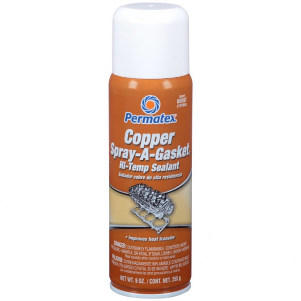

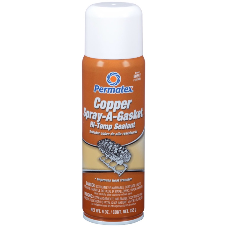

In an effort to mill off as little material as possible from the head and block, would it be okay to leave minor imperfections, as long as they could be sealed with Permatex Copper Spray gasket? Jim Patrick

Jim, your suggestion is quite reasonable, unless the imperfections are in the lip on the outboard side of the two large water galleries at each end of the block. These need to be spot on, just as they do on the cylinder head.

With an engine out of the car and being resurfaced anyway, an imperfection that still requires "sealing" by any other means than the head gasket, needs to be addressed, (i.e. removed). Besides, if you're decking a block or head, and you have a "minor imperfection", chances are, taking another .005" off will get rid of it and be no big deal. Copper coating is no replacement for a good head gasket and two good seal faces. Not to say that Copper Coat isn't worth using however. I always use it.jiminbartow wrote: ↑Wed Jan 20, 2021 1:35 amIn an effort to mill off as little material as possible from the head and block, would it be okay to leave minor imperfections, as long as they could be sealed with Permatex Copper Spray gasket? Jim Patrick
