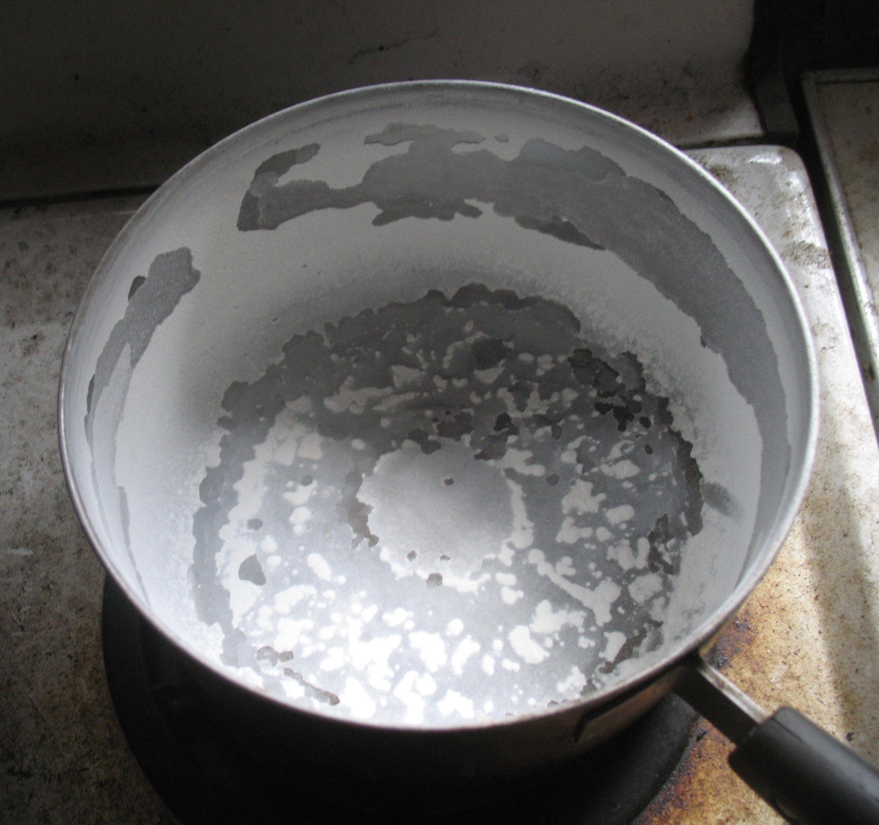

I boil tap water for my morning tea in this pan. I haven't de-mineralized it for a couple of weeks. This is why I use distilled water in my vehicles. As Jerry says, mineral content varies all over the country. If I'm traveling I don't know what's in the local water, so I use distilled water when I'm on the road too.
